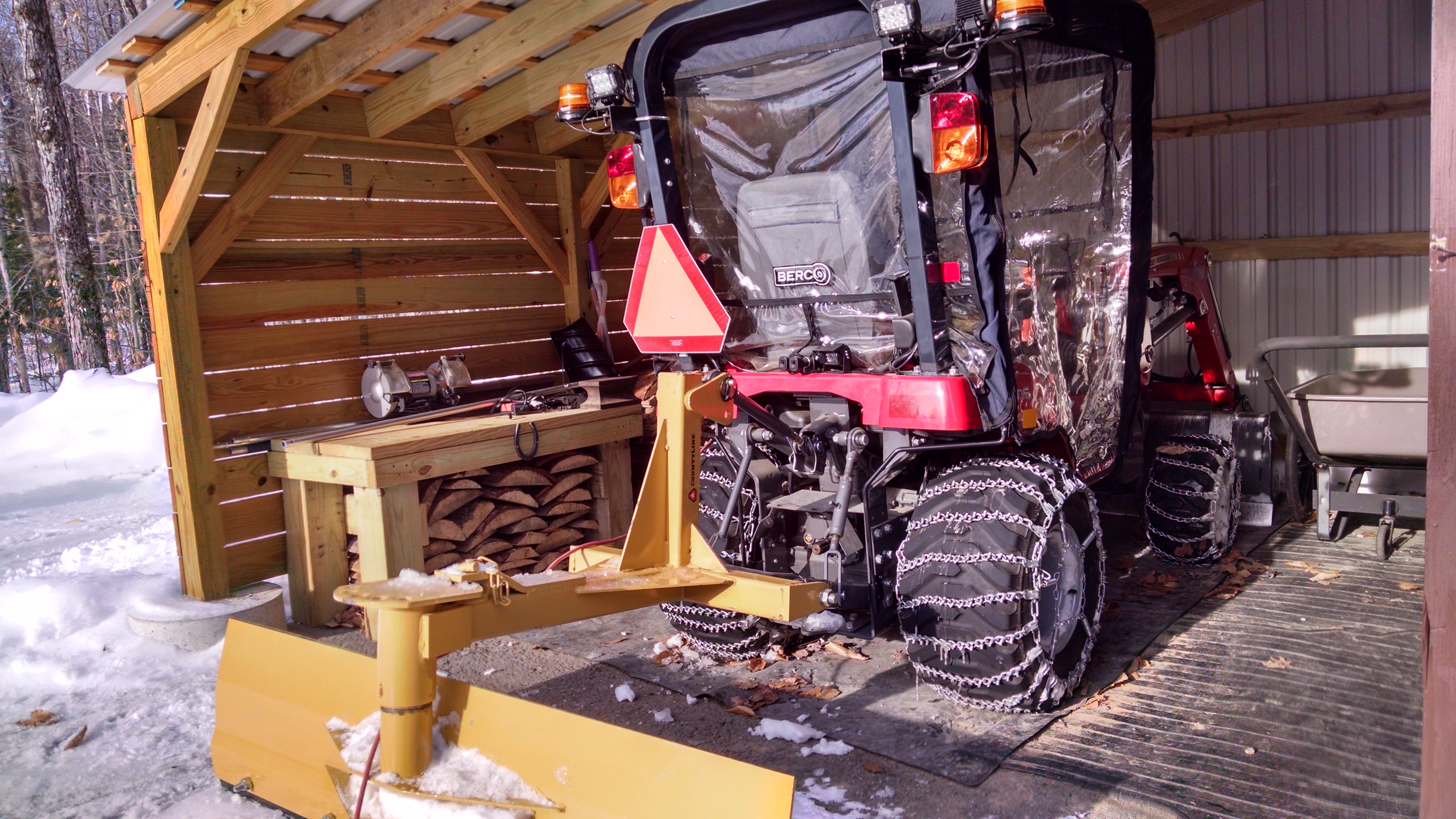

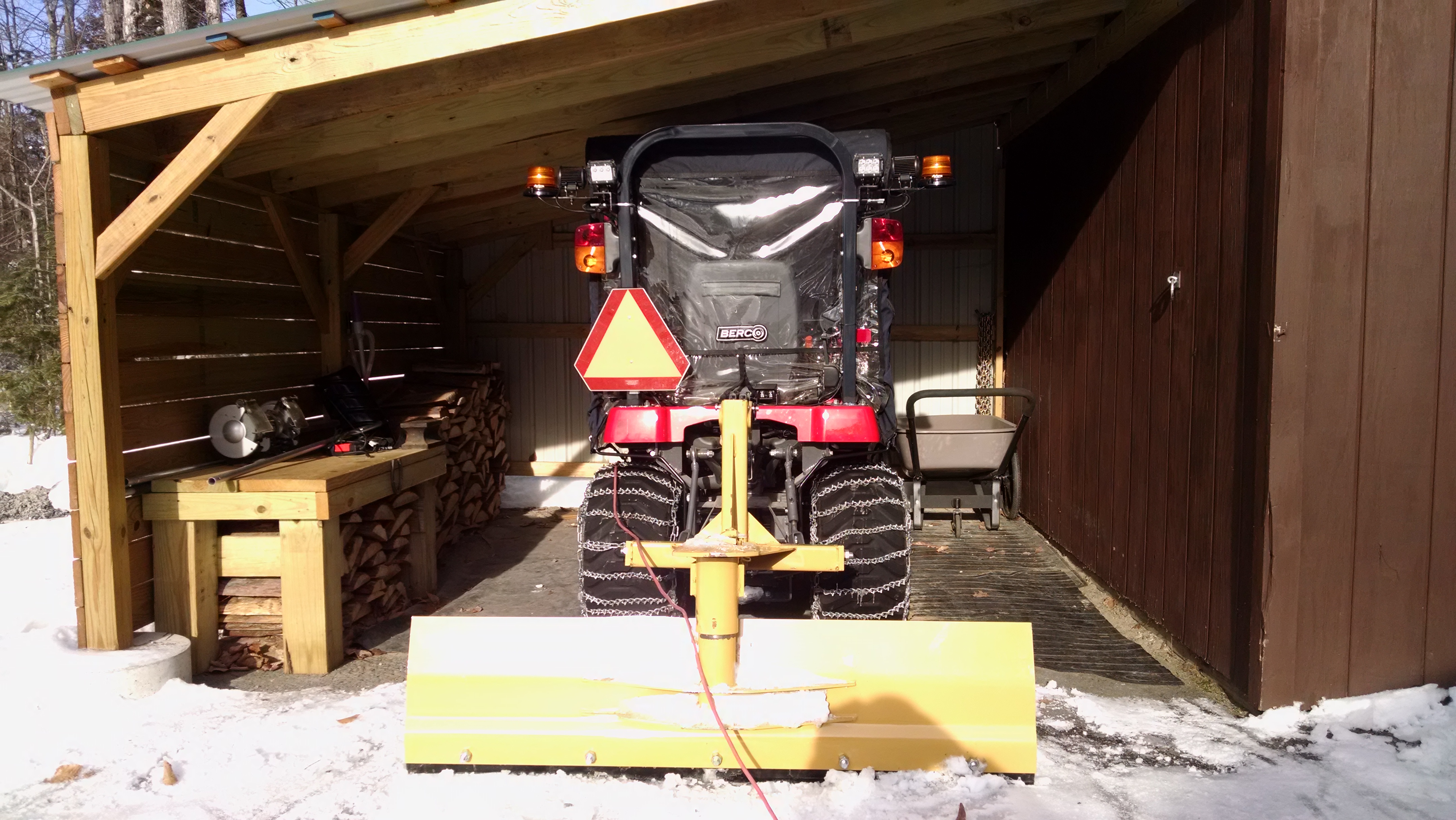

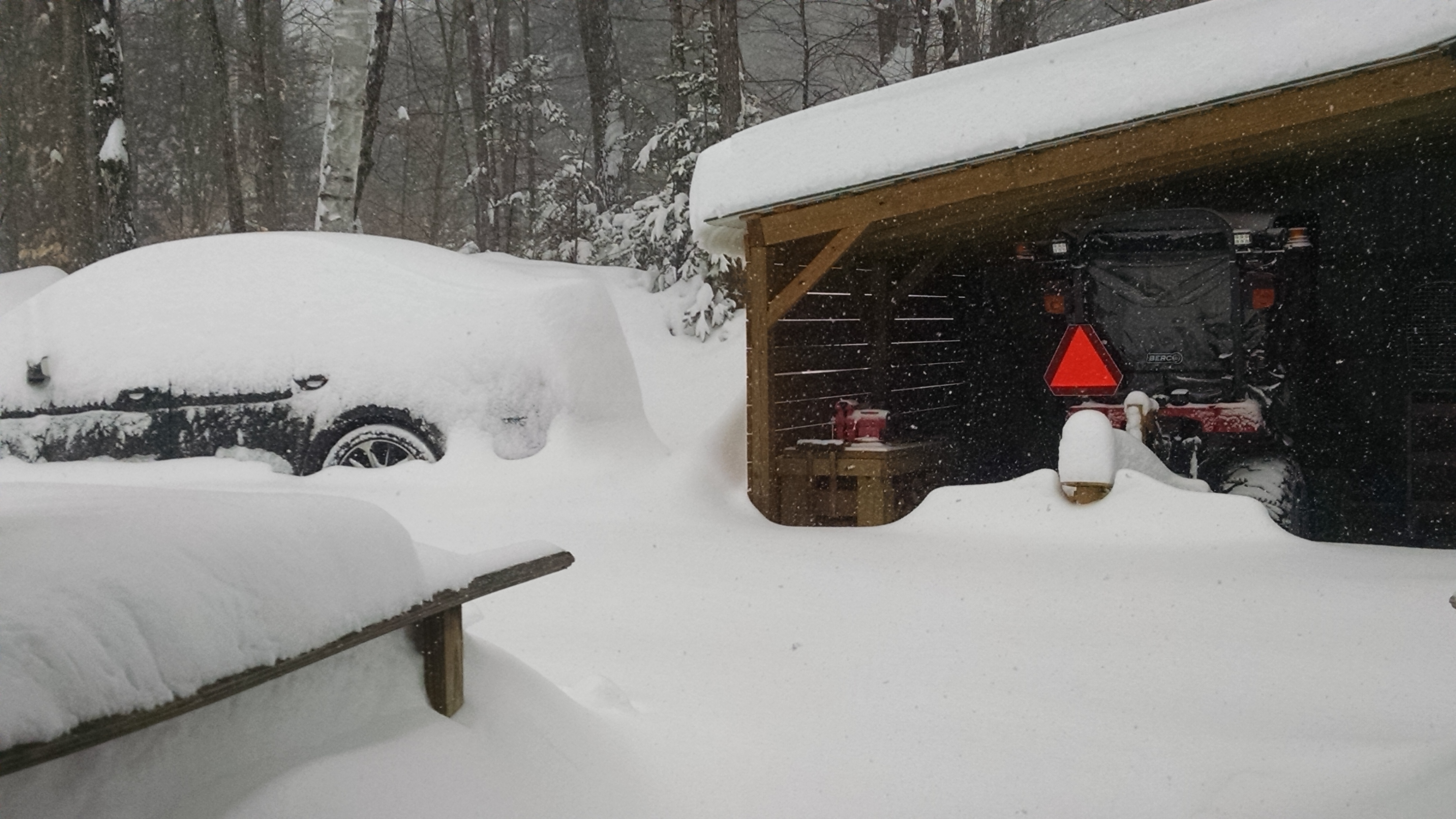

/ Minimum Shed #10
This cost me $800 in materials. 12x12.. You can do something similar and it be free standing if you put some posts in the ground if you don't have an existing structure to come off of..

/ Minimum Shed #12
Atsah, what did you put on the ground in your shed? Looks effective.
/ Minimum Shed #13
I dug it down three feet, removed all the clay, put a foot of one inch gravel and then foundation foam and then filled it with 1/2 inch gravel and compacted it. On top of that and directly under the tractor I laid out rolled roofing..
It's the only piece of ground that never is effected by frost of my property, and no rust on any equipment I put in there..
/ Minimum Shed #14

/ Minimum Shed #16
That's a nice shed! How did you attach to the existing building? I want to do something like this off of my shipping container.
/ Minimum Shed #17
I ran a 4x6 the length of the existing shed (a 2x6 would be plenty) and ran the 2x6's for the roof off of it, I installed angle iron brackets from each 2x6 to the 4x6. 2x6's 16 on center, I used strapping to screw the metal roofing to..
If I did it again I would use 1/2inch plywood, it would have been easier to screw down the roofing and would have cut the rain noise, if it's raining hard it's really loud under there..
