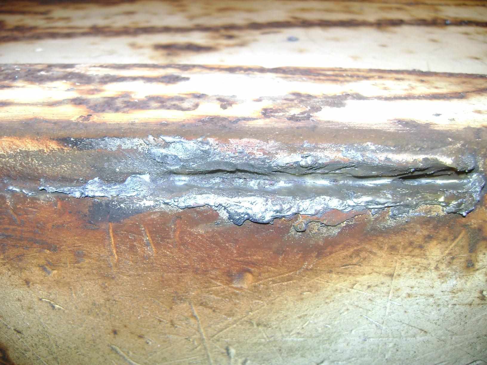

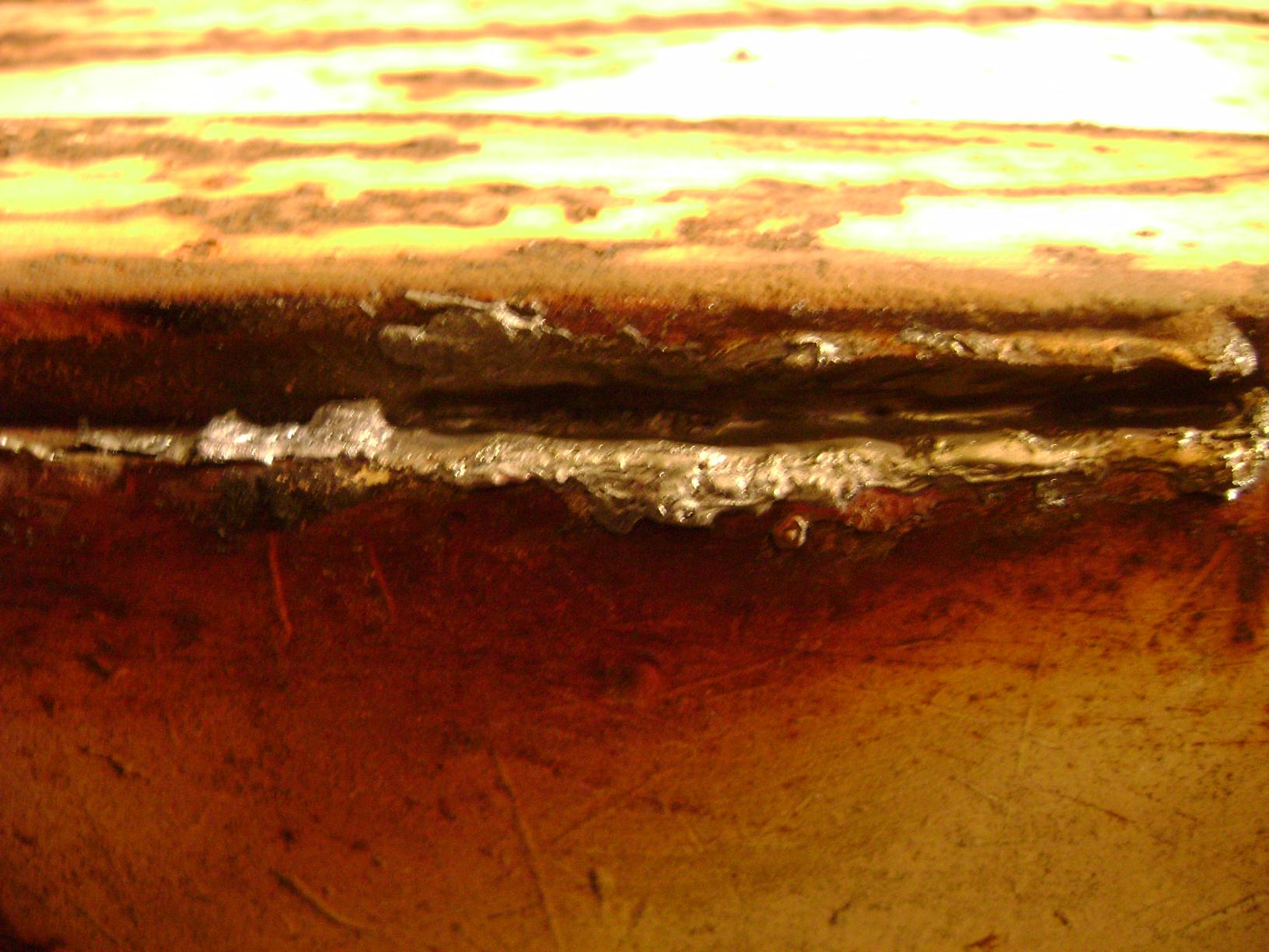

I don't know what the cheapest plasma cutter that can scarf would cost. When taking out a weld I would much rather use a plasma than a carbon arc torch. Scarfing with a plasma reminds me of watching the surgery channel when they're doing laser surgery:cool:. Now if I wanted to hog off a bunch of iron I would rather use a carbon arc torch with the flat rods.
Here is a weld I took out with my plasma.

Before they had plasma torches and the like, we used oxyacetylene torches with a scarfing tip to remove old welds when we didn't have access to an arc gouger. Slow and hot, but it got the job done. Never used a plasma for gouging, only cutting, but it doesn't look like you have good depth control with it like you would with carbon arc or even scarfing tip on a torch.
/ Minimum Amps for Air Arc Gouging #10
Oh it's a lot easier to control the depth with a carbon arc torch! With a plasma you control the depth with angle of the torch, or amperage.

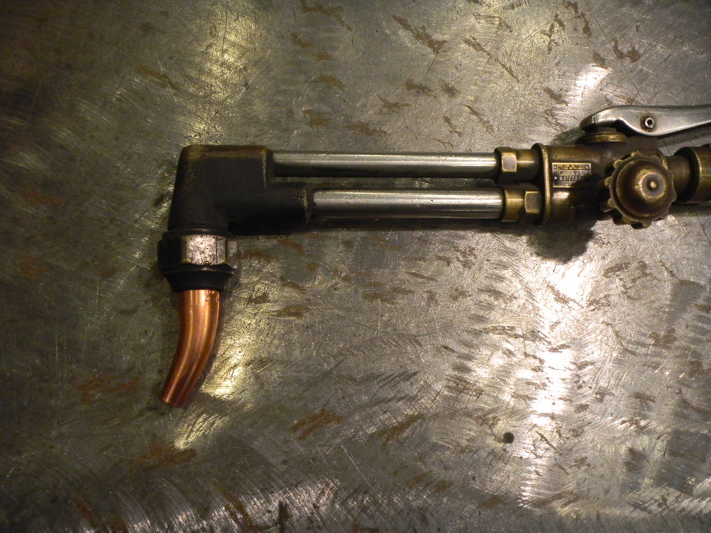

My days of hogging out iron are long gone! I plugged two of the holes up in my carbon arc torch.
