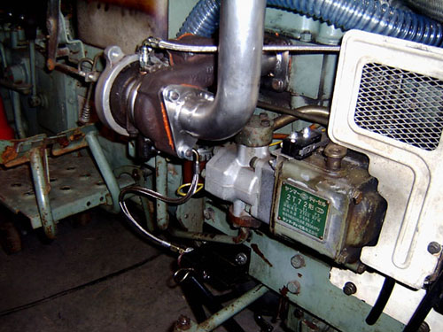

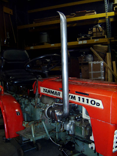

I used a turbo from a Yamaha Seca on my little Yanmar YM1100 tractor. The turbo is small enough to fit on my hand. Yes, it requires a pressure lube and return line. I used a -3 supply line and a -4 return. The return line turned out be too small and I was blowing oil out the exhaust. I increased the return line to a -6 and all is well. Well, almost. It turns out the oil capacity is so small on my engine that the turbo was cooking the oil. I only had about 30 minutes of run time until the oil broke down and I started to loose pressure. At first I tried a trans cooler, then I added some fans to the cooler. Help, but wasn't good enough. I then stepped up and bought a large oil cooler and electric fan. That finally did the trick.
