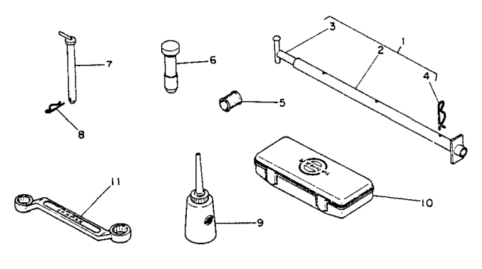

Did your YS80 come with the tool pack? This should be all the tools needed to work on the machine and to disconnect the rear tiller.
