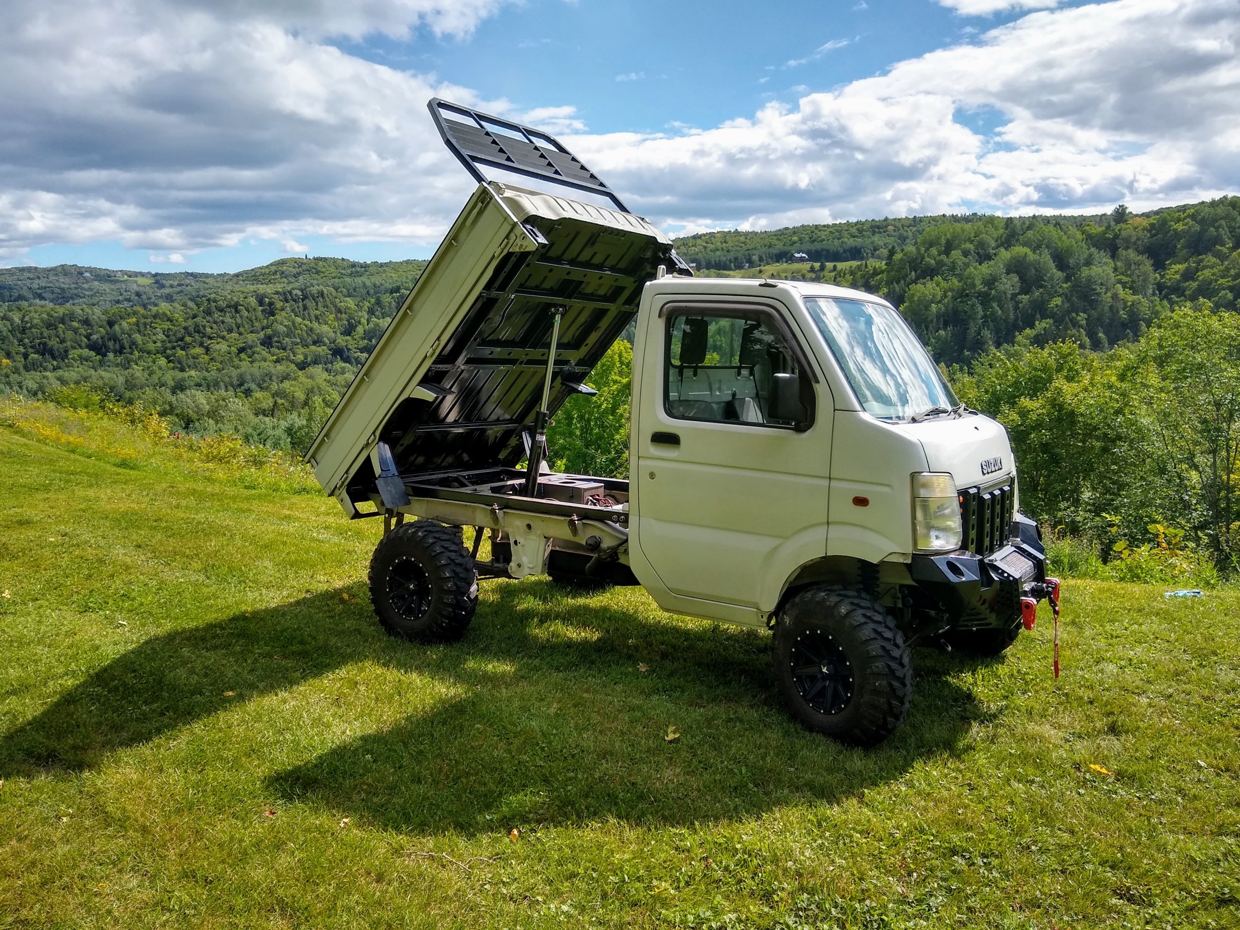

I bought my mini 3 years ago and its the most useful piece of equipment I own after the B26. I can carry logs, gravel and a mountain of branches. I carry 2000 lbs of water in that thing with no problems. No more dumping half the bucket of dirt on the ground. Got a closed cab with heat and AC. If you plan to go offroad get one with a rear difflock like me. Stock they dont articulate well so off camber offroad is not their strength. In some states you can even hit the road with it.

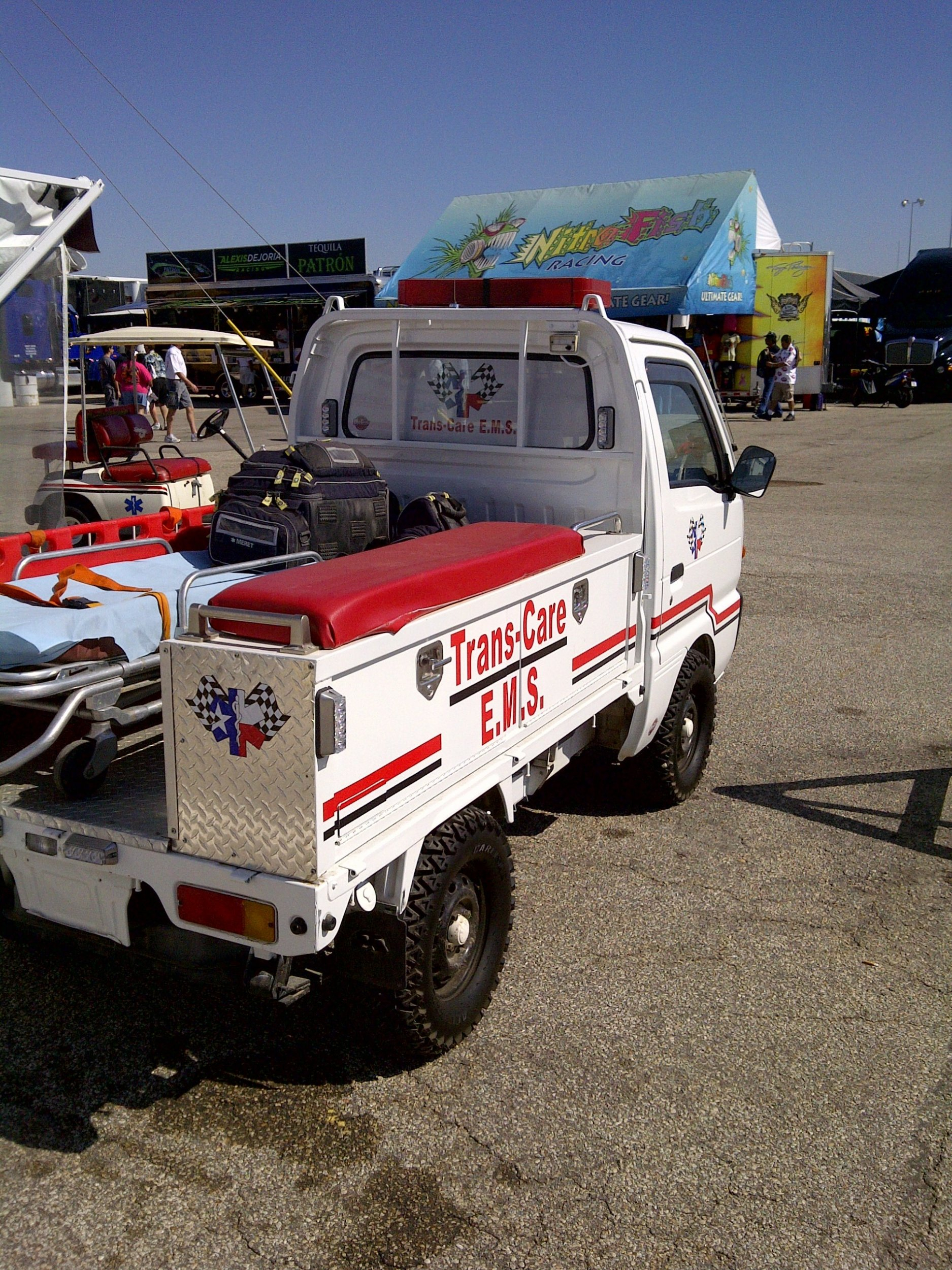

We used them for EMS quick response vehicles at large events like NASCAR, NHRA, and motocross races. They worked well. Did require more maintenance than the JD Gators or Kawasaki Mules. Offroad in the wet or muddy environments they tended to get bogged down from the heavier weight, hence the Gators and Mules.

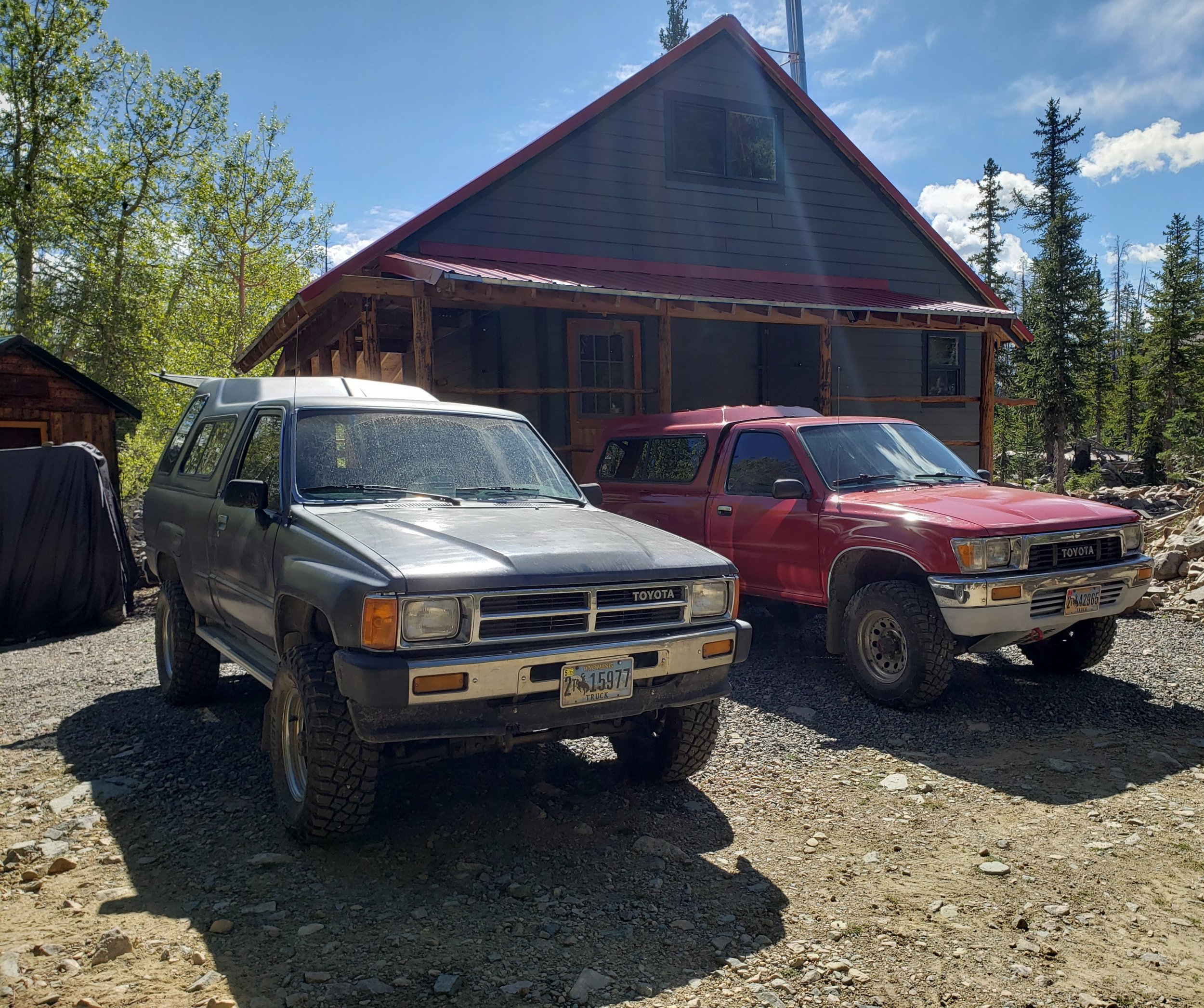

I much prefer these mini trucks. Tough as nails and never break.
We took them up to the cabin last week. They just go and go anywhere at that

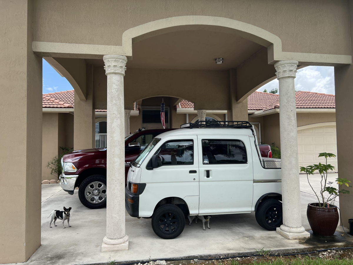

Compared to what? When I picked up mine, it was used with 21,000-km on the clock. And cost about a third the cost of a used side by side. Haven’t checked prices in a while. I know they have gone up some. Look for a low km used one. New ones are overpriced.
If you decide to buy one, look for ones which have a dump or scissors/dump bed. They are considerably easier to work on. The regular beds have a 20X28-inch hole to access the top of the engine. The dump and scissors/dump beds, you just raise the bed in dump mode, and take off the engine protection plate, and you have good access to the engine. Much easier to work on.
The Suzuki and Daihatsu units are the easiest to get most parts for, and a bit easier to work on.
And depending on what set up you get they are pretty solid offroad. They can be had with locking rear differentials. Mine has an electrically locking rear diff, which can be engaged independently. It has a five speed manual transmission, and two range transfer case. The 4wd, with both axles locked, can be engaged in high range with a switch on the dash, but disengages in 4th and 5th gear. Shifting into low range, engages the 4wd in all gears, and locks everything up.
I invested in three sets of tires, and wheels. Mud and Snow for summer, Mud and Snow with studs, for winter, and a set of ATV tires for playing in the woods. It has pretty good traction. I plow with it in the winter, and have a brand new set of chains, that have been bouncing around in the tool box for five years now. I bought them when I first got the plow, thinking I would need them. But, I have never slipped, and have never put the chains on the truck, other than once when I first bought them to make sure they fit, and didn’t hit anything.
With out the plow it has a perfect 50/50 weight balance front to rear. if I mount the plow it adds a lot of weight to the front, and eases the back. So I carry 6 @ 80-lbs of concrete in the back over the rear wheels, to bring it back to a 50/50 distribution.
I drive a variety of UTVs and ATVs at work. I haven’t driven any of them I prefer over my Hijet.
When comparing UTVs and Minitrucks, it is important to remember that the mintruck are designed to be used as farm and construction vehicles. And for utilty use around an acreage, are very hard to beat.
My tiny dump truck, and the ATV dump trailer I use with it, are the perfect compliment for my sub compact utility tractor.
