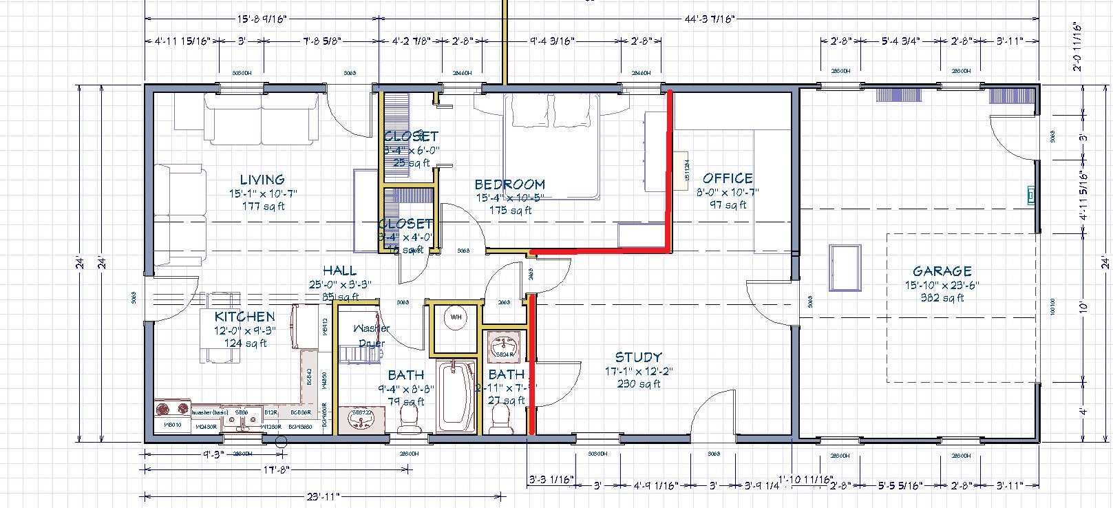

My wife and I are builiding a 1000sqft apartment to move into and then sell our older current home. Specs are:
Metal building 24x60
4in concrete slab with 1in foam board underneath and outside the footers
Climate zone 3
1in closed cell spray foam for the entire building
The apartment takes up 1050sft of the 1440sqft building
Stud walls adjacent to metal framing posts are inset 1in with foam board between wood and metal
Pink batt will be used as the main insulation
Building has 12ft sidewalls and ceiling plane is 9ft
Stud framing is almost done and the discussion about HVAC selection is getting more important.
A 2 zone system is desired as if we decide to build a full house, we can rent out approx. 600sqft and keep the other 400sqft for storage (red line in picture shows separation) plus the shop area.
The local HVAC contractors all want to use a conventional system. The issue I have with a conventional system is all the penetrations through the ceiling plane and duct work running all over the place in the attic area.
Mini-splits solve the issues with penetrations and attic space but the bedroom is only 175sqft. The local HVAC contractors say mini-splits are not as reliable and harder to service.
Any thoughts?

I tried looking up zone 3 but couldn't find anything.. how hot or cold is the weather? While insulation plays the biggest role on keeping your house cool or warm. Either system will do the job perfectly fine.
The main benefit on a minisplit system is the fact that you can have multiple heads on one compressor. Aka creating many zones (including the garage) while a conventional HVAC system can't be attached to the garage (atleast in canada, due to potential co2 getting into the system and spreading it all over the house).
Depending on the weather but the apartment would need to have a minisplit in the bedroom and one in the living room for the best possible comfort, and then add one head to the study room with the ability to have one in the garage too if needed.
Problem with mini splits is they will create areas with varrying temperatures. I.e. if you only have one head in the living room, the bedroom may be too hot for comfort and may result in the need to keep the door open in order to cool it down at night.
Another issue is that minisplits dont circulate and ventilate/filter air as much as a central AC which helps maintain the house at a more comfortable level, better control over humidity, etc.
Also if you get the conventional AC in, you could add other systems to it and take advantage of the ducts, such as a furnace, humidifier, air exchanger. Etc.
Whats the price difference for the set ups?
I personally have a heatpump with furnace going through ducts at both of my places and the air quality is amazing compared to having just a mini split that will heat or cool the air only.

I would use a 1 ton of AC for that space. It could be done with less but you will need it in the winter. You may need a small electric space heater for the coldest days but don't size the unit for the coldest day. A standard DX unit like they want to install will be at least 2 tons. They are oversizing your equipment. Make the space air tight. Allow for fresh air ventilation when needed. Don't depend on leakage to provide your fresh air. This should be a long discussion but I am giving you the briefest of overviews. My house is 4,000 sq feet. I am air conditioning it with 2.5 tons and yesterday we saw 103 degrees and I was getting 65% runtimes. If you oversize the unit it will short cycle all year long and especially in the low demand periods of the year. When that happens it greatly reduces the ability of the system to remove latent load(humidity) from the space. Small living spaces tend to have somewhat higher internal moisture loads per square foot. You may need supplemental dehumidification during the shoulder seasons(spring and fall). Even the smartest HVAC contractors are stuck in an obsolete mentality and suffer from a syndrome where they have never been sued for putting too much AC in a building and are afraid of not putting in enough. Distribution is very important in a poorly built building with cheap windows but less so in a well built building with good windows and good glass. I am temporarily air conditioning a 9,000 sq ft construction site built to exceptional standards with a 3 ton system that came out of my personal home. It was installed 27 years ago and sat unused for the last 13 years until we needed it for temp AC. The building ranges from comfortable to cold and the unit is set to run continuously. There are 12-15 men working inside. Every afternoon temps reach in excess of 100f. Oversizing of AC equipment is universal in the industry. I am leaving many pages unsaid. This is a big topic with many subtopics.
   / Mini-Split or Conventional for HVAC?
Our location is central NC which means winters down to 15dF and summers up to 95dF with humidity upwards to 80%. So, humidity control is a must.
As for fresh air exchange, that definitely is a concern given the entire building is sealed with the 1in closed cell spray foam. Panasonic does have a fresh air add-on to some of their mini-split models though.

One thought I've considered if I go with mini-splits is to buy two dual head systems. That way, if one compressor goes out, I would have some degree of redundancy.
The comments about oversizing a conventional system are true here as well - the contractors all want to do that. They say that with the variable speed fans, an oversized unit will be fine as the fans run at low RPMs. Plus, they say that if I want that extra umph of cold air during a hot summer, the unit can do it. I suppose there is an argument there.
Still, I can't help but think of all the ceiling penetrations for the supply ducts and resulting air leakage points. And I might be overthinking it too much given the building is sealed with the 1in spray foam.
Point for the conventional unit is freshening the air better. While some mini-splits do have a fresh air exchange, we'd have to use the ceiling fans all the time to stir the air whereas a conventional unit would do a better job by default. My wife and I smoke plus have two cats so I have to wonder if a mini-split can clean the air as well. I know some of the mini-splits can be equipped with HEPA filters.
The praises of the mini-split efficiency and low operating cost wins hands down. I have to wonder about servicing the units though - is it as easy to service a mini-split as a conventional unit.
