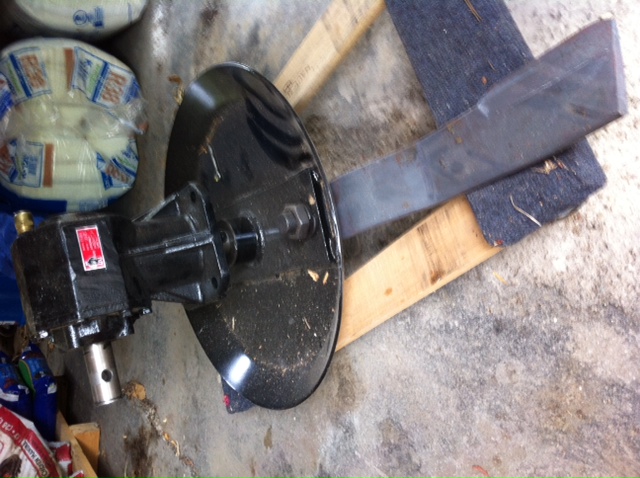

I searched far and wide for a mower deck but could not find any in my area that were in ok condition or reasonable price.
I ordered the following items for my build.
1. 40hp gearbox 1:1.45
2. stump jumper plate
3. blades
4. blade bolts
Next is sizing hydraulic motor.
Since I only have 8gpm @ 2500psi, I'm somewhat limited in sizes. I've calculated in order to have a input speed of 2500rpm for output of around 3600rpm, I would need a high speed motor of around 0.5cu in.
Surplus Center - 0.580 cu in PARKER MGG20025-BB1B3 HYD MOTOR
It seems a bit fast so I might size the motor for a 1.0cu in for half the input speed for output spindle of 1800rpm.
Thanks,
Curtis

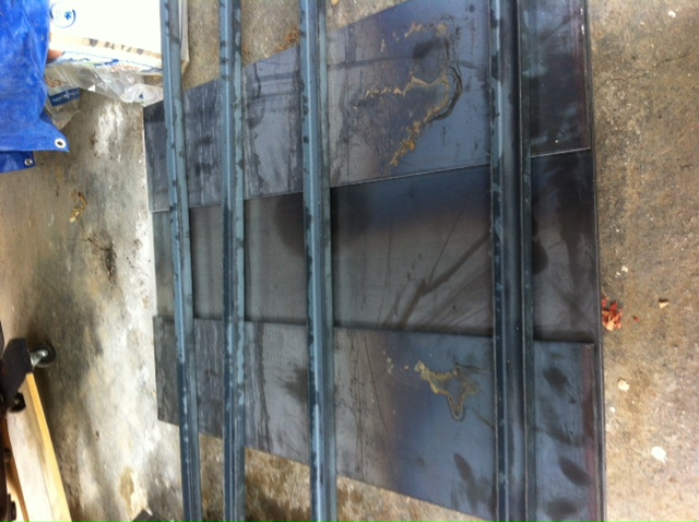

After a few design changes and finally getting to this project, I have the steel ready for welding!
