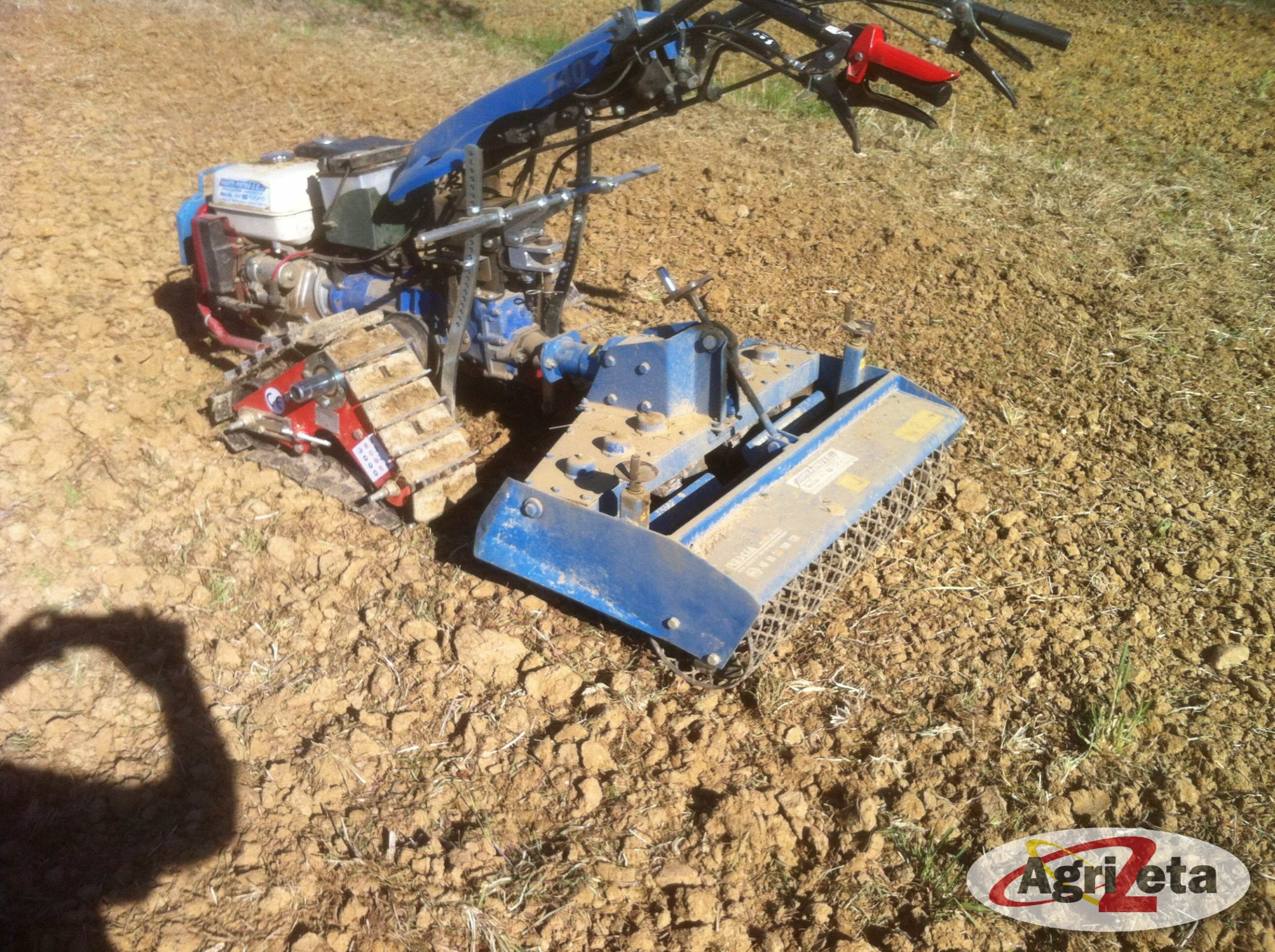

Based on what you have provided to us and "what you think you should have" you cannot
safely use a used sub-compact tractor.
A used sub compact mule like the BX1860 or a 4 wheel drive 4 wheeler will cost you as much as
a base model BCS 853 2 wheel tractor.
You should invest in a BCS model 853 2 wheel tractor with the Agrizeta FST metal tracks and a BCS
ride on dump cart, stone burrier, front weights and a BCS 32" flail mower to start with.
The Agrizeta FST tracks can be widened to increase the stability of the 853 2 wheel tractor on hills.
You can always purchase wheel weights and axle extensions to widen the BCS 853 2 wheel tractor.
If your worried about maintaining a trail a 32 inch BSC flail mower will do that for you and a stone burrier
like the one pictured below will flatten it for you.
You do not require a six way blade to go along with it.
You need the metal cleatrac FST treads pictured below for traction and the front weight kit to reduce any chance of sliding as
the rubber tracks will cause it to slide on you.
