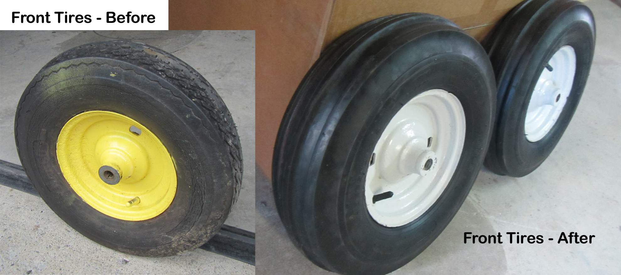

OK, small progress. I got 3 rib tires for the front for the "8N" look. Here they are.
I got the engine out, and I found a place to send the brake shoes away to be relined because I couldn't figure out what they were for replacing. I've gotten a 23HP Honda V-Twin ready to paint Red and install. The Awesome Henry Mini 8N body kit is on order. Found some 16" x 7" Ag Lug tires that fit my 16" 5-1/2 x 5 Ford wheels. Almost everything is falling into place. Key word is almost.

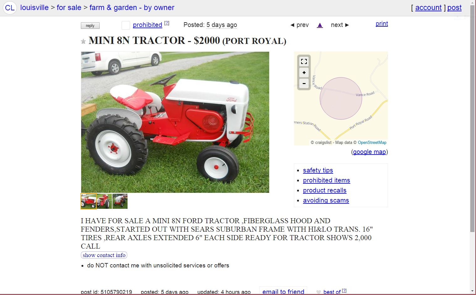

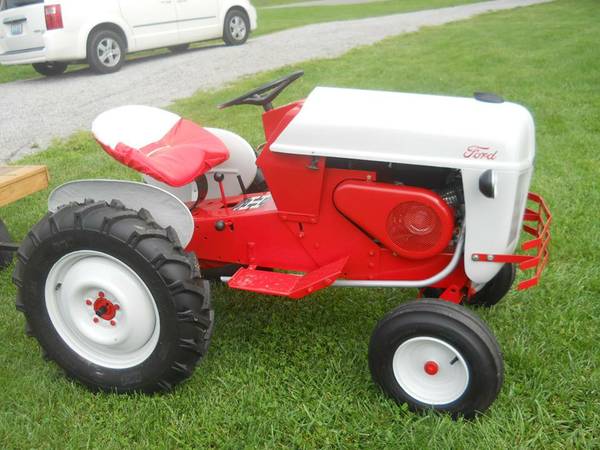

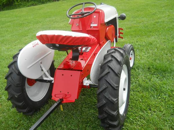

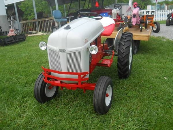

Never knew a mini 8n existed. Saw your thread yesterday, then found this on Craigslist today.
MINI 8N TRACTOR
   / Mini-Me 8N project (Follow-up to Frank-N-Ford)
#17
Cool! These are one offs, never an official production run, just home builts. The Sears/Mini 8N looks well done but mine will be a serious tractor, Solid Bethlehem Steel I-Beam frame, Ford Model A steering, trannie and rear axle with a 23HP Honda V-Twin, probably will tip the scales at about 1,100 pounds. Should pull like a son of a gun. I got my Awesome Henry body kit and engine so I am just starting to put things back together.
