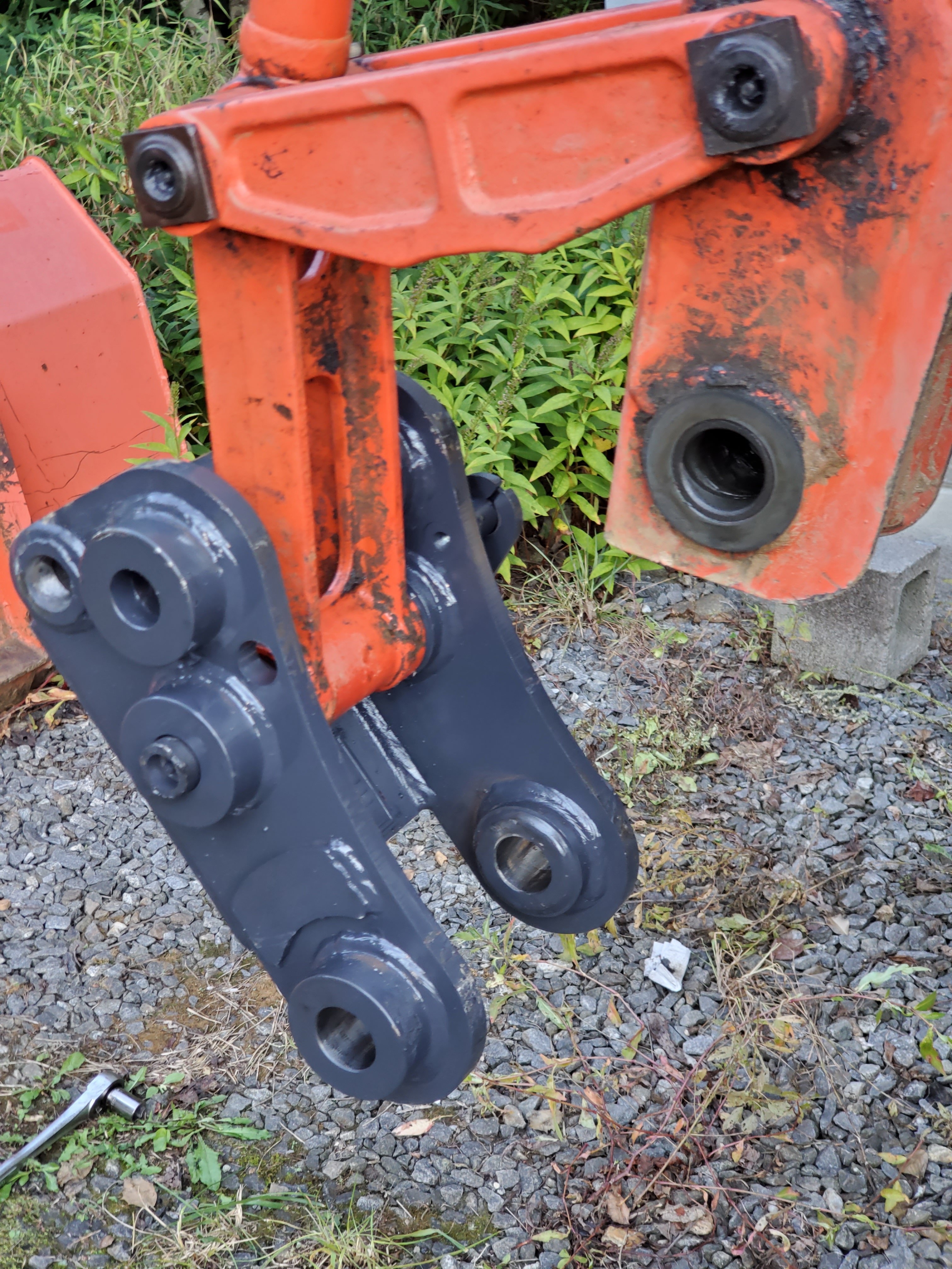

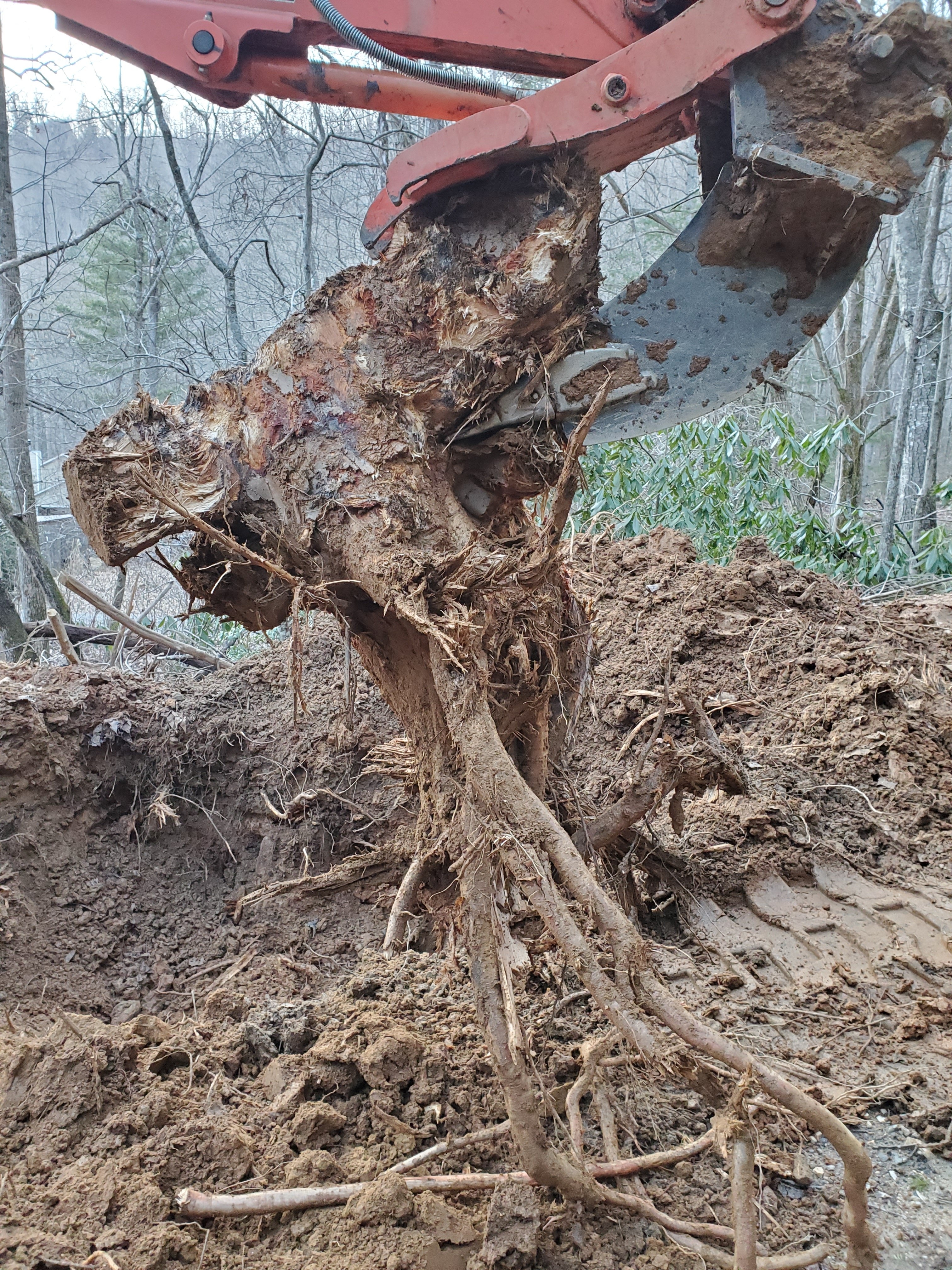

Have a look at USA Attachments. That is where I purchased my M59 to KX series quick attach coupler, giving me access to the KX tool line ( new and used) which is far more extensive and less expensive than the M59/M62 specific quick coupler and bucket only choices. I have found them to be good people to work with.
I've purchased a number of buckets with and without teeth. Also a root ripper which is not available from Kubota as either pin or quick attach.
It should be fairly easy to weld a set of KX coupler ears to a SSQA attachment plate and off you go to the races.
