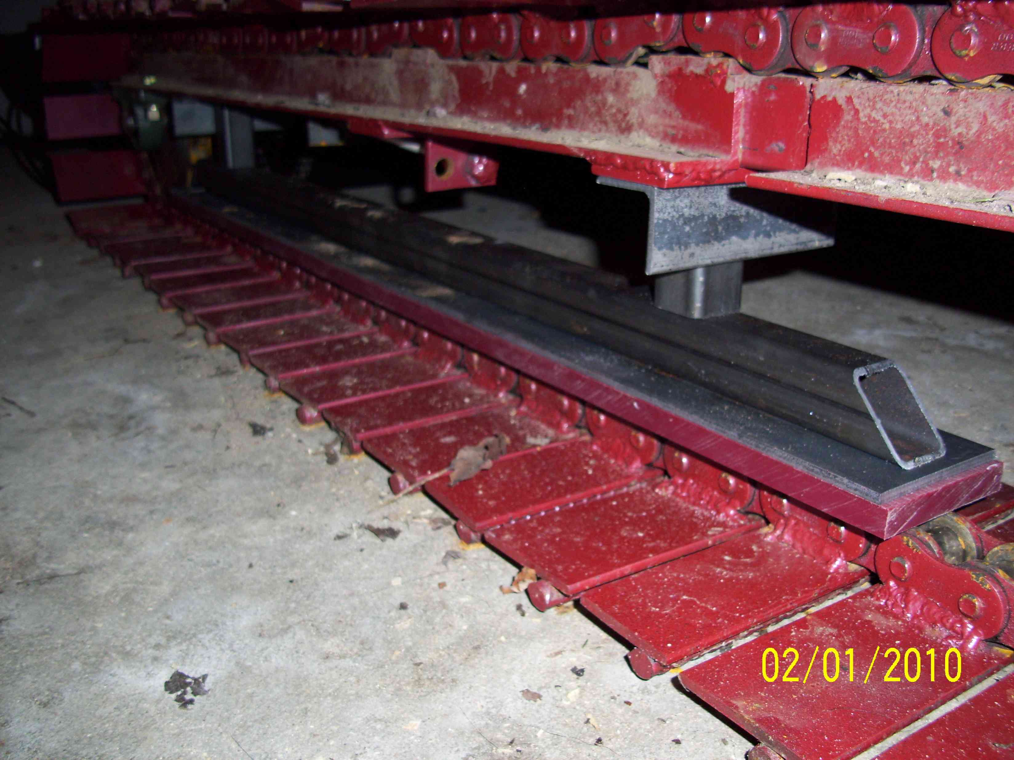

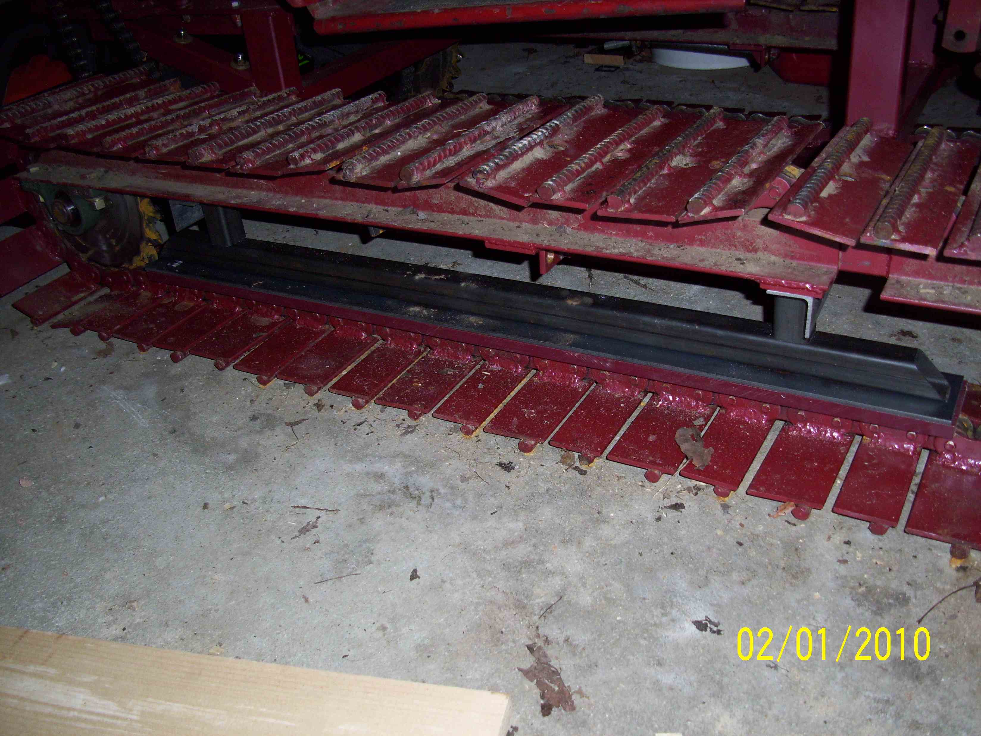

Currently mini dozer down the road at the neighbor痴 house in his garage. He used it to move fill behind the garage. Unit keeps on going. I have not made the drive line improvement yet because I have been waiting for things to fail and they haven't. The improvements to track slides have done wonders for keeping the tracks on the unit. I have a small list of minor improvements on the to do list.
