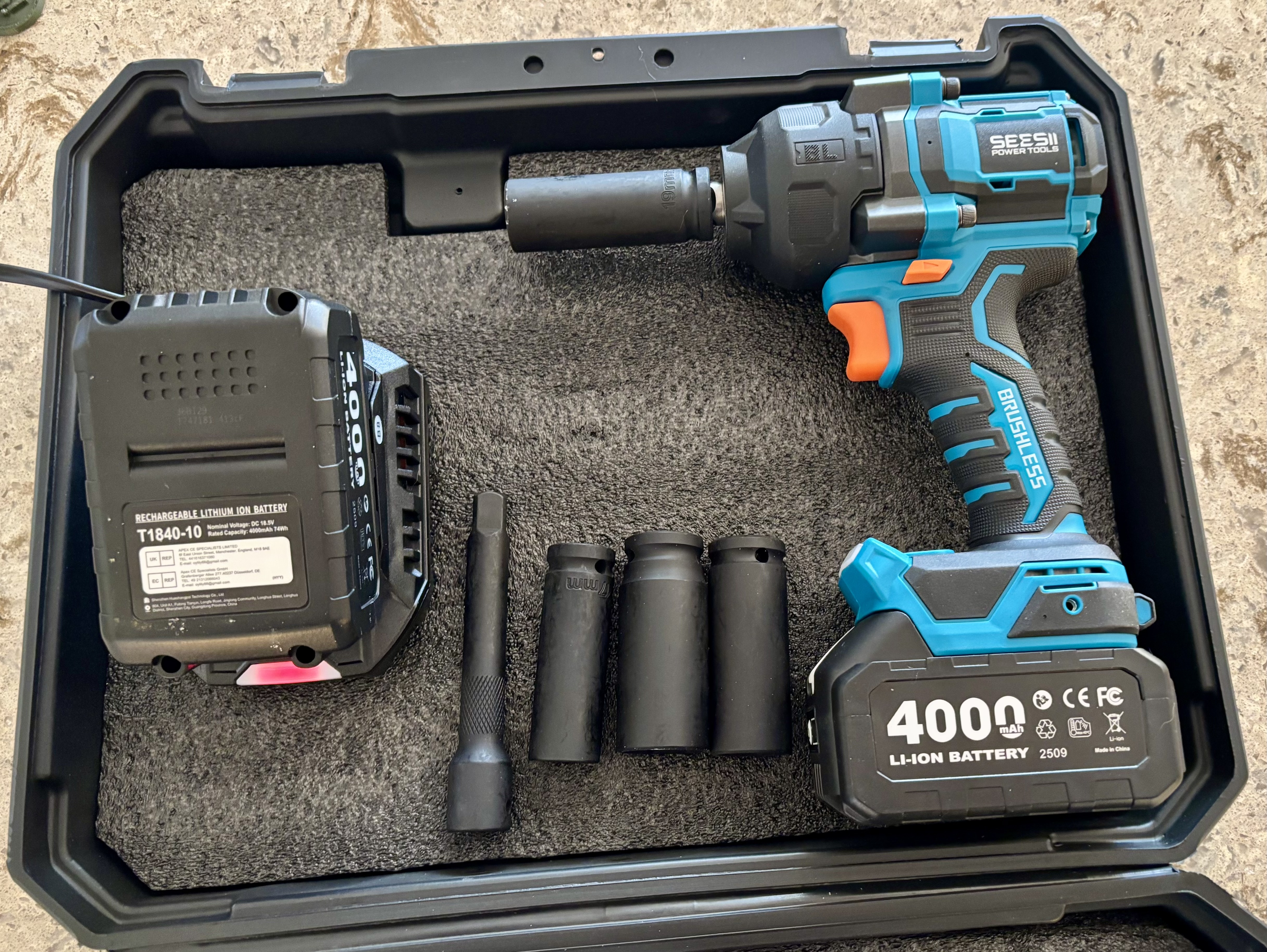

Having become an avid Torque Test Channel watcher, one Amazon “bargain brand” kept coming up - SeeSii. They can use Makita batteries and are very similar to the Makita XWT19XVZ but doesn’t seem to be an exact clone.
Checked Amazon Sunday and what was already a really low-priced kit for the WH760 - list $149 with a charger, two 4Ah batteries, and four sockets - was on Amazon for $85. This is a mid-range model but advertised 738 ft lbs of break away torque. Three year warranty. There is a newer model for $5 more.
Makita charges $139 for a single LXT 4Ah battery (kit is $439) so these can’t possibly be any good, right? OTOH SeeSii is a “e-commerce only” brand so there are no middlemen.
Charged up the batteries and tried it this morning. Took off 19mm and 21mm lug nuts with no difficulty at all.
They make a high torque model with 1,180 ft lbs breakaway but it’s big and heavy - 8.5 lbs with battery. This one is 5lb 12oz on my digital scale. Stay tuned!
