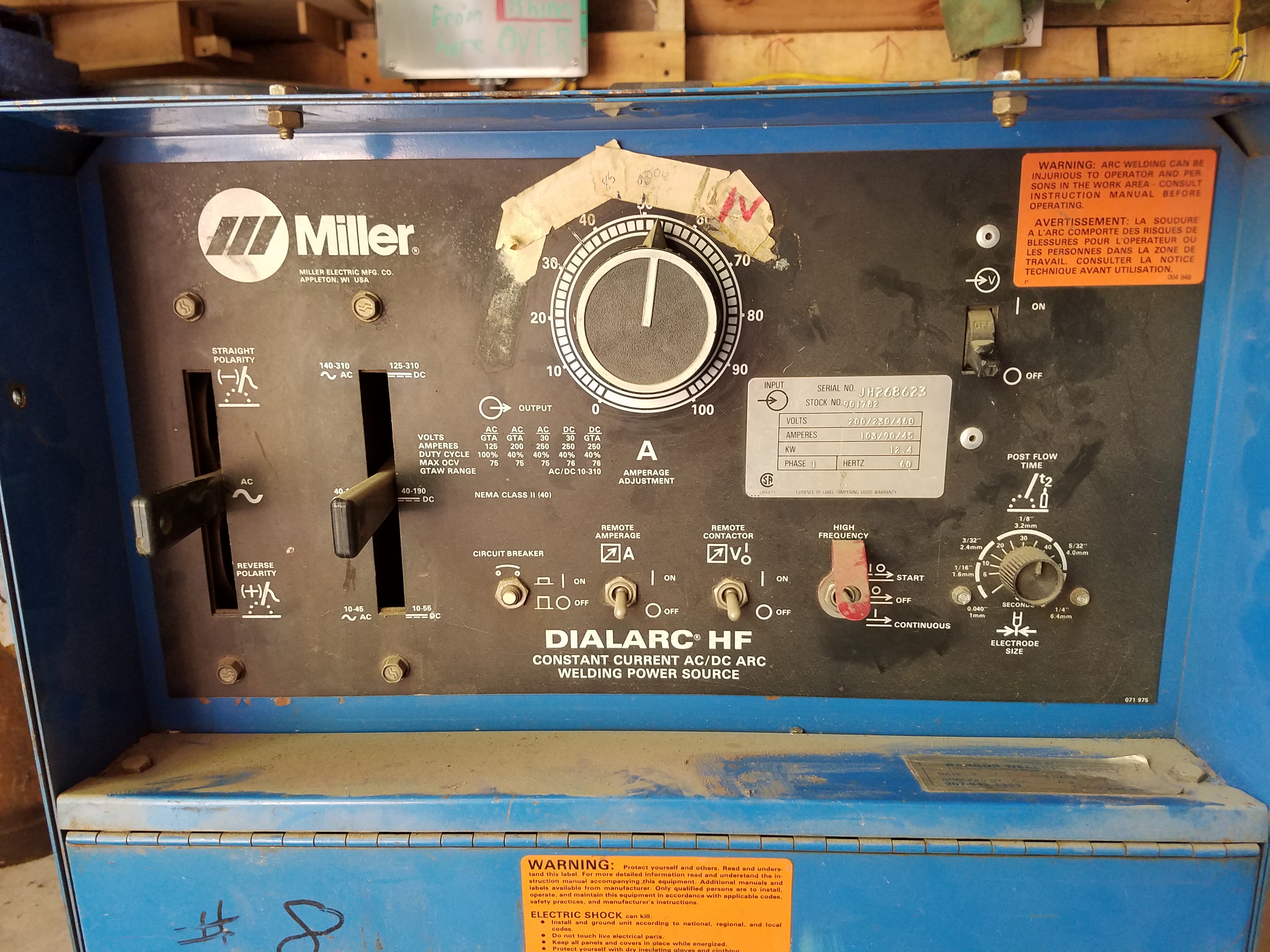

Obviously I'm not chatting with people who just weld for a living. So if I'm understanding this incorrectly, if I set my welder at 250 welding amps, it's actually XXXXXX watts, will I be graded on this quiz............
Yes mostly. And the watts is dependent on the welding voltage at those amps.
But technically you don't really need to know all that to weld :)
I weld part-time from my home shop and now mobile too. I teach math from 7th grade remedial through calculus, woodworking and welding - quiz on Monday :D

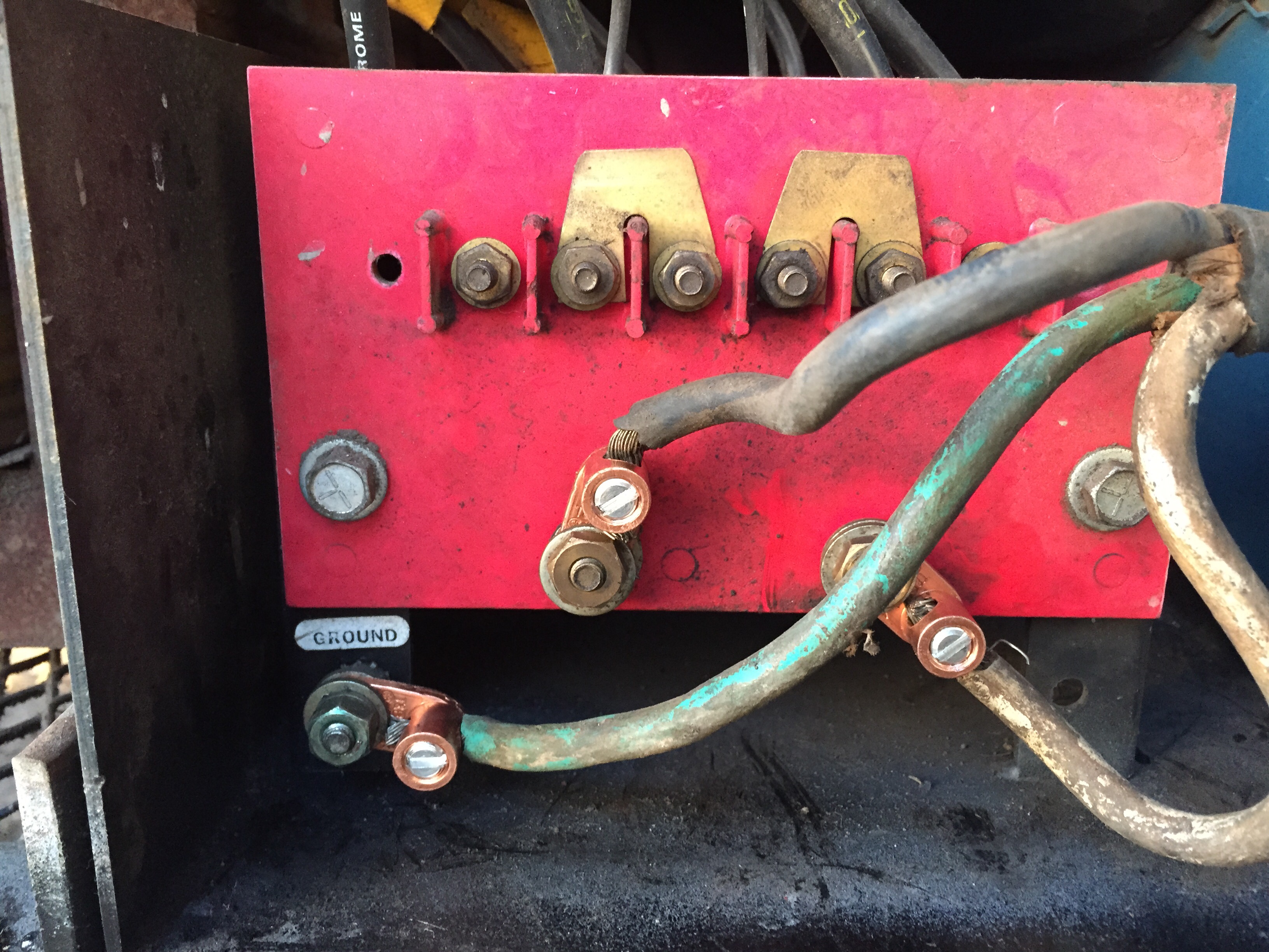

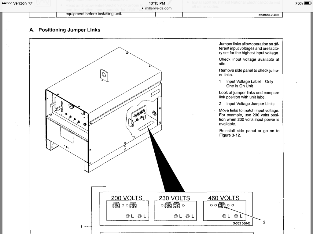

Hey I like that color picture, glad you said it was for 230 volts cause mine isn't like that, thanks a bunch :thumbsup:
Now that I have the side panel off, good time to do some cleaning, a little dusty inside.
