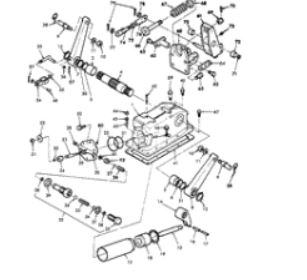

Also check the breather on the hyd reservoir. If it's plugged the moisture has no place to escape when oil & water gets up to operating temp.

Ok Tx Jim, I wonder where that is located?? I will see if I can find that..

Tx Jim,
Can you send me this Attachment to my email so I can make it larger?? Its so small I cannot read it..
