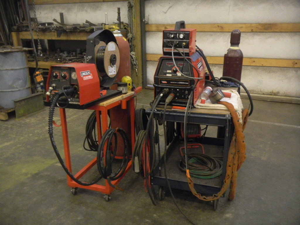

I've never done auto body type welding. There was a time in my life where I thought 3/8-inch thick material was sheet metal:D. These inverters just amaze me!:cool2: The control they have over the puddle just floors me. For years I had a Linde VI-206 transformer Mig welder. It had variable inductance control. That was really sweet! You could dry the puddle up for out of position welding, or wet the puddle out for flat welding. I thought that was the best thing since chocolate ice cream:laughing:. Then I bought a Lincoln V350-Pro with pulse. Now this machine is totally amazing!:thumbsup:

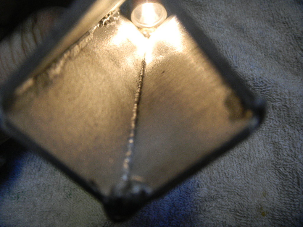

Here is a 16-GA aluminum outside corner joint done with a spool gun, ran with pulse.

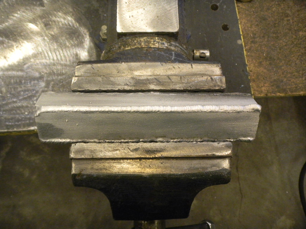

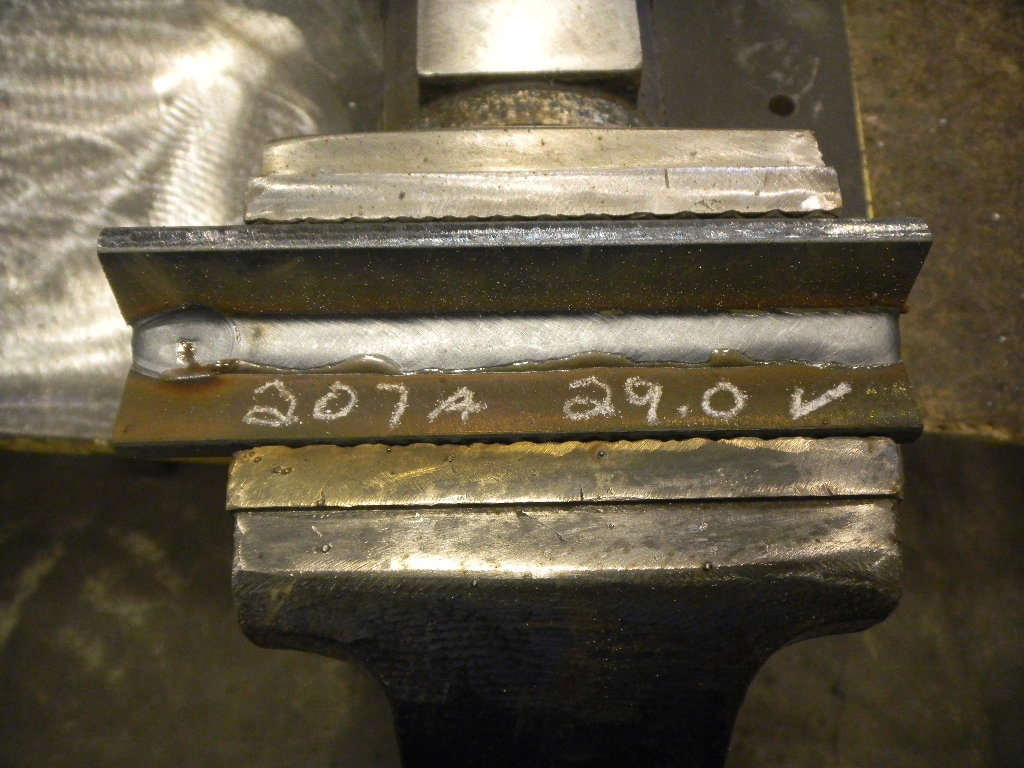

JB I'm really the last guy on the planet who should give advice on welding thin material. Even tho I worked in a sheet metal shop for 3-years, I never did much sheet metal welding. Same shop I welded up to 4-inch thick material. I feel more comfortable running hot and fast!:cool2:
This is my idea of a Mig weld, with .035" wire.;)
Shield Arc that is a very neat weld - I can barely make out the Cs. I never achieved that quality when I was using our tech school's MIGs. If I do a fillet weld using stick on a piece that thick, I really have to concentrate on wetting the edges and pushing up the puddle with the electrode otherwise my welding starts to splutter and I end up with weld dags and heaps of slag inclusions.
/ MIG inverter advantage? #18
You can't make out the C's cause it's spray transfer...
Oh I C: D. I was wondering about the 29 volts chalked on the work. Thank you, I have heard of spray transfer but didn't know what is was about.
