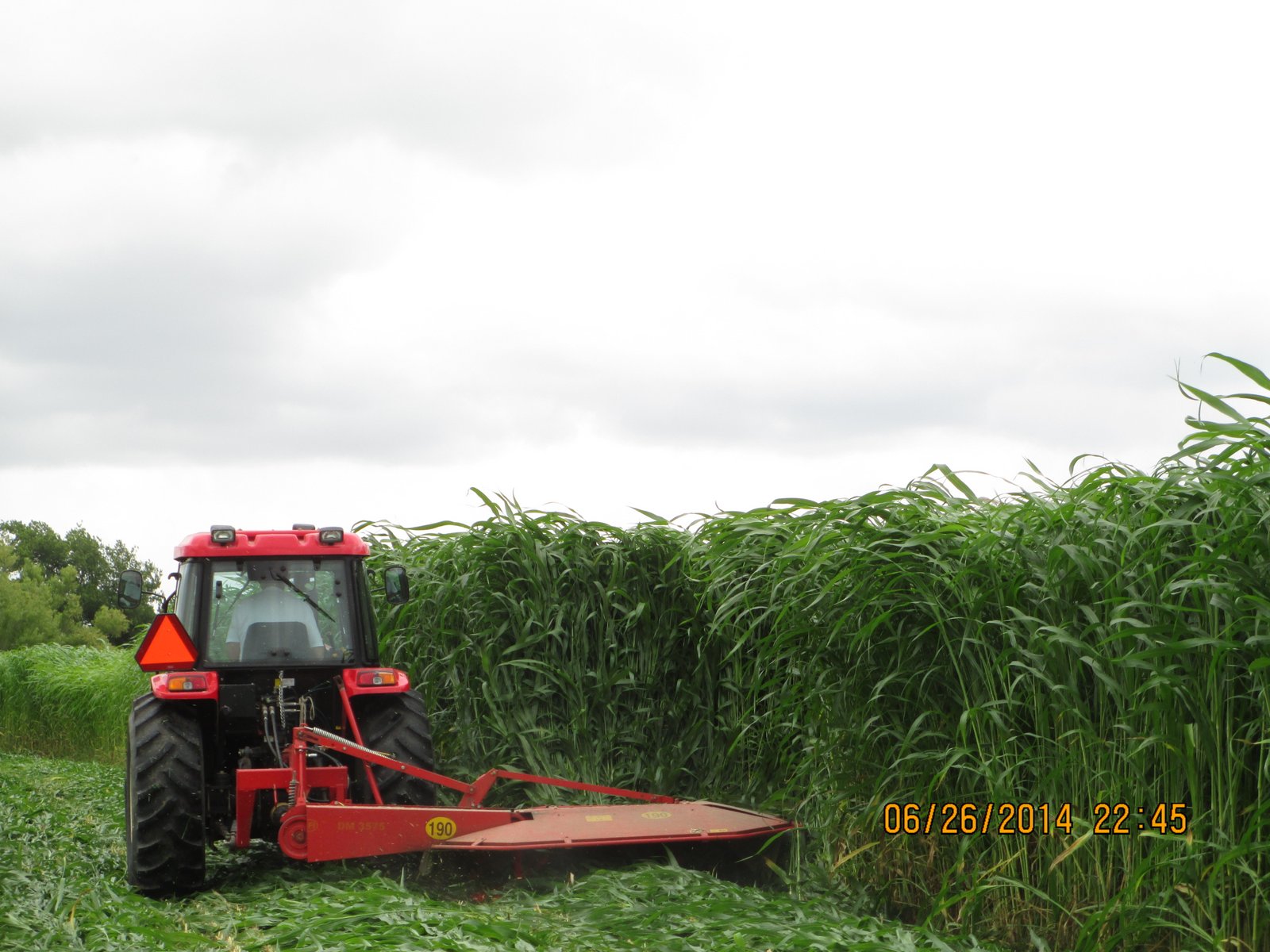

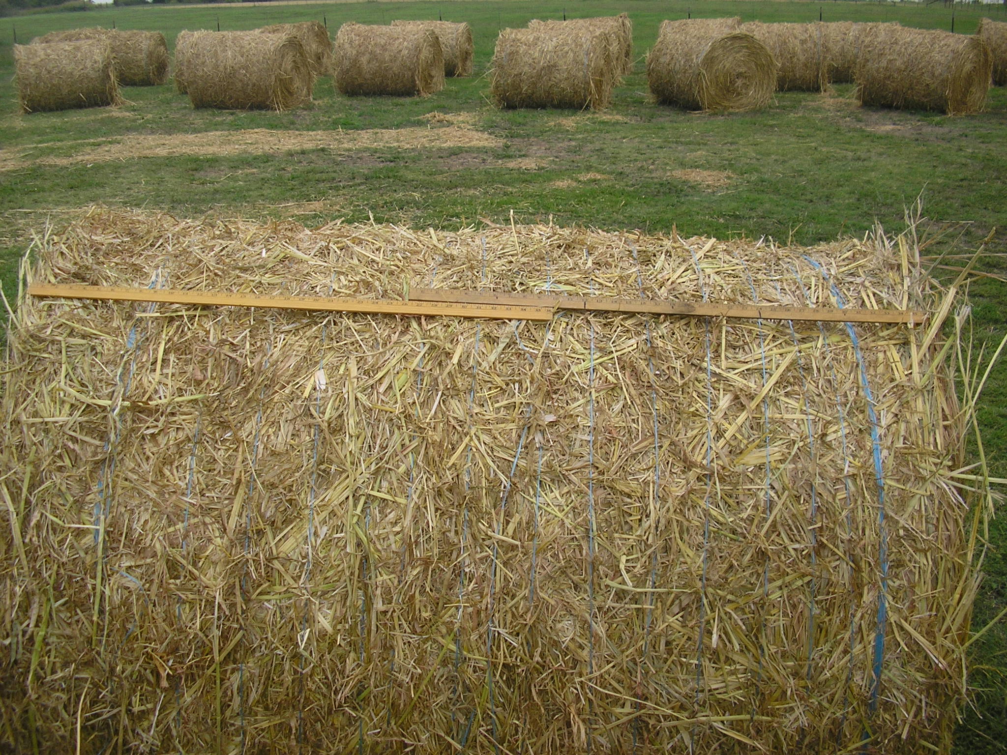

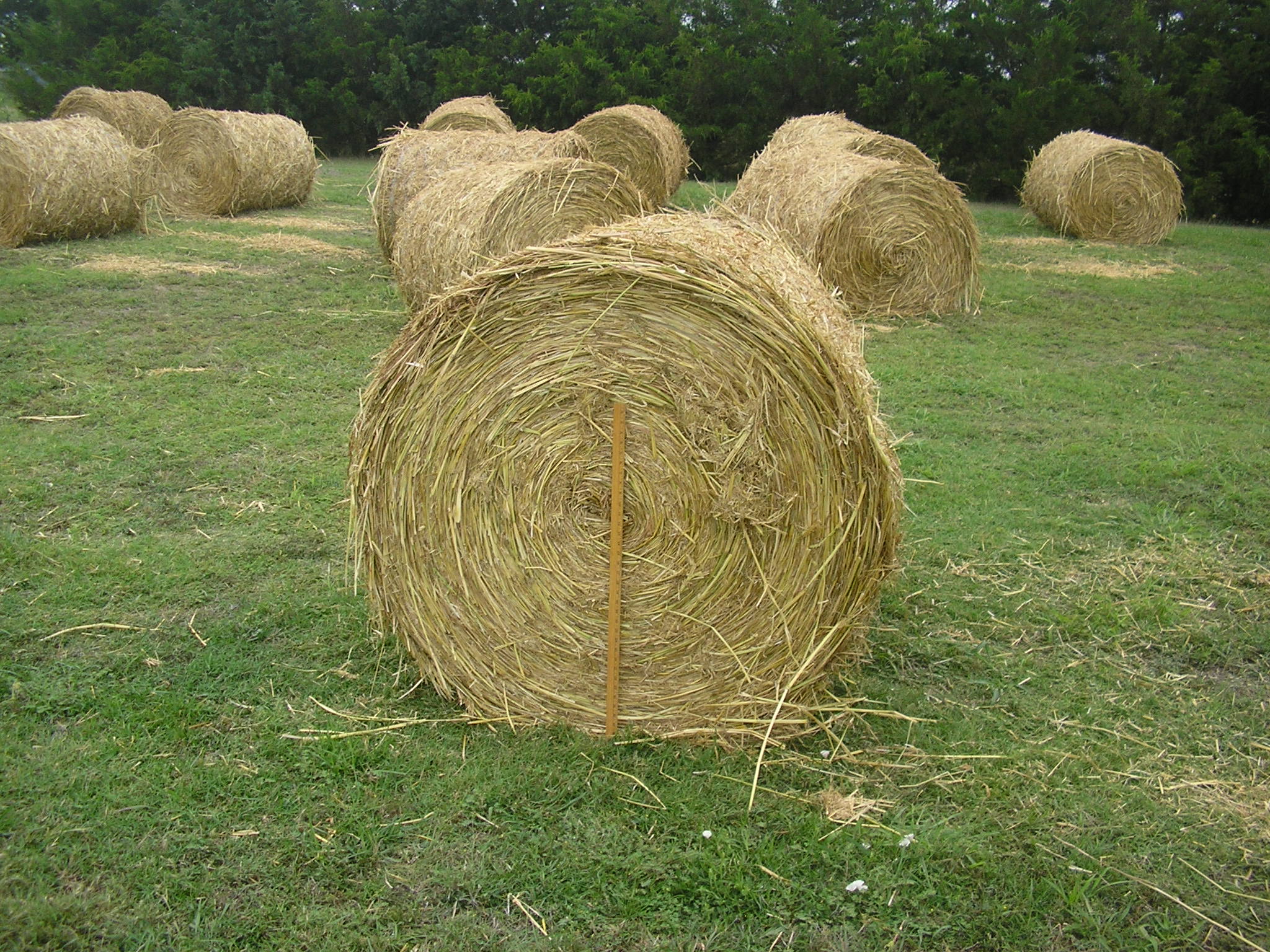

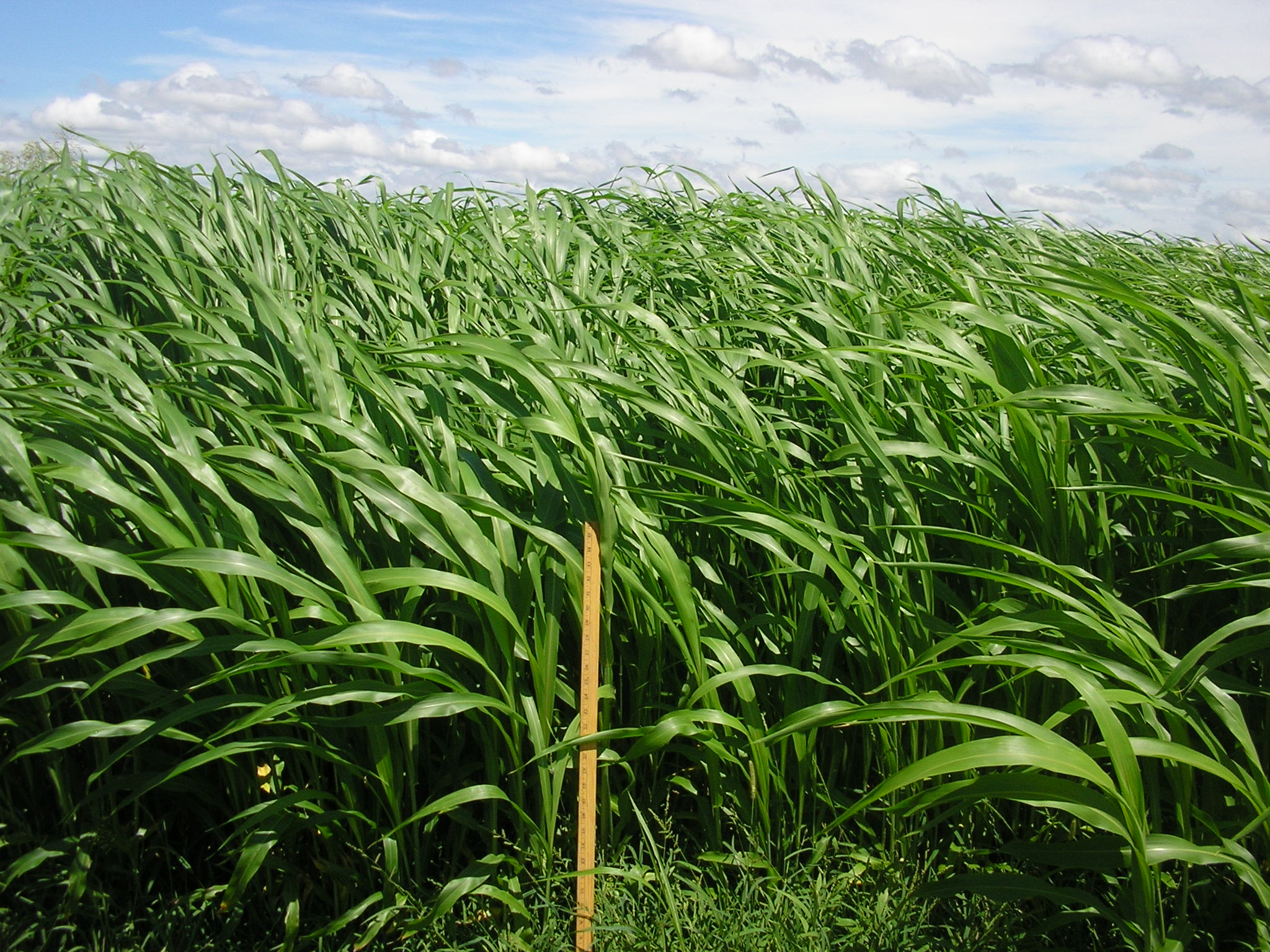

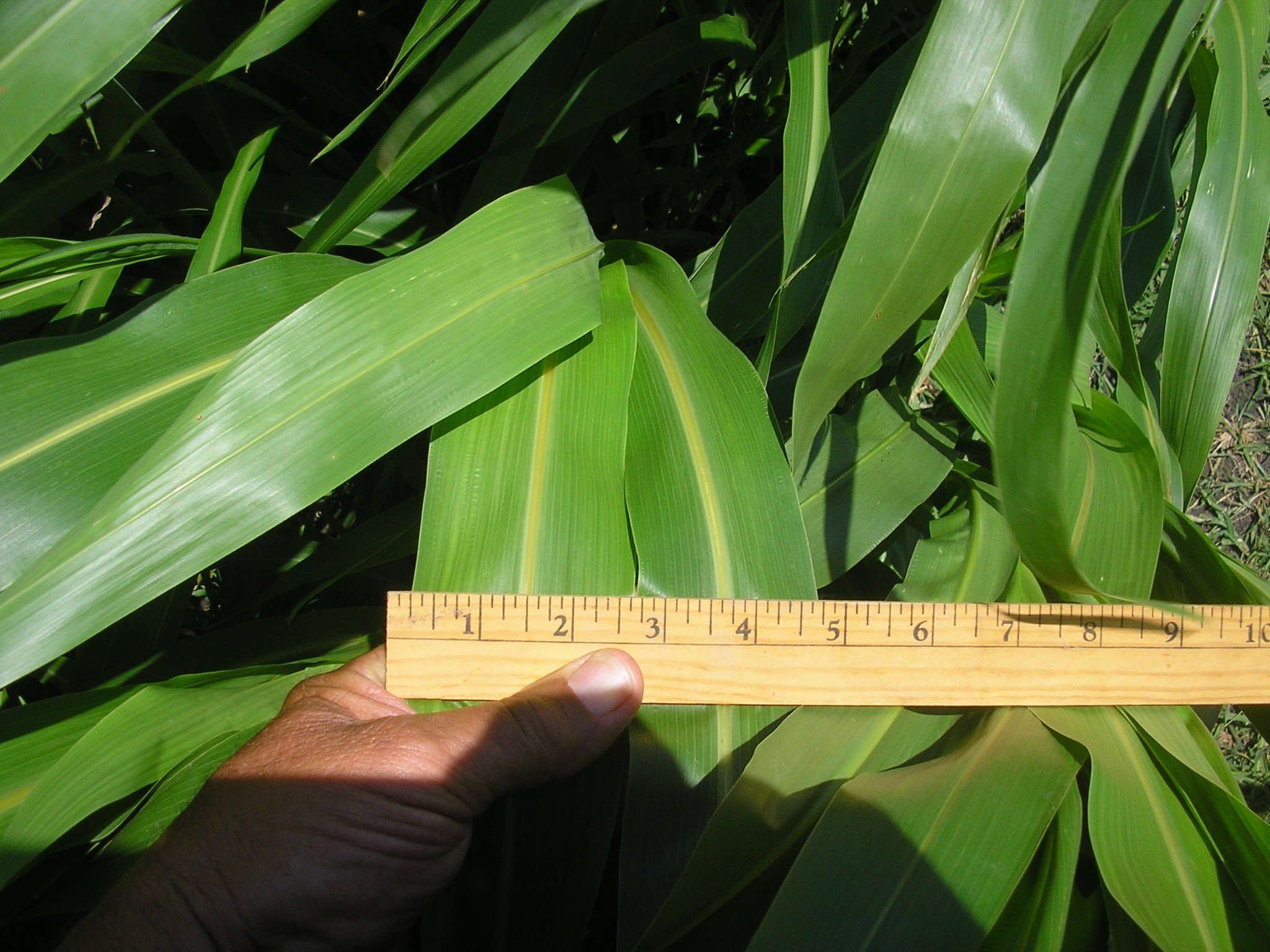

You wouldn't believe what I went through to get this mess bailed. I couldn't get it cut when it was a reasonable height due to an unseasonably wet June. The crop was a small stem, late maturing sorghum-sudan hybrid plant that kept growing well past the time a normal SS would have topped out and turned to flax. i worked on in for over a week....course I work alone and that is a hindrance.
Going to plant it again this year but hopefully the weather will cooperate and I'll be cutting it at around 4'. That length will tedder and rake up nicely for my round baler.

Whoa... Looks like you were puttin' hay up in Vietnam! Very good lookin' bales, too. I'd like a 30' trailer load, please.
What width is your cutter and tractor Hp?

Nice Sudan. I always called it Sudex as a boy. Great hay. It will suck the life out of your ground. Takes a lot of fertilizer but cattle love the stuff. We usually got 2 cuttings, sometimes 3.

I agree that your rd bales look very good. I still remember my 1st discussions with you about the correct way to bale your rd baler. As tall & thick as that crop was it's a wonder you ever got it dry enough to bale & not mold.

I guess because it turned off dry. I sold my JD 1209s several years ago when I downsized and didn't have a swather....using a drum mower which I love. But it's not a MOCO. So I found a couple of old crimpers, one an IH 404, the other from Corsicana iron works or Corsicana machine and foundry or something like that so that I could crimp the stuff to hasten curing.
Problem was both were draw type and the stuff was so thick and so long, the crimper would grab a leaf of a stalk and a dozen would follow and with the length, they would grab more and just chaos. That's one of the reasons I hope I can get to it at about 4'.
The other change is I took one of them and had a old 3 pt blade scraper. I whacked the front end off both and put the scraper 3 pt on the crimper so now I can selectively pick and choose when to crimp, by how much, and when to pass over.
