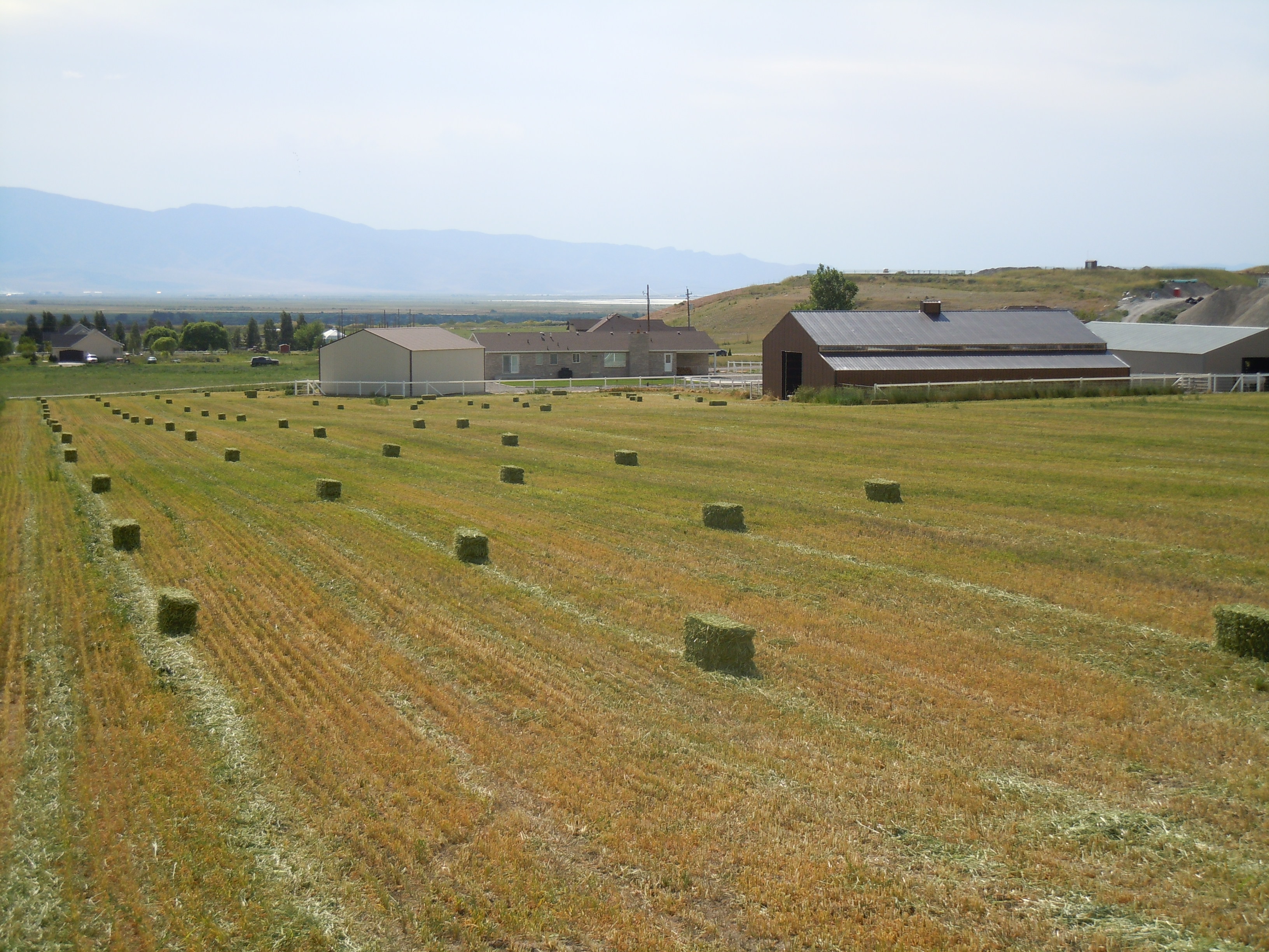

Look how fast the oats dried out after cutting/baling last year. 3 days total time. I am only 70 miles from the Bonneville Salt Flats so it is dry here.

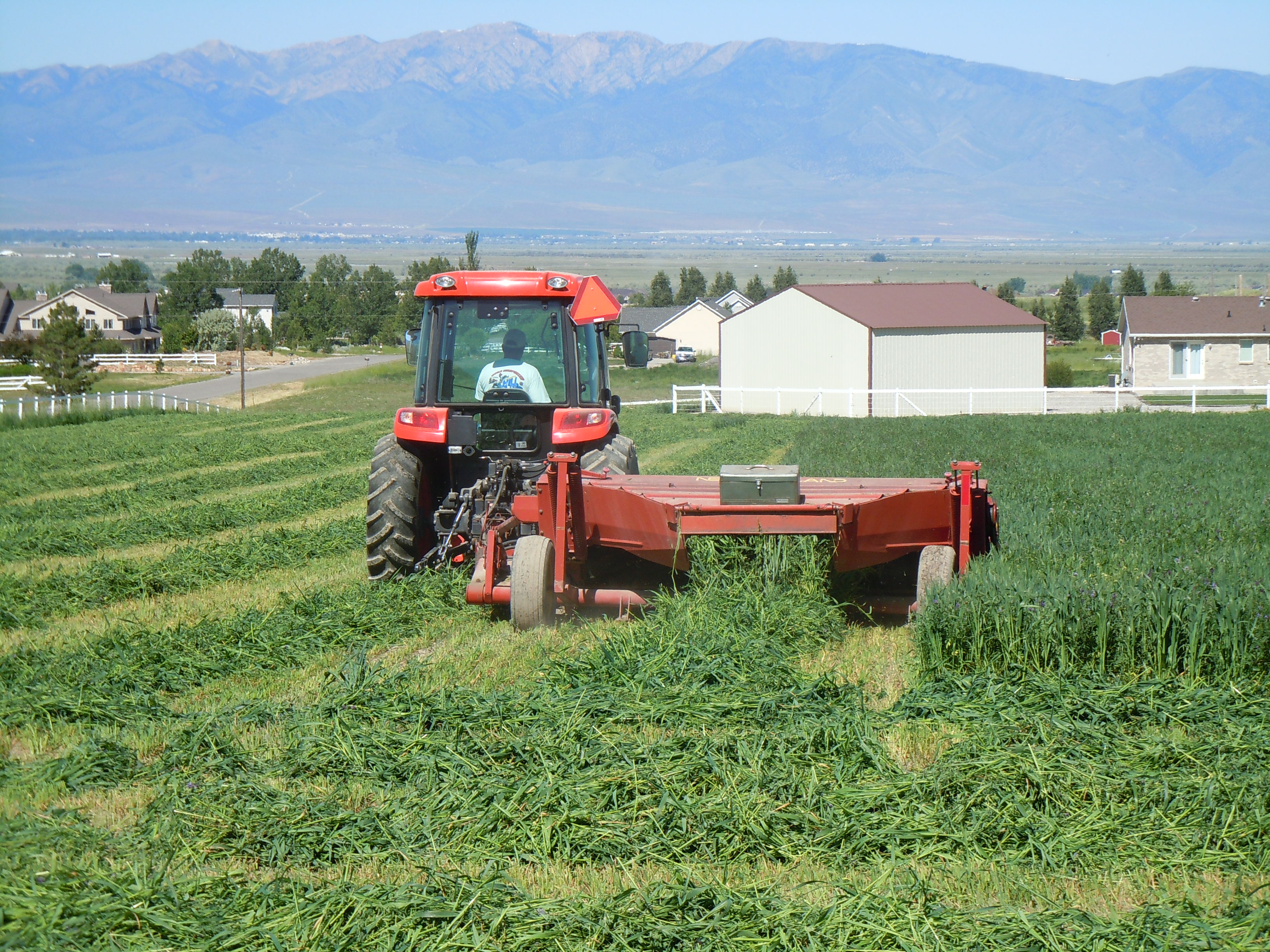

I just got back from a hay conference. Technocrats will always be different by area. I'm in Utah where it's dry heat so hay dries quickly. I have a rotor and it has a conditioner. It's a dream compared to a sickle swather.
At the conference they said that you should cut it spread out and let it dry a little, then rake it together in the morning so you don't shatter the leaves and it cuts down the drying time.
A lot of farmers were against raking. If you rake Alfalfa above 45 percent moisture then you won't lose a lot of leaves... Rake it when it's dry and you're just messing up your hay.
