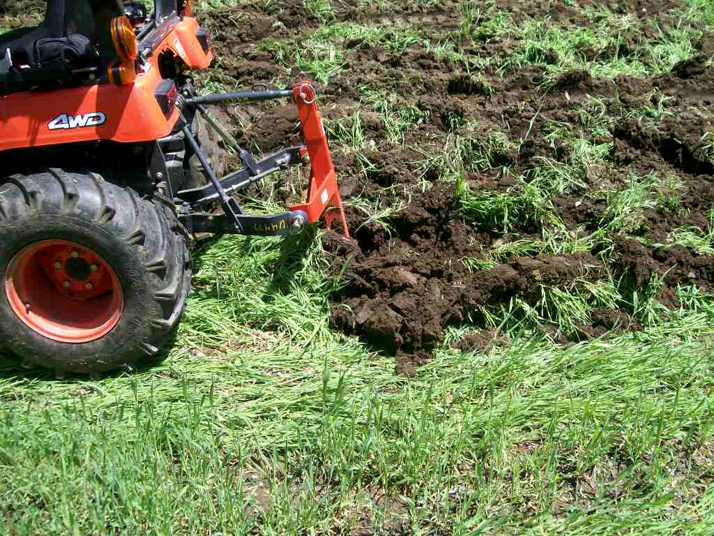

Have about 1/3 acre plot in the back that I have wanted to break up and eventually plant, ever since we took possession of the property last spring.
Today, after church, we stopped by TSC and sprung for a middle buster. By the time we finally got home and laced it up, (yard sales) the shadows were lengthening. I took my time and took it easy, as I didn't know what to expect from my new BX1860 nor the plow. The area is virgin soil and the sod was pretty thick. Thank goodness, I hit neither root nor rocks, which surprised me, because I hit both with my walk behind rotor tiller when putting in my garden last spring.
The plow can go so deep that it has the ability to bring the 'Bota to a virtual halt, but if you take it in 6" bites in depth, you can work it down to a good foot deep. I passed over everything twice.
As I hosed off the BX it occurred to me that I could never have broken that much ground in the 45 minutes I was in the seat with my walk behind rotor tiller. Additionally, the tractor was certainly easier on this 57 year old body.:p
As I put the tractor back into the shop for the night, I was grateful. This is precisely why I got it in the first place. Still smiling.

By extending or retracting the upper arm, one can change the "pitch" on the plow. I would be very interested in hearing from experienced users whether this makes a difference in depth and quality of till. I am wondering how this pitch was intended to be used. Right now, I am just experimenting, really.

I adjusted the top link until it would bite and dig in when lowered. It was trial and error for me but maybe there is a better way.

Yes, by changing the length of the top link you can control how agressive the middlebuster is / how deep it wants to go. If yours was setup so it was more vertical, it wouldn't go as deeply as quickly. I also used mine for digging my potatoes this fall, and it worked great for that as well.

Thanks Chuck. Yup, the slight tilt from vertical is lessened, somewhat, when lowered. It isn't quite as steep as it looks in the photo. I have since also extended the top rod to make the position of the plow true vertical when I go at the next 12 rows. Maybe today? :D
I liked the aggressive digging position because it when right through that virgin sod. I had to watch out for going too deep, too quickly though. A less aggressive pitch should help with that. I will report after the next attempt.
I uploaded another pix, to show the rows being thrown. The photo may not show the depth, but these furrows are a good 10" deep.
My hope is that "fall plowing" helps kill the sod and it rots down. I really want to plant this next spring.

Well, I promised I would report on additional plowing with adjusting the the unit to true vertical and thus, making the plow point almost true horizontal.
The cutting was much easier to control. It stayed on level. But I couldn't say the result were that much different. But after doing both the downward tilt method versus the level plow method, I would have to vote for the level approach as easier on both the tractor and the operator.
