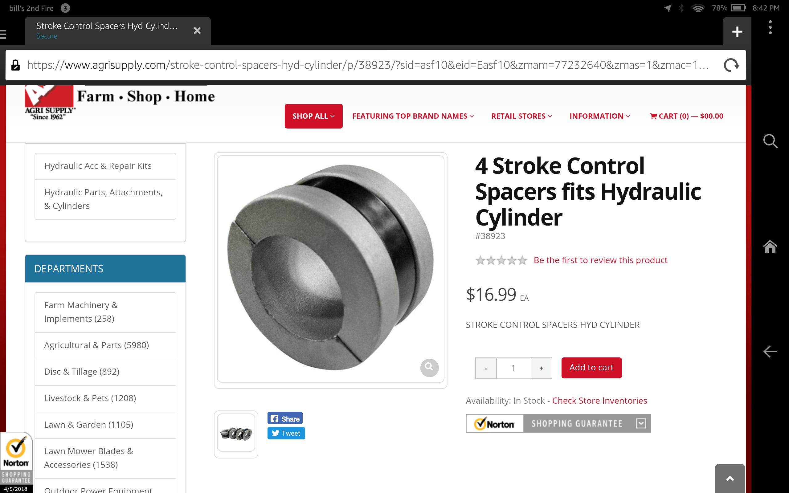

PhysAssist had asked back on page 2 for pictures of how I plagiarized from a user here a quicker FEL connection as I had mentioned I take the bucket off but leave the FEL frame on when I use the MMM and thought of it while in the shed this weekend..
/ Mid mount mowers #42
