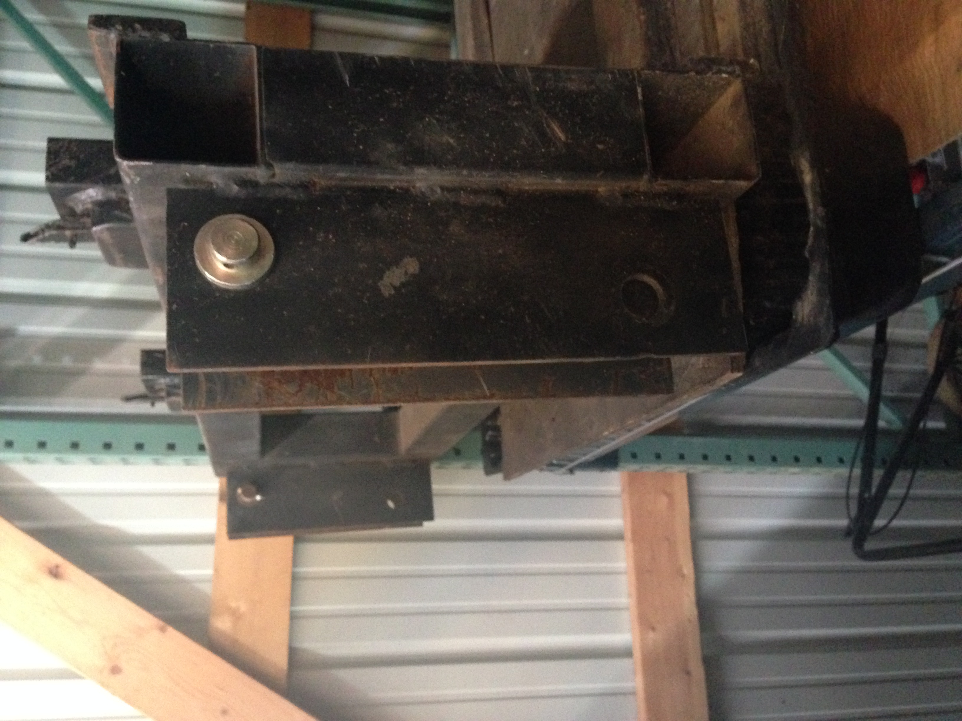

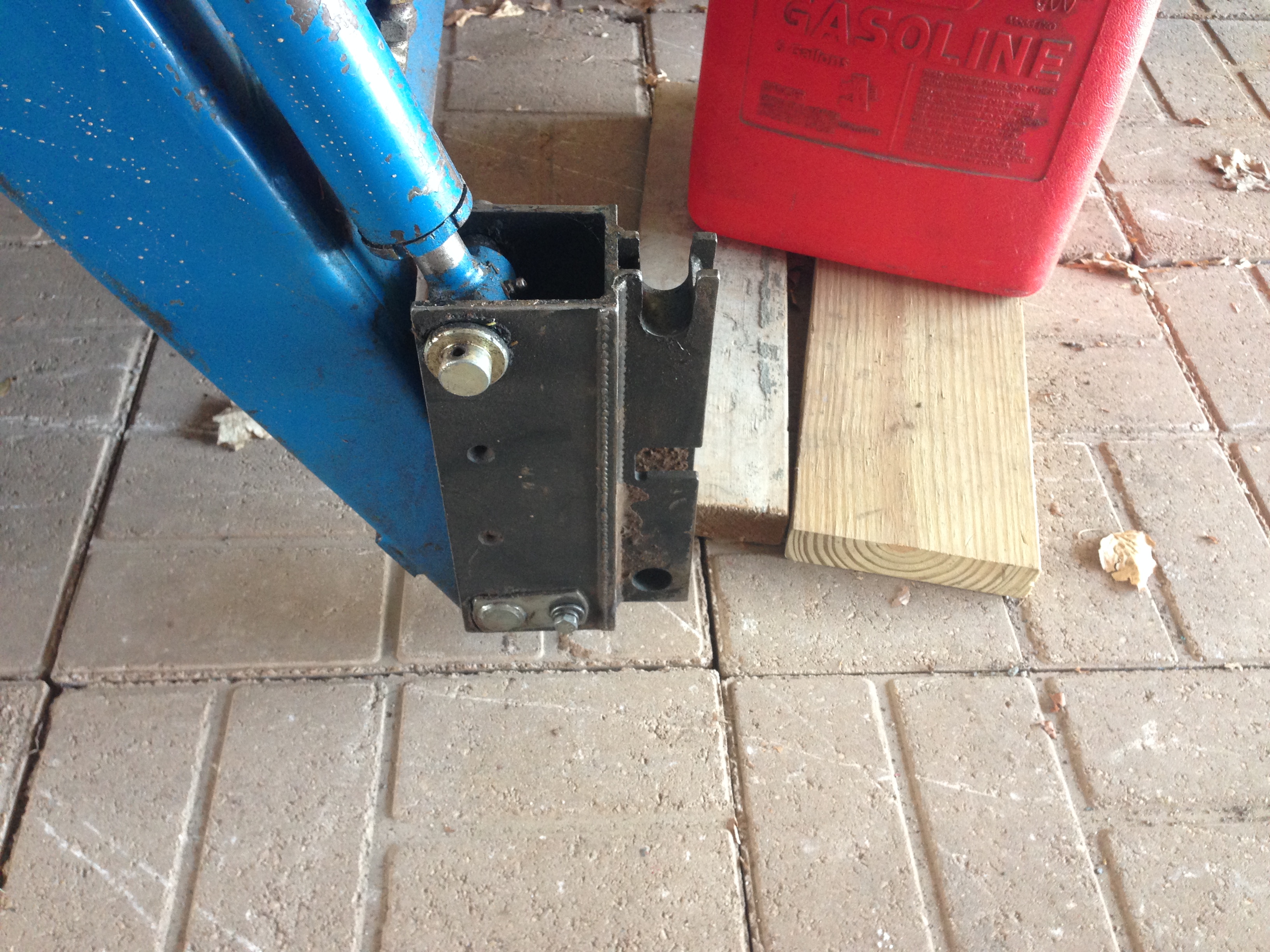

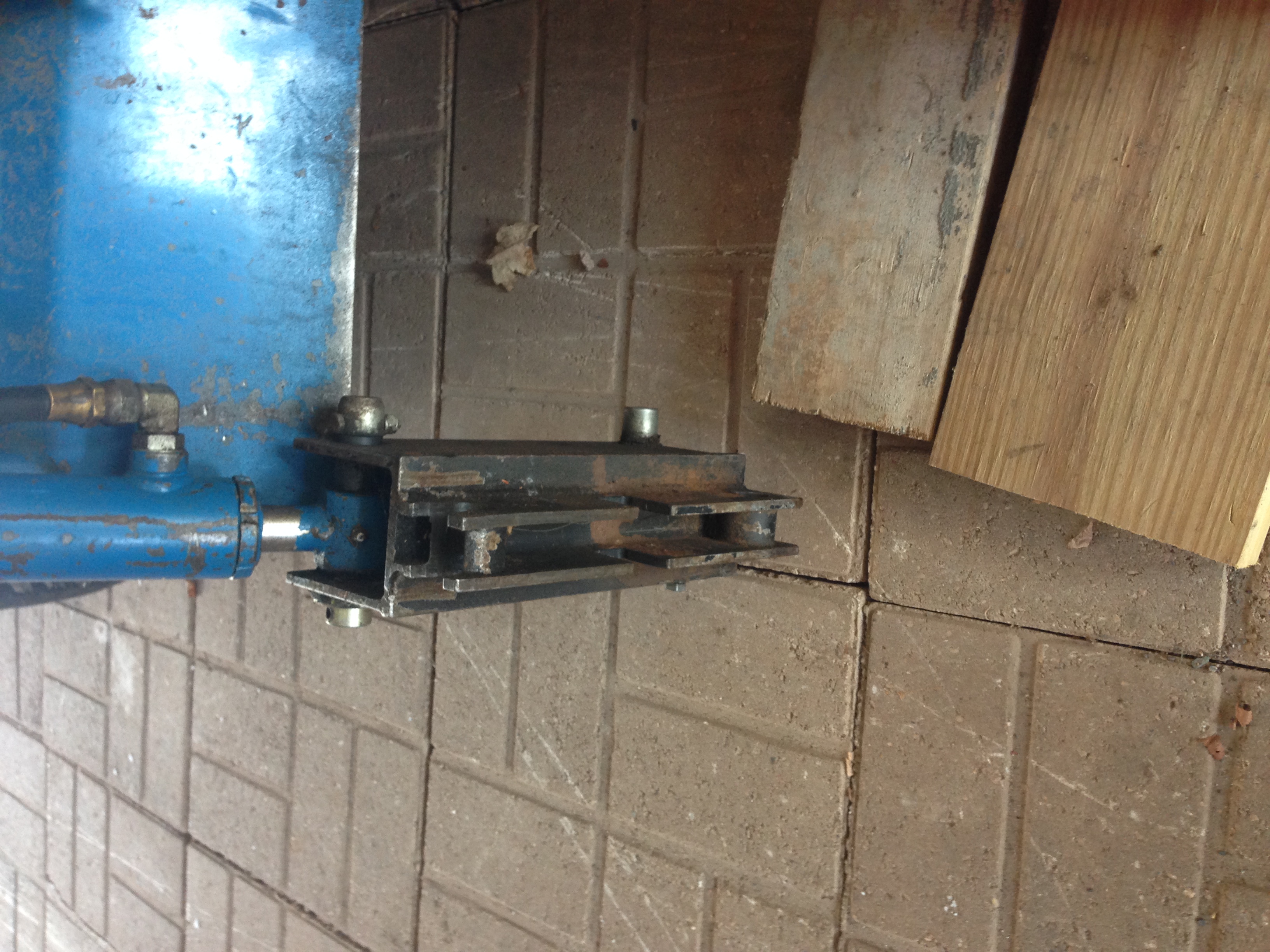

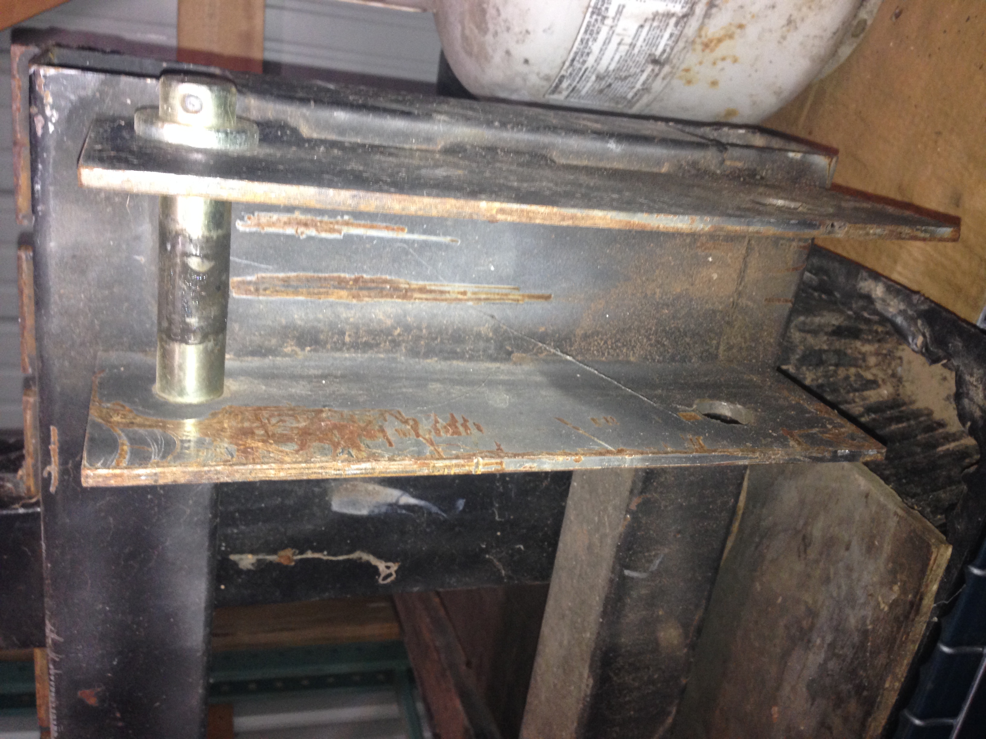

was out in the garages yesterday so grabbed some pics while everything is quietly resting waiting for the snow to melt..IMG_1533.JPGIMG_1534.JPGIMG_1536.JPGIMG_1537.JPGIMG_1538.JPGIMG_1539.JPG
