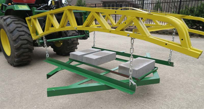

Land planes are wonderful at leveling. However for a driveway, you usually want it crowned. This is better done with a rear angle blade.
Land planes have the angled blades so it pulls in one direction and then the other to level out all the low spots. I built my own out of angle iron and, while not very heavy duty, has done very well for leveling loose material.

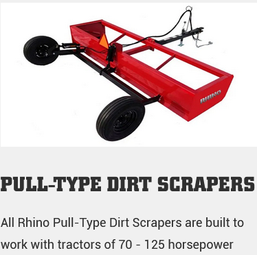

I'm thinking I might like the land plane idea.
wonder if any have adjustable blades?
25 years ago, I bought my first tractor (used) and the dealer sold me a new Rhino rear blade. With the blade, he convinced me to include side plates and a rear gauge wheel. I can't tell you how many times I have thanked him under my breath when I have used it. I think you understand that the problem with a box blade, and sometimes a wheel-less land plane, is that they can dig and gouge. The solution is a set of wheels on both front and back of the blade. This is what a 'gauge wheel' does for a rear blade. Below is a small image of what I have (couldn't find a bigger picture). This is from Rhino:
The benefit of such a blade is all of the possible movements: blade material left/right, blade angle up/down, adjust gauge wheel height. Mine can also swing the entire setup left or right, but that feature really isn't all that useful.
Here is another Rhino product that might help because of it's adjustable gauge wheels:

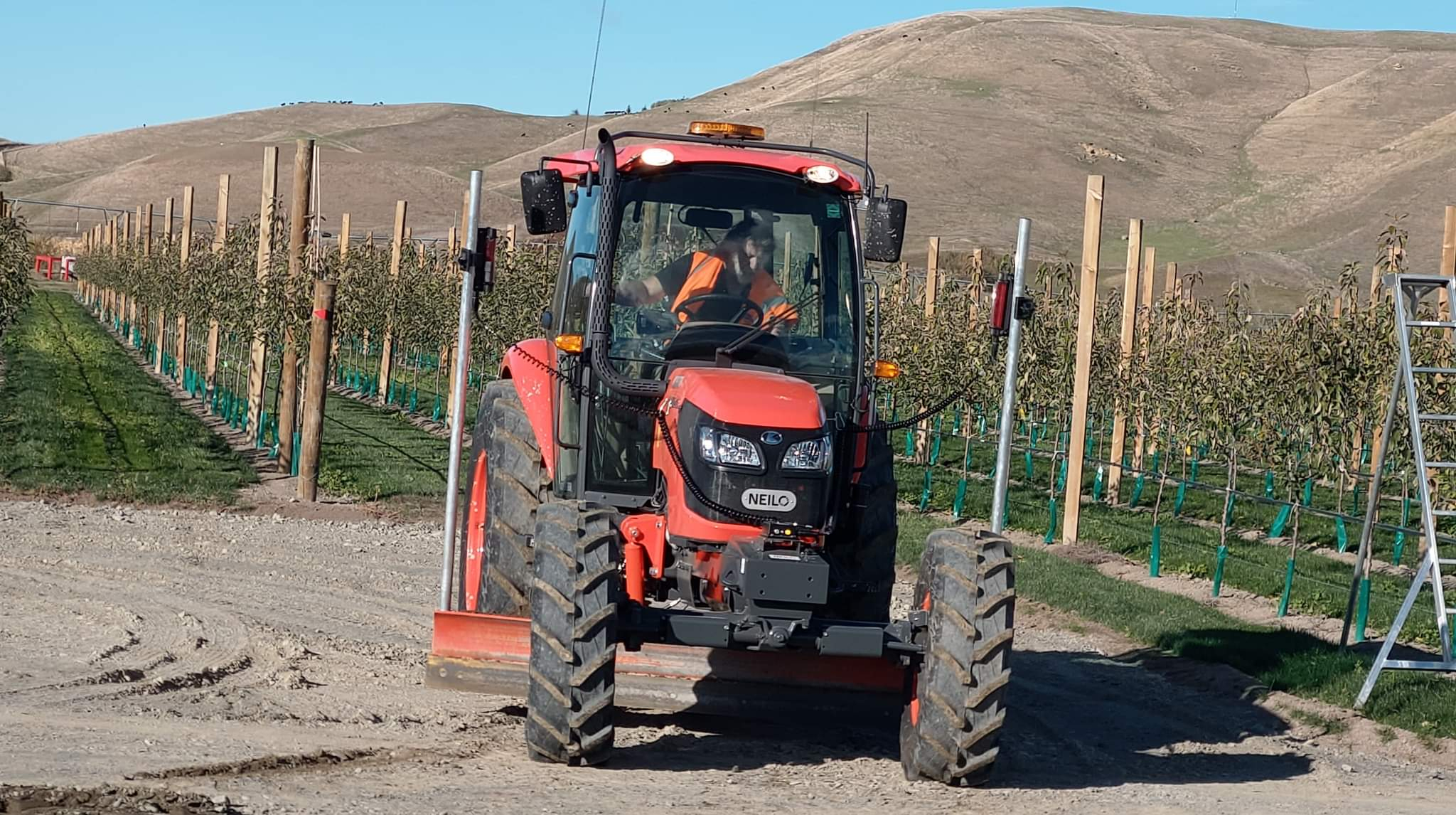

/ Mid mount grader blade ?? #36
Yep they are real custom made machines this is a 2021 model

They are extremely useful for finishing. You don't need a tall blade or high ground clearance. If the plan is to move large amounts or cover a large area, more capacity is needed. But for working a driveway or parking lot, they are great. A front or rear blade must have extra wheels in order to do a quality job.
