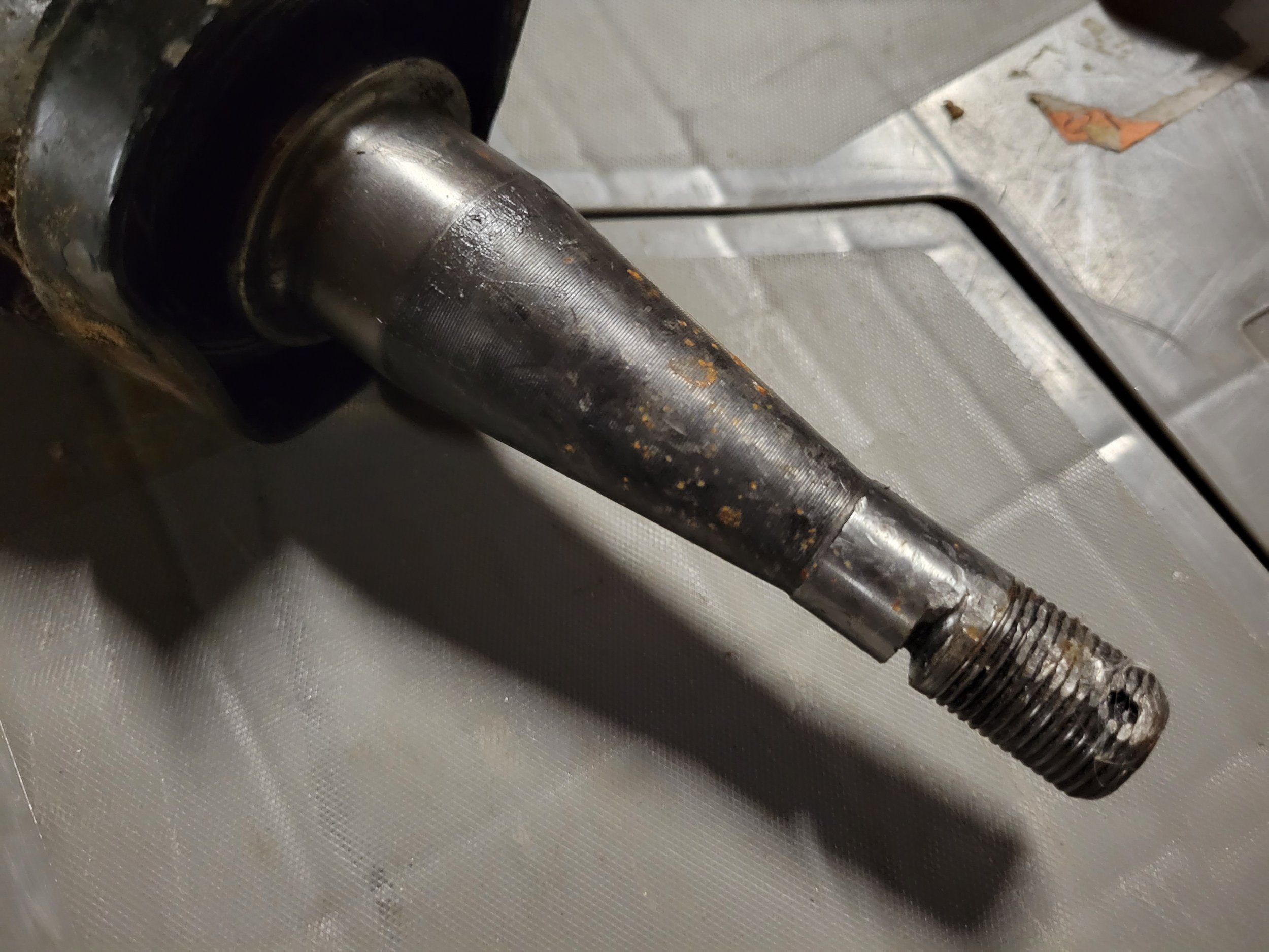

Hello everyone new guy here. Have a low hour tractor that's useless until I can get front spindle replaced. Dealer says don't make em anymore and every salvage yard says nope. Getting frustrated have round bales to move and sell. Might have to start looking at different models for a replacement.

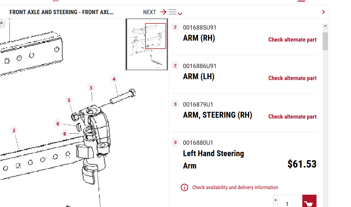

You would think being a 2005 this wouldn't be an issue. The bearings came apart and the hub wore out a section of the spindle where the front bearings go. I don't know if that could be successfully welded so that the bearings will roll smoothly over that area. I have tried google and all the yards that come up. I can check the one in PA. I even tried looking for a salvaged 431.I'm in TX. I've already spent considerable time calling yards etc. the ask agco yet is a resource worth checking out.

That can be fixed by a machine shop/welder..
They would try to weld as is or just cut it off and weld a new stud with threads on.
/ MF431 front spindle #6
I agree with Redtop -- but is anything else ruined? Do you have or can you get the bearings and rest of the assembly ? Certainly a good machine shop can rebuild that pictured part but they may also be able to simply make you one. Looks like it was probably made on a metal lathe. Let your experienced machinist speak to those issues but be sure you have ALL the damaged parts and present the entire picture. Good luck. From a cost standpoint I'd still beat the bushes a little harder on used parts -- Wengers in PA is one of the largest and are often quite good about pointing you to other sources if they do not have one.
If there is nothing else major wrong, I think Redtop may have the easiest (and probably not very costly) solution in cutting off the tip and welding a on new one having been threaded by the machinist. I don't think we are talking high precision here, just fit and function.

E-commerce dealers show it as backordered, $344. if they could get. They are still available in Europe, €252., but definitely could be repaired.

I agree, independent machine shop can pix that. Or depending on how that spindle comes apart....possibly just make a new one?
IS there a picture showing how the spindle is attached? Is it welded to the vertical member?

Nothing else ruined but the bearings I was able to pickthose up at auto parts store. I'm going to run it down to the weld shop tomorrow and see what they have to say.

Long story short I got the part from a salvage yard. Machine shop said they couldn't fix to close to the threads.

I was beginning to think I wouldn't be able to find one. A yard in Alabama contacted me. Southern tractor.
On the shop yeah I don't think they wanted the risk? They said if I could find one that was close in dimensions they could machine it for me to the exact size needed.
