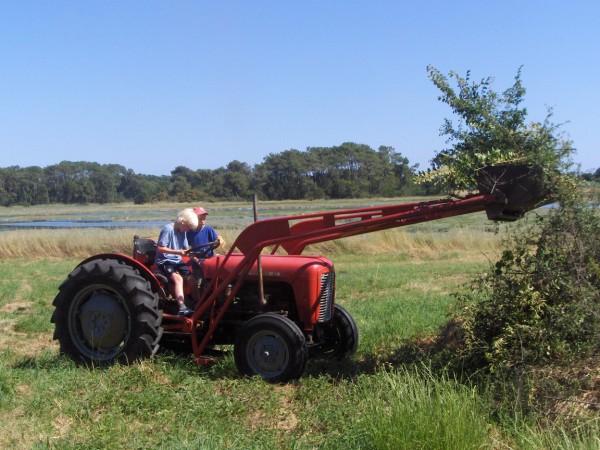

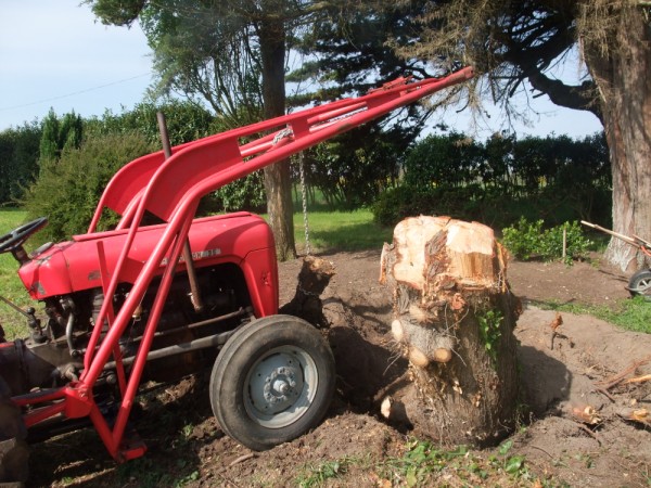

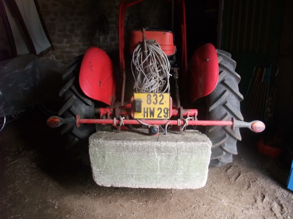

You will love the beast, always ready for work and fun.
