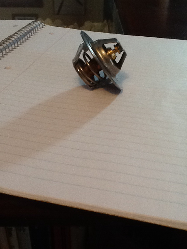

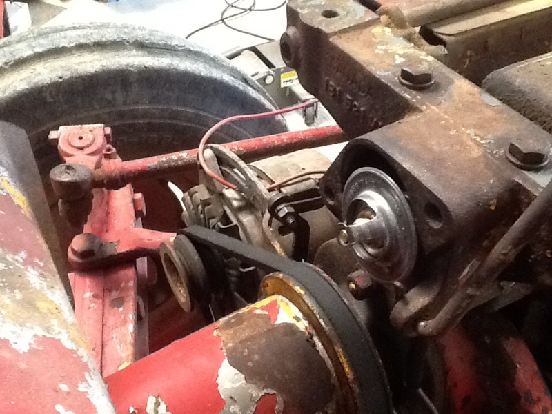

Wanted to change out thermostat on the tractor. Took it apart and lo and behold no thermostat. Ordered a 160 degree thermostat and thought I put it in the right way. Refilled radiator and ran tractor. Ran for about 10 minutes turned it off and fluid started leaking out of radiator overflow tube. Not a lot, but I never saw this before putting the thermostat in. Do I have the thermostat installed in the correct direction? I did check the thermostat in a pot of hot water and confirmed it does start opening at 160 and looked to be full open by about 180.

/ MF35 thermostatt install #4
The thermostat in the picture looks a bit odd in design, I'd like to see both sides before I could say how it goes.
Here's what the whole thing looks like.

/ MF35 thermostatt install #6
One more time. The coiled wire goes TOWARDS THE HEAD!
/ MF35 thermostatt install #7
now that we can clearly see the spring its obvious the thermostat was correctly installed in the first picture.
Why did it blow the coolant out? Likely a Pocket of air trapped in the head, dose the stat have a jiggle valve or air bleed hole?
If not you can drill a very small hole, install stat with hole at 12 o'clock.

/ MF35 thermostatt install #9
You appear to have the thermostat in correctly. The "round tube" with the wax pellet inside it goes toward the cylinder head.
These radiators are not meant to be filled to the top. They should be filled to about 1/4" above the core to allow for coolant expansion. If you overfill, it will self level itself when coolant is pushed out of the overflow.
#11
Finally had a chance to put it all back together. Filled the radiator just to the top of the core. Did about 2 hours of grading work and no fluid leaking out of the overflow tube. Thanks everyone for the help!!
