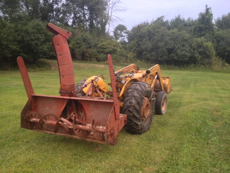

My snowblower is a 6’ McKee Sno-lander 520. As long as your machine runs well and the governor is properly adjusted (very important), it’ll handle a 6’ blower no problem as far as power.
Does your machine have the shuttle shift? (Geared reverser). If so, that’ll help a lot because you can move pretty slowly in reverse. I have the shuttle, so I’m not sure how fast reverse is without it.
With the shuttle, you have reverse in first, second, and third for both hi and lo gears. That being said, for light fluffy snow I can hit up to 6” in 2nd low reverse and it’s not too fast. Real deep or wet heavy I use 1st reverse low.
My blower has a three blade fan in it, 24”. I keep reading that a four blade fan is better but I’ve had no issues. I plan to make an impeller kit for it, as it’s old and there’s a decent gap between the fan and housing. It’ll throw further with the gap closed, but as of now it throws 20ft no problem.

Yep, you got it. General rule of thumb is about 1 PTO HP/ft of blower (same goes for flail mower). If we had a hydrostatic tractor we could REALLY slow our travel speed and keep RPM up to use a larger blower.
I’m the same, we usually don’t get that much snow, but we’ve had a few storms that even with loaded tires, chains, cast wheel weights, AND the 550lb blower on the back i STILL couldn’t get enough traction to move the snow. The blower alleviates that problem.
1st low reverse, RPM pushing 540@PTO, and just chug along through it. Especially useful at the mailbox where the state plow dumps often 4’ of snow about 5’ wide in big storms. I just blow it up the bank. If I plow it, you can’t see pulling out of the driveway. So it’s either blow it away, or remove the plow and bucket it all up onto my property somewhere. That’s too time consuming.
I don’t use it all the time, but the times I do make it well worth it. I can’t remember whether I paid $500 for it or $800. I *think* it was $500.
The guy I bought it from had too fast of a reverse gear to run it in deeper snow, got tired of working the clutch all the time.
