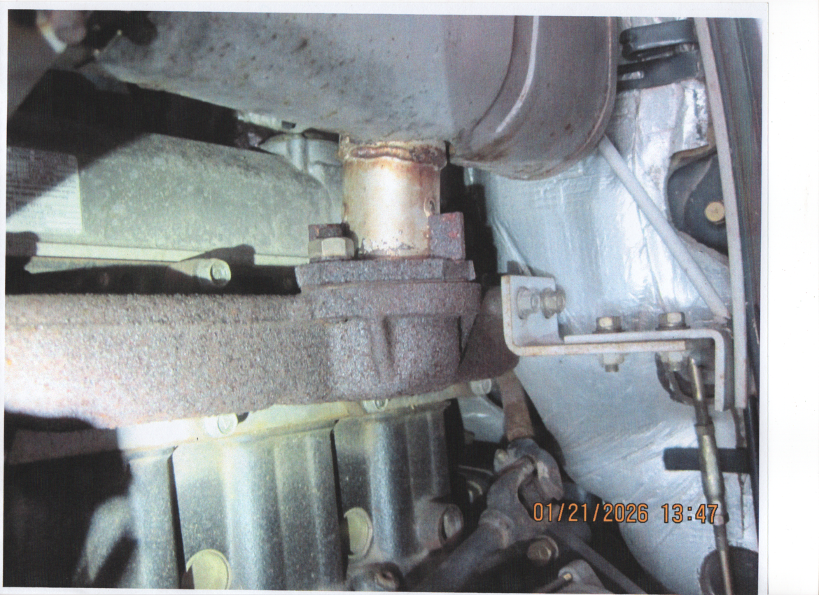

MF 1455 Power Shuttle, 4wd, 1040 FEL
year 2003, engine model #54DD, part #4264400M91 is no longer available! It's a under the hood, vertically exhausted, 4 cylinder, 2.8 L, 55 hp Iseki made tractor for Massey Ferguson. No aftermarket supplier. No response as of yet from my email to Iseki in Japan. A MF dealer suggested I try to make a 1445 muffler ( that's still available) work. Does anyone else have a suggestion as to how to solve my problem. I might go to a Kubota Dealership to see if they use a similar muffler (with slight modifications), like the M6040 or the M5140. I'm going to try and take some pictures and measurements of my muffler set-up tomorrow.

Thanks for the info, that was my next plan. Just was sure what size of muffler or how to secure a above the hood muffler. My under the hood muffler is bolted to the engine in 2 places.
/ MF1455 muffler replacement
Seems the Kubota under the hood and vertical exhaust pipe muffler, have a 4 bolt flange vs my 2 bolt. Looks like I'll have to install a above hood muffler. If I cut off my muffler off where it's welded to the flange, about 3" of pipe will remain to attach enough length of pipe for a new muffler to mounted in it's new location. Going to try to use the old hole through my hood, which will require a bended pathway. Bracing could be added where my current muffler's far end is secured, above this point is where the exhaust pipe would go through the hood. This will be done to help reduce any vibration of the muffler!

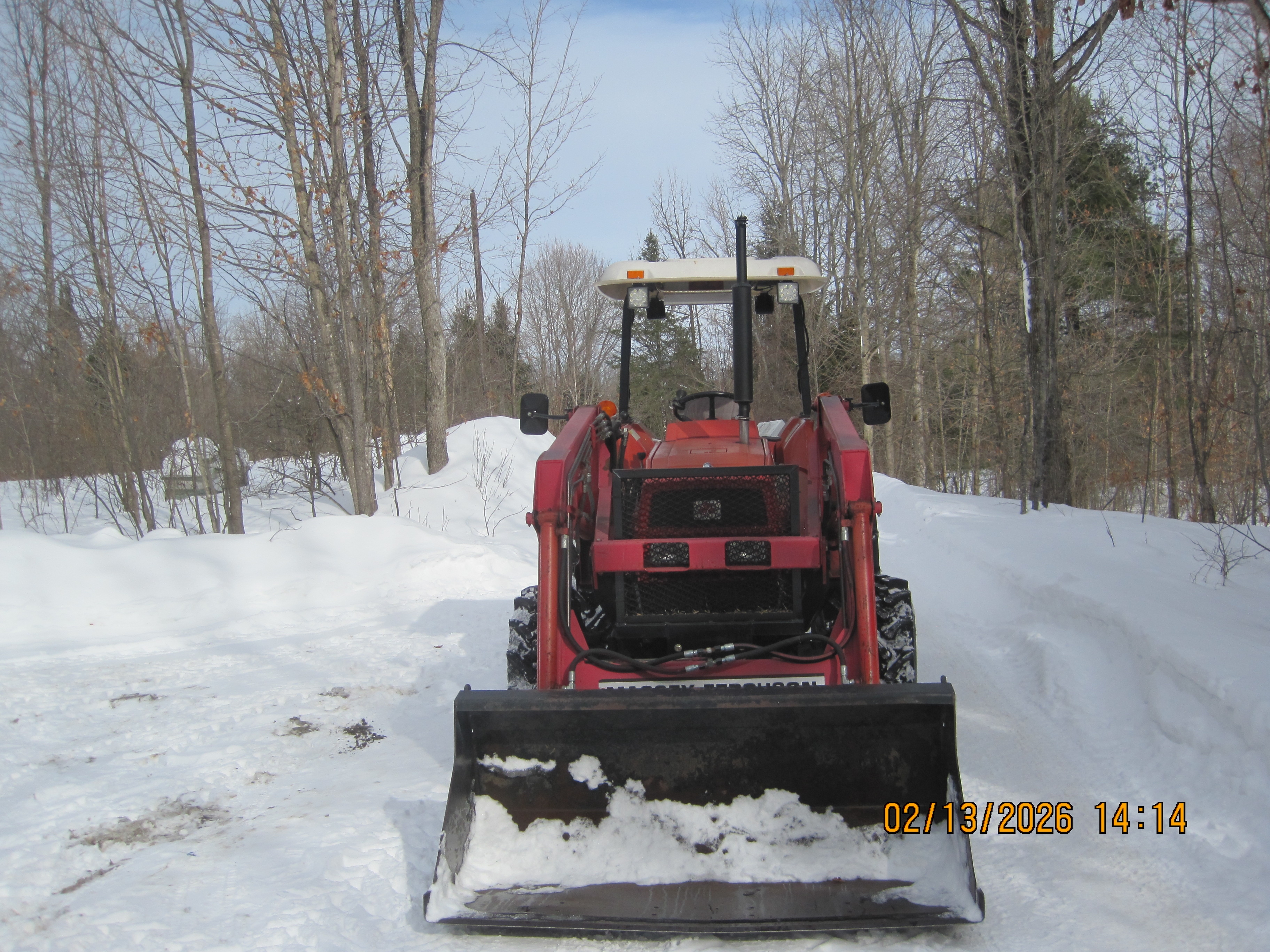

It finally warmed up enough to work outside to replace my muffler, around minus 10 degrees Celsius. The Mf65 muffler part #187184M91 has the inlet I.D. of 1 3/4" that I need to fit onto the 2, 45 degree elbows that made a 90 degree bend, which was welded to the flange (I cut off my old muffler). This allowed me to use the old exhaust hole thru my hood! I also braced the bend using the old muffler's second attachment point (somewhat right below the top hood's exhaust hole). I McGyvered the brace from stuff I had salvaged from our local dump, not pretty but it works just fine. So far the exhaust keeps from reaching me under the canopy, probably due to the muffler assembly being a nice height, I don't plan to go thru the bush, the canopy alone makes it difficult! Now I wonder how long this new muffler assembly will last, probably not the 23 years the original did.

Fantastic retro fit repair. Good for life of tractor. Exhaust up and out of your breathing area. Great job!
