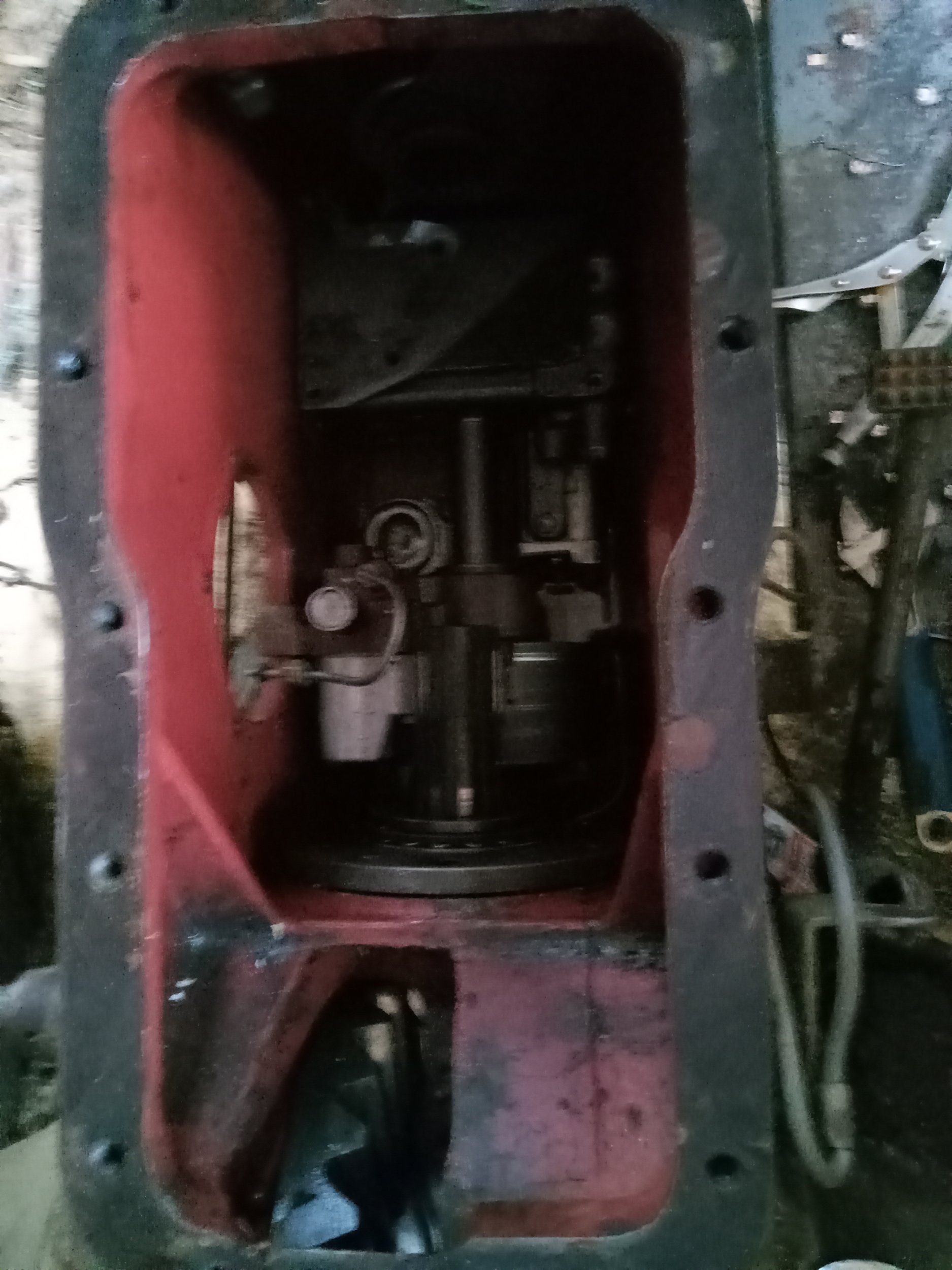

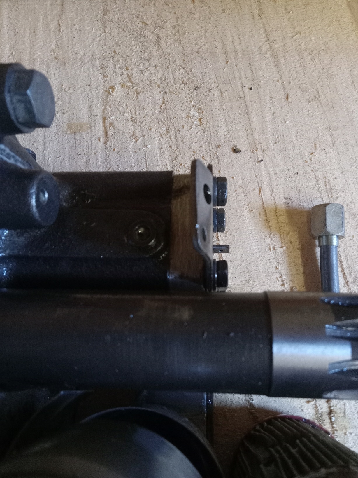

I have a MF135 that I'm into a hydraulic pump/ PTO clutch repair on. I'm having trouble figuring out how to remove the hydraulic pump/ PTO clutch and it looks like they have to come out together? Any know-how appreciated.

   / MF135 iPTO/ clutch removal #2
When I do it I split the tractor between the transmission and rear housing. I don't think it comes out the top.
Thanks Harry

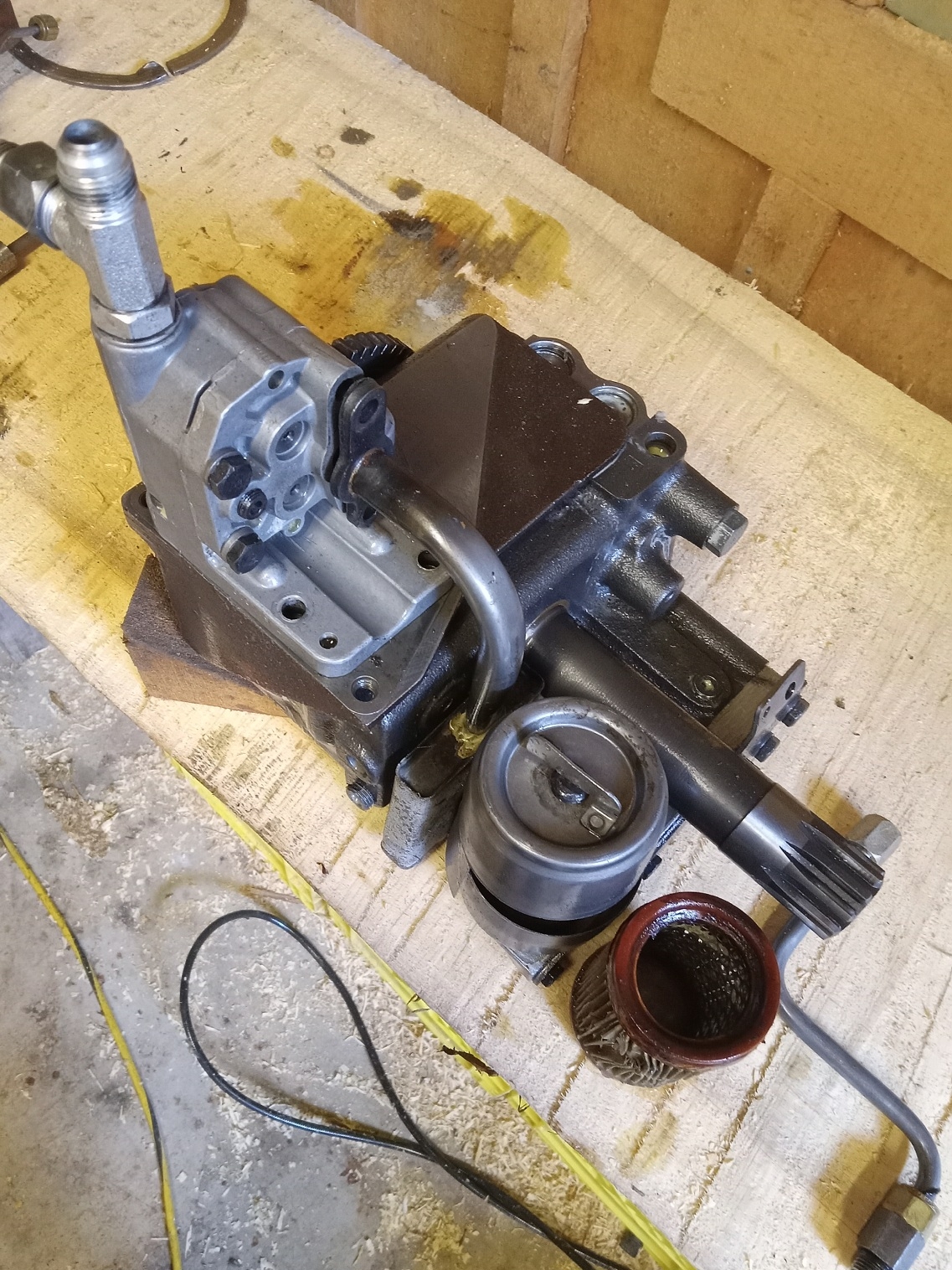

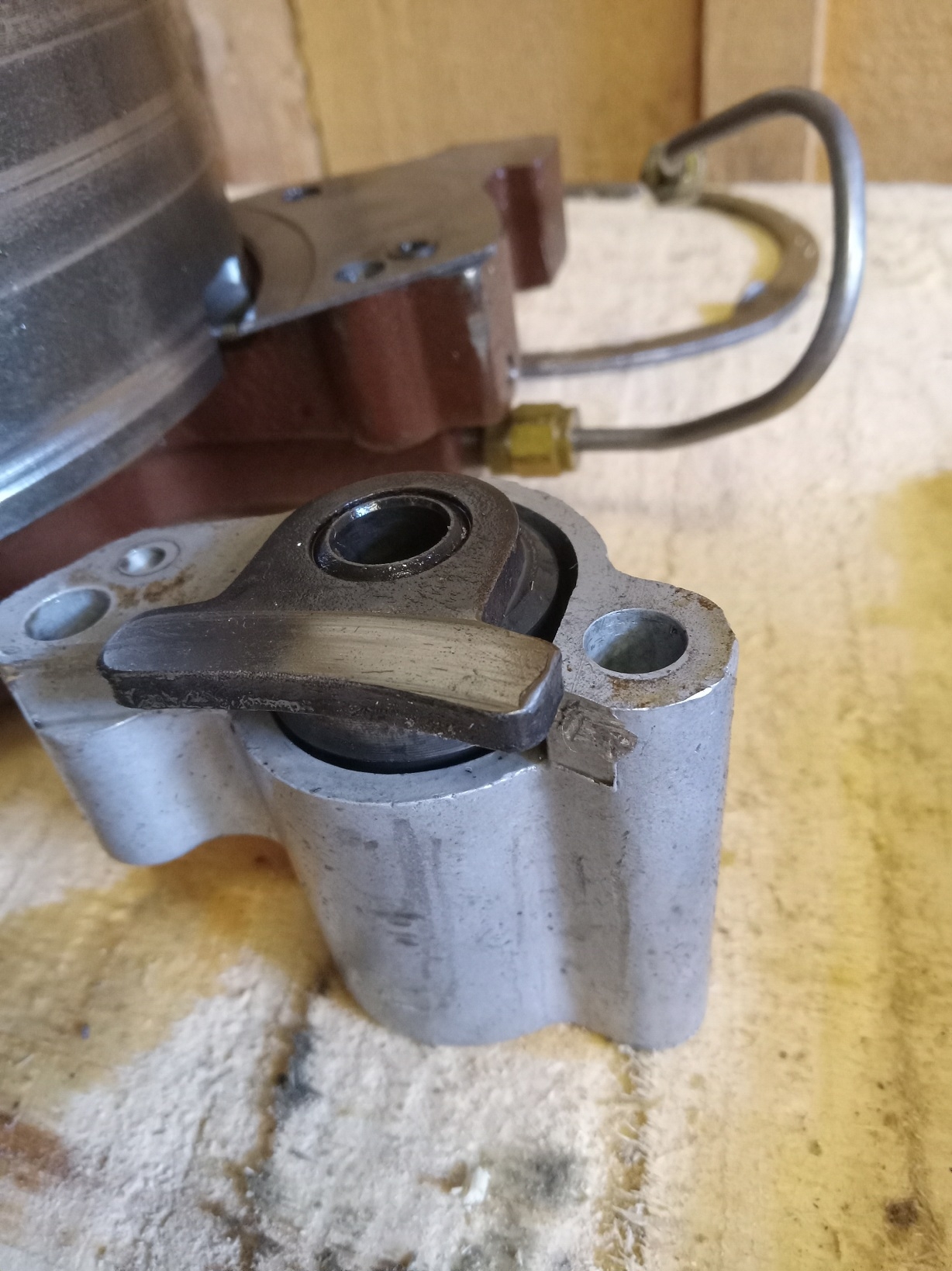

As this mf135 is new to me and I'm kinda out in the middle of nowhere, I really appreciate any help on next steps with this one. Since I've had the tractor, the ipto hasn't worked. I just picked up the service manual and I'm trying to work my way through getting things working again.
I have the ipto clutch, Ferguson pump and the hydraulic pump (9gpm) on the bench. Here's what I've found so far:
Ipto clutch -

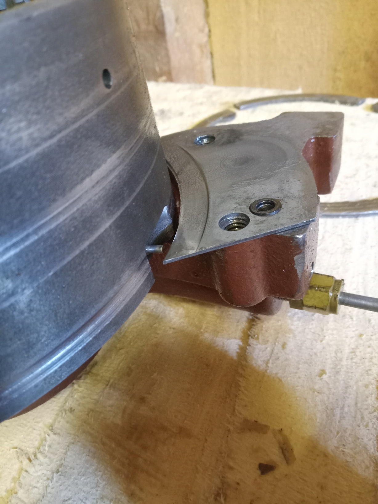

Brake disc - broken in 4 pieces
Plate (in brake assy) - unevenly worn

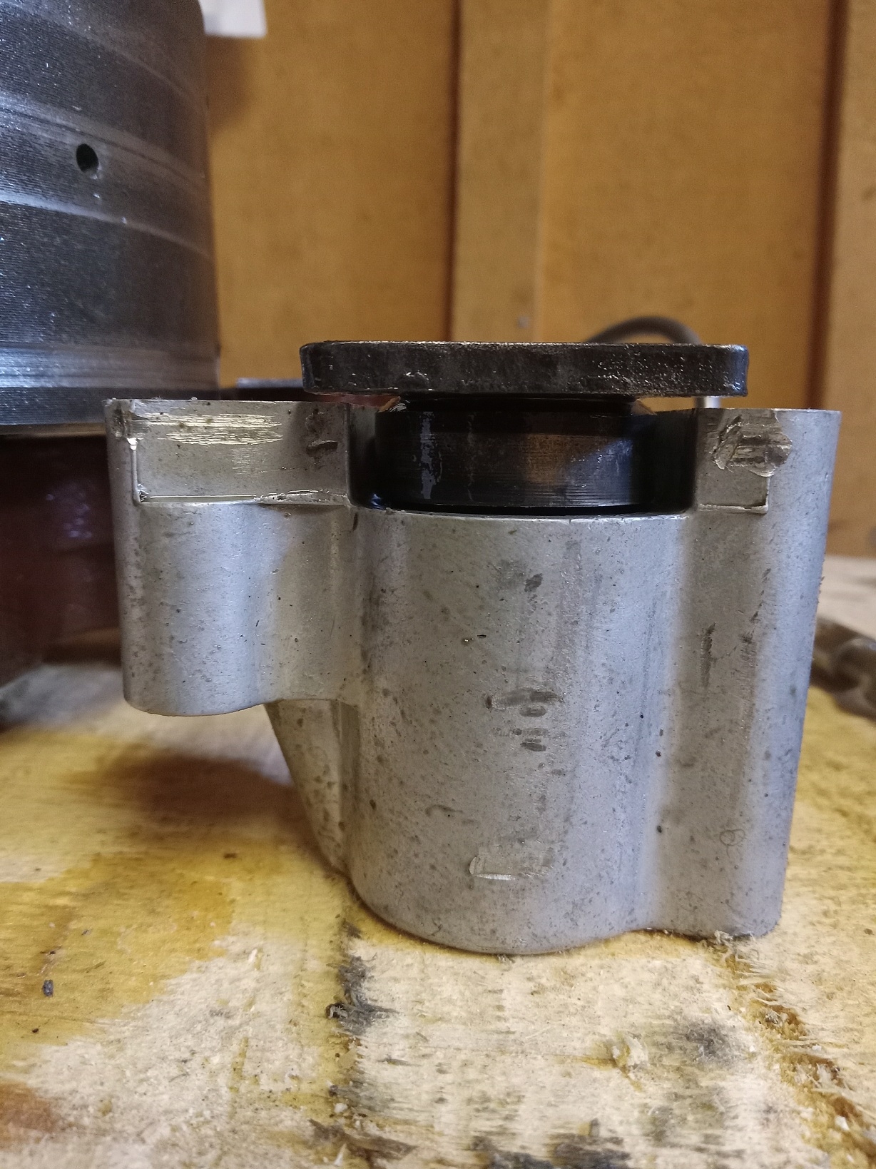

Brake piston - 1 edge is mushroomed over and looks to be bent
Clutch housing - heavily scored, where brake disc sits
Wave spring - missing
Hydraulic pump -

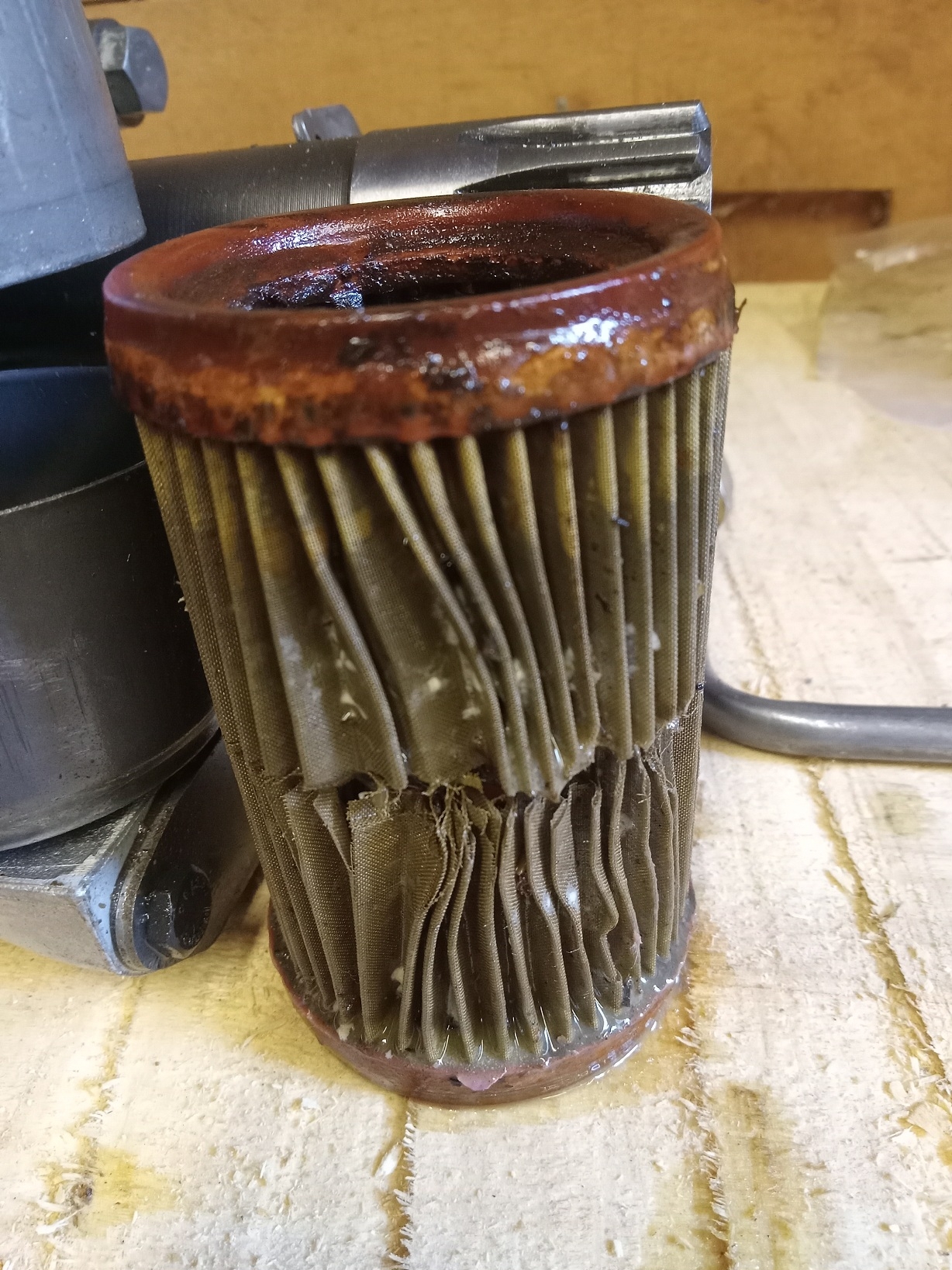

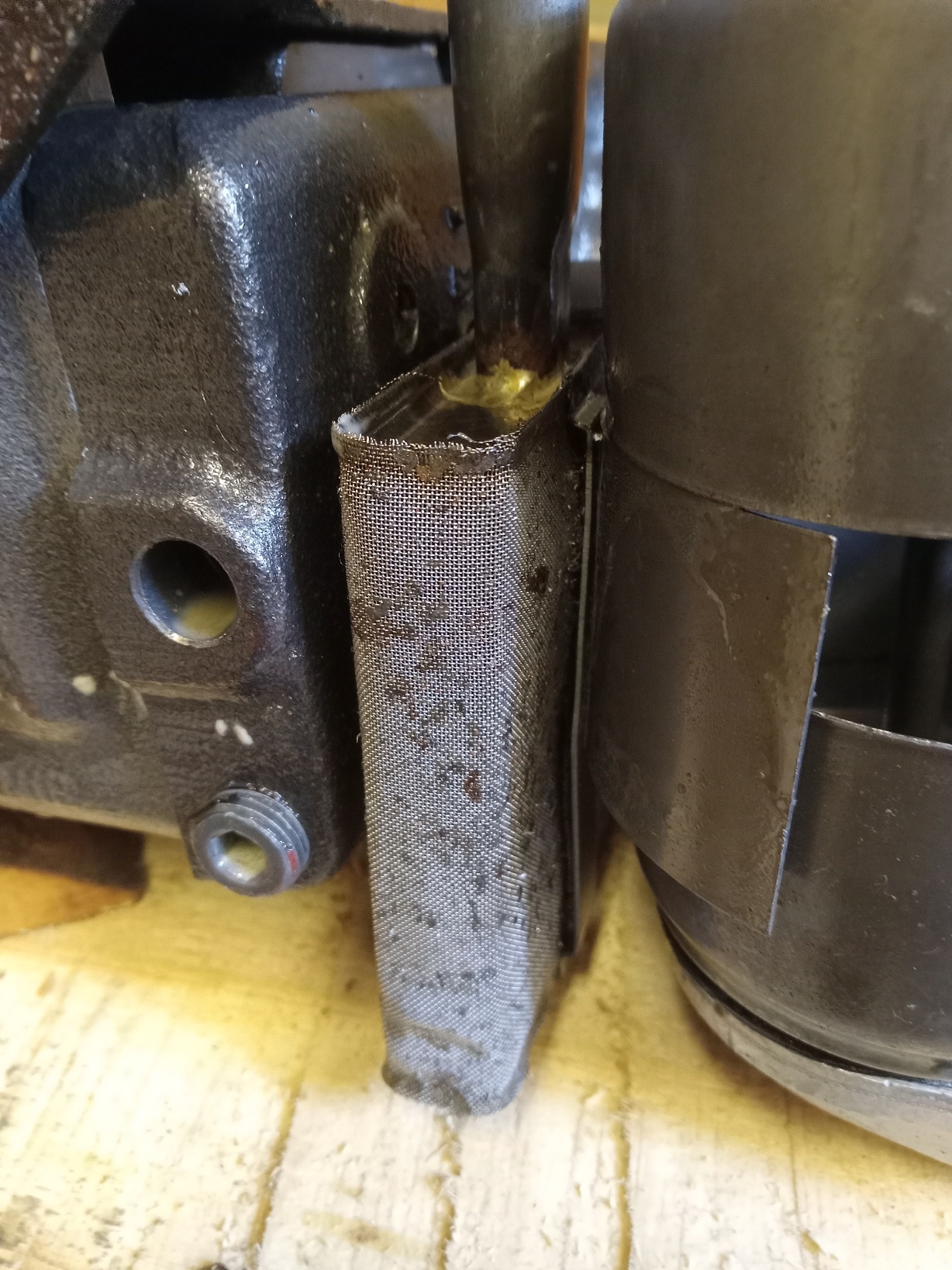

Filter - heavily plugged with fouled oil and metal filings

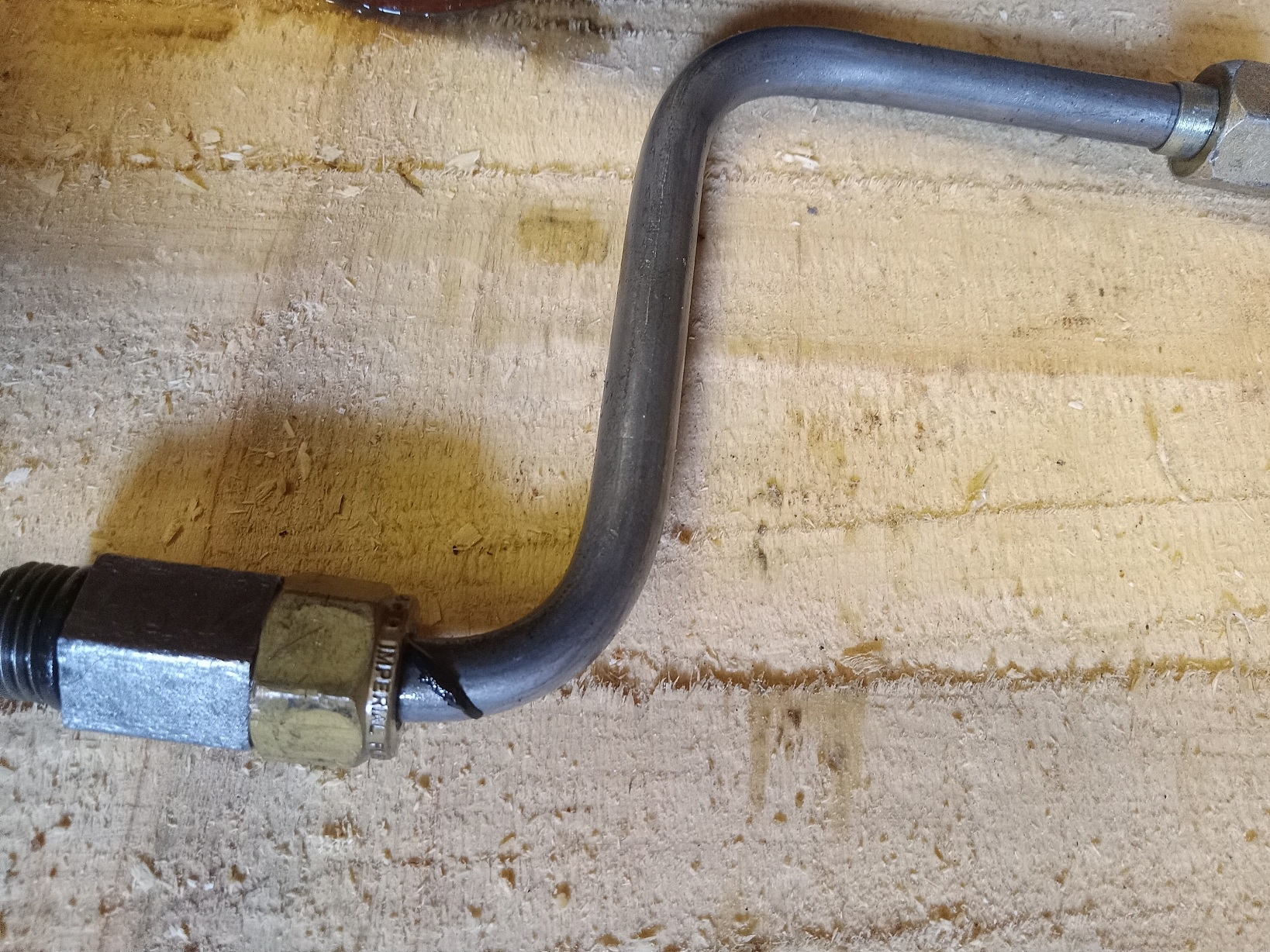

Primary oil circuit line - blown o-ring
Ferguson pump -
Filter assembly - hole torn in Filter
Control valve lever mounting plate (?) - bent towards front of tractor
Should I be looking to replace the entire ipto clutch or just rebuild? Replace scored clutch housing?
Is there a way to bench test any of these components before reinstalling?
Thanks
