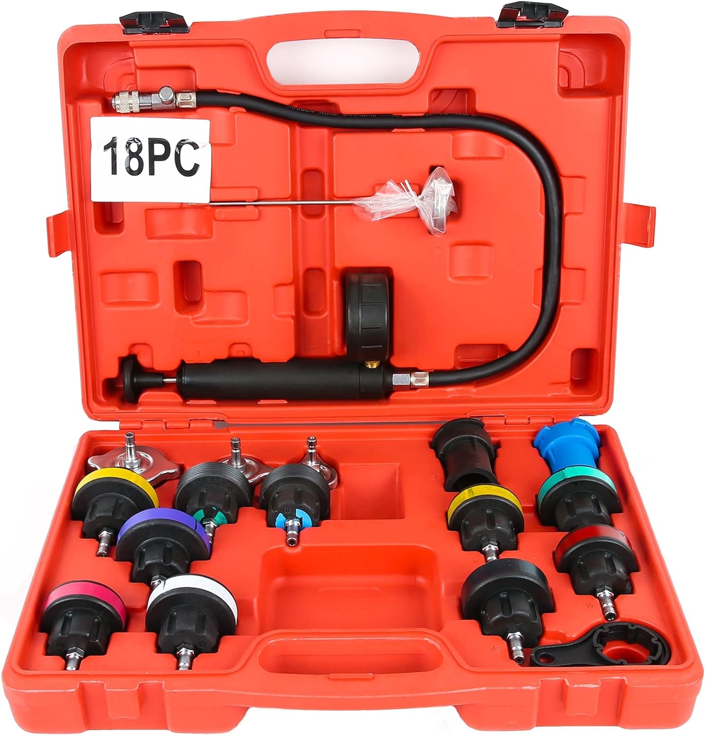

that this one? the ZJERYL GULL 18pcs
I have saved in list to purchase
That looks almost identical to the one I suggested. Different brand. The one I bought bought back in December 2022 had 4 chrome "radiator cap substitutes" in the kit and these now only show 3. A couple of hours ago Amazon said the one I got last December was no longer available and that's why I substituted the one I showed a picture of. So these newer kits lean more toward the "fit inside the radiator neck" style adapters (which no doubt work OK too) but I was real pleased that one of the adapters that screwed on looking like a radiator cap but with a vent on top fit mine.

Local Advanced Auto has a tester I'll grab tomorrow. Basically you buy it then get a refund when you bring it back. Theirs is a ridiculous $270 though lol
Dear lord do not spend that kind of money for one.

Got the pressure tester and my radiator has a leak. I noticed some corrosion at the spot but never any moisture but by 5 PSI she was spraying. I'm not super mechanical but I assume this would account for all the symptoms and take care of things?
One dealer told me it was discontinued and he couldn't get one. Another pulled it up by serial number and said MF did offer them and quoted me $820 plus tax.
Anyone have a cheaper source?
