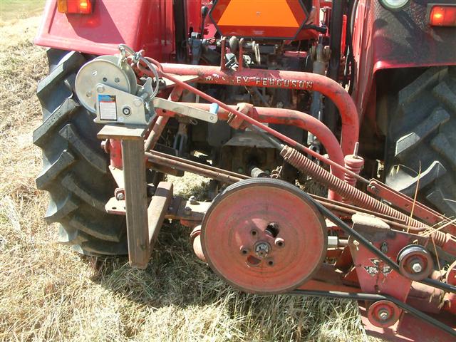

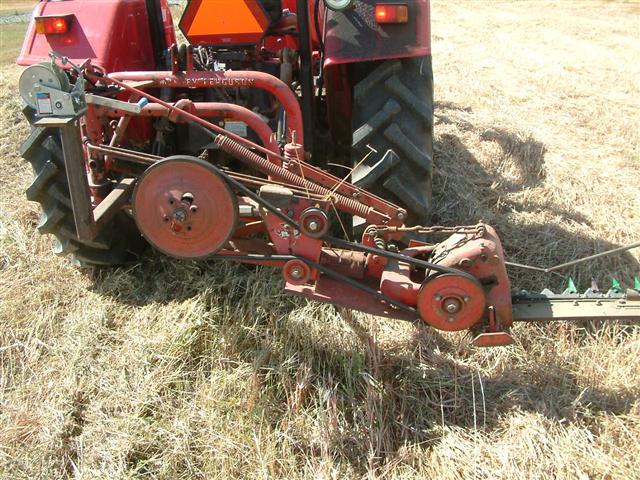

Here's my MF31 sicklebar for comparison

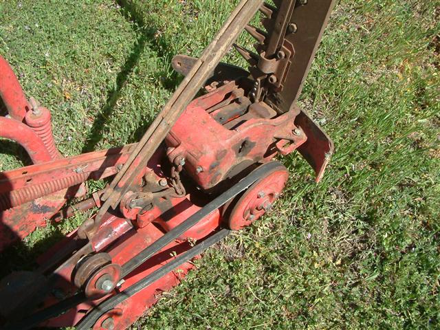

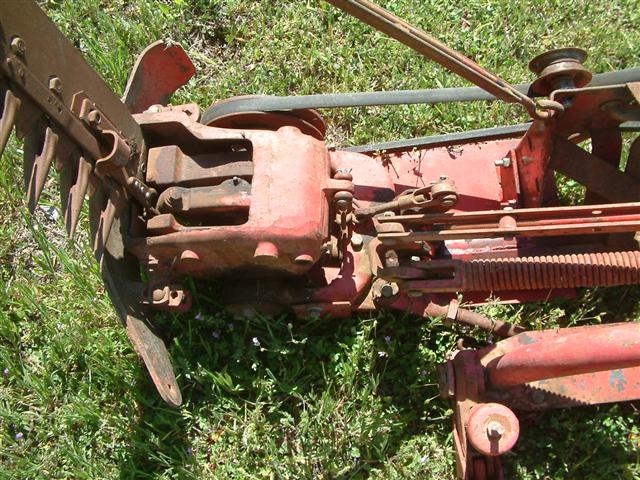

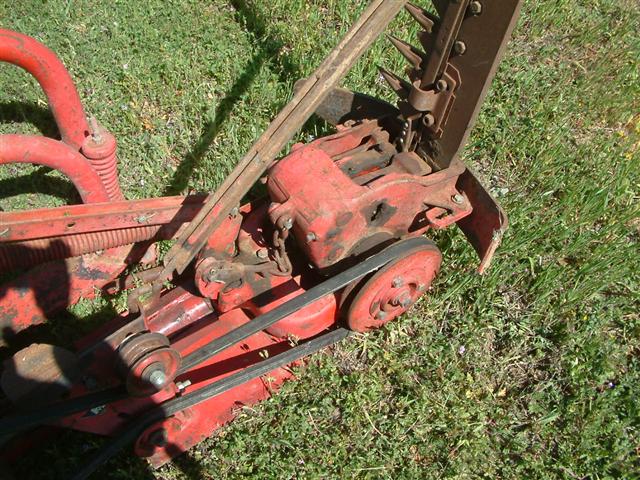

The major differences between the 31 and 41 are in the drive unit. Here's the 31.
/ MF sickle bar mower ID PLEASE #7
If the head is a welded up drive head, it is a 41 and if it is a cast housing, it is a 31. The belt drives have about a 102 inch C belt on them. If there is no play in the head and no breaks or welds and the driveline is good and the sections and rockguards are till good. $600 is a great price. Ken Sweet
