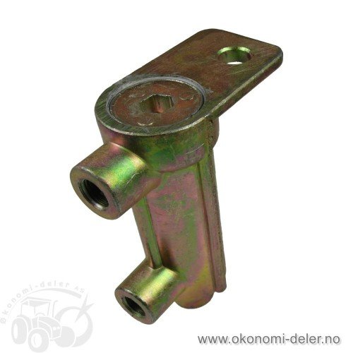

Regarding the starting aid. I would like to get it operating if it is not. If you know of any tips on diagnosis please let me know. I am guessing that it would make some noise if I fire the heater with the engine off?

If it works you can hear poff sound when it ignites, often the small tank that are feeding it full of junk.
/ MF 35 Perkins White Smoke
Mine looks to take a fuel line right off the main tank - is there is a sub-tank inside the main tank for the heater?
/ MF 35 Perkins White Smoke #8
/ MF 35 Perkins White Smoke #9
The preheat circuit uses return fuel from the IP. It fills up the small canister while the tractor runs and the excess bypasses right back into the fuel tank. The preheat setting on the ignition heats up the glowplug and the heat also opens a thermal circuit that allows the diesel from the canister to flow thru the hot glowplug, thereby igniting it and allowing it to pass into the tractor's intake. It makes a big difference in ease of starting if it is working properly.

Thank you for clarification. I do have that part. Once I get the tractor inside to start working on it I will remove that little tank and clean it.
