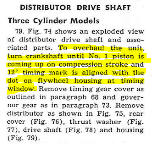

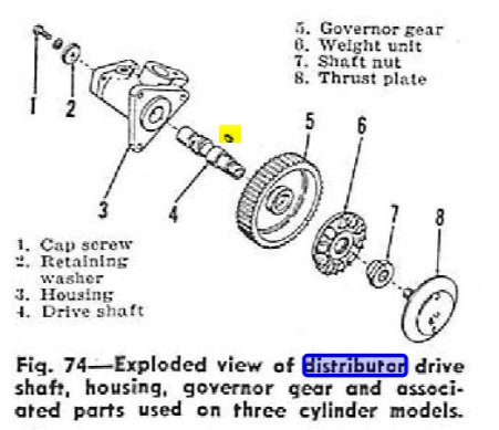

I have a good lead on the distributor shaft, so I am starting to think about getting this thing put back together.
I am reading through the shop manual you all provided. mf135_mf150_mf165_shop_service : Free Download, Borrow, and Streaming : Internet Archive
On page 16 of the online reader or Page 30 of the scanned manual there is a whole section on the "Distributor Drive Shaft". I am trying to figure out how to align it correctly. Remember, I am just a do-it-yourselfer, so I get the concepts but have very little practical knowledge on a lot of this stuff.
The instructions keep talking about aligning things to the 12 degree timing mark and No. 1 Piston is coming up on compression stroke. How do I do this part???
Here is an excerpt from the manual I am referring to.
Thanks!
Stuart

   / MF 135 Perkins Gas 3 Cylinder Backfiring no Power #70
The dot on the flywheel will be the hard part. Make sure if you see it that you take a felt pen and mark it good. It doesn't hurt to mark it on the front of the engine somewhere also. That way you have a rough idea where it is.
The compression stroke on #1 is easy. Just hold your finger tightly over #1 spark plug hole and when compression starts to push it off you are on the compression stroke. Keep turning in the direction of normal engine rotation till you see the dot in the window and you should be where you are supposed to be.

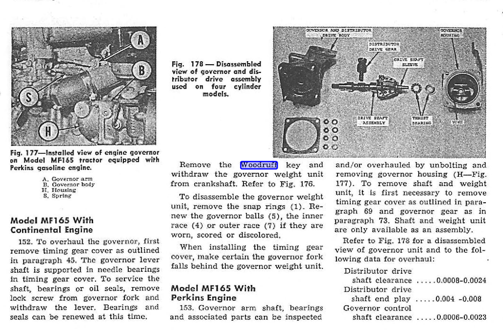

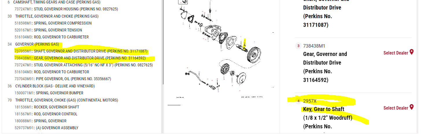

I went out and put my hands on stuff and I am starting to get it. I looked through my parts and I believe I am missing one part and working on getting the shaft, I don't think I ever have it and it could be why this whole issues happened in the first place.
In the picture below I am missing the highlighted part.
The AGCO Website shows the part and part number under Perkins (Gas) and there are two pictures, both with the same picture
Looking at the shop manual the only place I find an entry for the Woodruff Key is for the Continental Gas 165
Do I order it then? If I do, how to I use it?

Well, if you are missing a woodruff key then you are in luck. They are a standard item available at any good hardware store. In case you are not familiar with them they are basically a half moon shape. Because they were standardized decades ago there should be no problem getting the one that fits your shaft. Also, because the sizes were standardized you can bring your shaft to the hardware store or good auto parts store and easily find the proper sized one. It will fit snugly in the slot if the slot is not worn. It will protrude above the shaft about the same as the thickness of the key. It should fill the slot and not slide back and forth. It will rock in the slot because it is circular in shape.

According to the AGO parts book the woodruff key part number and size is 2957X (1/8 x 1/2" Woodruff) (Perkins No. 0500003) Local dealer shows the price of $4.29.
Personally, don't know that I'd get one from a dealer, but neither would I get one from a local hardware. The tensile strength varies so much on these I'd much rather spend a couple bucks for one through NAPA then to have the same problem again. An 1/8" key isn't very thick so I'd opt for one from NAPA etc.
I'd look for, or if you know the person behind the counter has a little knowledge/experience, that's the one I'd go to, and tell him/them what it's for. If they have different grades of them, they should be able to get you the correct one. JMO, take it for what it's worth.

If you look at your video on page 6 where you finally got the shaft out, it looks like the key is still in the shaft. It should fit into a slot in the timing gear. Take another look at your old shaft and see if it's in there still.
If the new shaft doesn't have a key when you get it, you can get one at any number of places as already mentioned.
RE: finding top dead center, remember the piston is at the top for both a compression stroke and an exhaust stroke. It's possible to be 180 degrees off, so take your time and double check.
But the exhaust stroke won't push your finger out of the spark plug hole. See post #70.
   / MF 135 Perkins Gas 3 Cylinder Backfiring no Power #78
Very good point! I was more thinking if he was just using the screwdriver to watch the motion of the piston, it would be possible to get out of phase.
