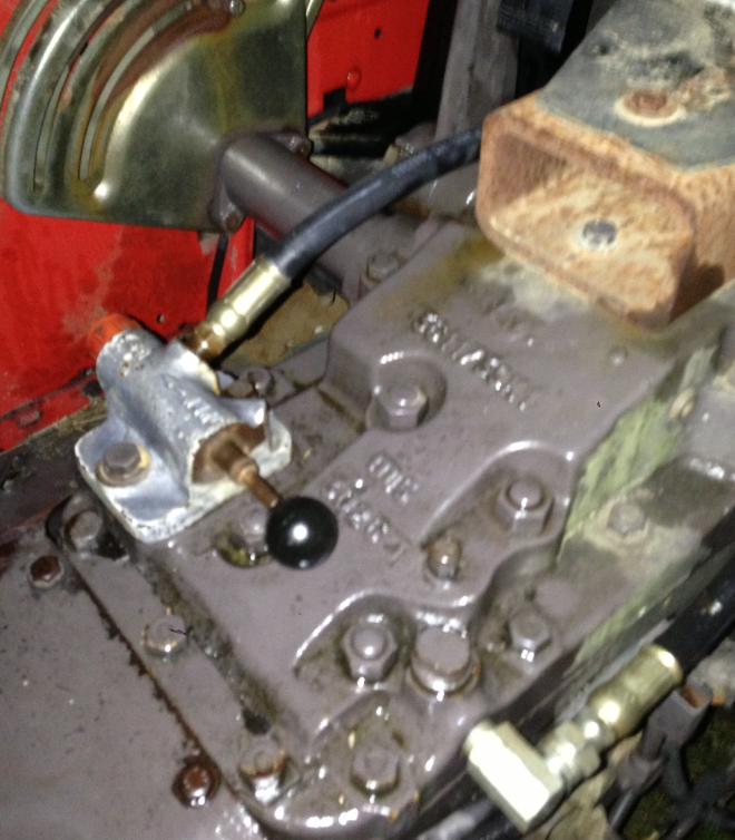

I have a mf 245 that has the hydraulic diverter valve under the seat that controls whether or not I can use the 3pt or the loader. My question is, what is the name of the valve? it went bad and I need to order another one and want to get the right one. And maybe a good place to get it.

Well the valve under the seat actually makes it where you can use the 3 pt or loader. It's a small box with a knob on it. Looks factory. The knob pulled out of the box n is leaking hyd fluid.
/ mf 245 loader/3pt diverter valve
Its actually the whole thing that is connected to the knob that came out.

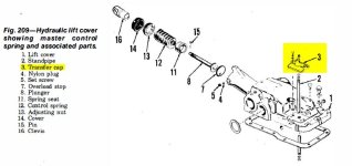

I have a MF240 and it has a valve that takes the hydraulic flow from the internal pump and diverts it from the 3pt to my loader. I am not sure what it is called but here is a picture of it.
I will see if I can find a name for it. It installs in place of the "Transfer Cap" as seen in Fig. 209
Update: Looks like they are called isolator valves or diverter valves.

I removed mine, disassembled it, cleaned it, inspected the O-rings, reassembled it and reinstalled it. No runs, no hits, no errors. No new parts needed. Most often, this valve just needs disassembly and cleaning to restore operation and eliminate leaks. Cleaned it with spray carb cleaner and reassembled it with some silicone spray. If you need O-rings, many autoparts stores carry an O-ring selection. My Ace hardware has a good selection of O-rings.
