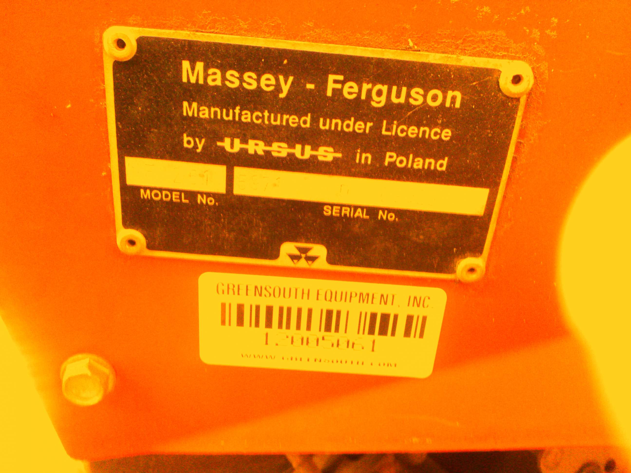

you are correct in that I do not really know exactly what I have. it has everything like a 231 in all the pictures I have seen, but it has the rear end of a bigger tractor with the wet brakes and all. it might be a 261. don't really know for sure. this is what a MF dealer told me it was when I sent him about a dozen pictures. offhand I mentioned all the gauges were made in Poland, and he said it was a 231 made in Poland. the interesting thing is that there is no serial number anywhere. other MF tractors have serial numbers, but not this one. does your 261 have a serial number? if so, where?
there are 2 steering cylinders. I was not aware some tractors only had one cylinder. learn something new every day.

My serial number is located on the right hand side of the tractor as I sit on the seat. It's on the tractor's side, just in front of the instrument pannel. It's on a tag that's rivited to the sheet metal. I had to take some photo's a while back because I couldn't get close enough to read the number. It's partially blocked by the loader controls. I'll try to upload a couple of photo's.

I guess, you've already checked at Tractordata.com about locating the serial number on the 231. It says it's on the right side of the instrument panel.
TractorData.com Massey Ferguson 231 tractor information
This seems to indicate that it's in the same location as on the 261.
TractorData.com Massey Ferguson 261 tractor information
The steering cylinder on my 261 is located behind the grill in the battery compartment and I'm pretty sure it would be located in the same place on a 231. Maybe you should send the photo's, you took to a different dealer or, put them up in a thread called something like, 'Identify this Massey'. I jump on threads of that type, tractor people seem to enjoy a contest.

the sheet metal I have has no tag where it is supposed to be. or in the rear behind the seat. or any other place where they have been placed. I will see if I can some pics later on in a new thread where you suggest. it was interesting researching this myself before contacting a dealer. I can see why others do too.
