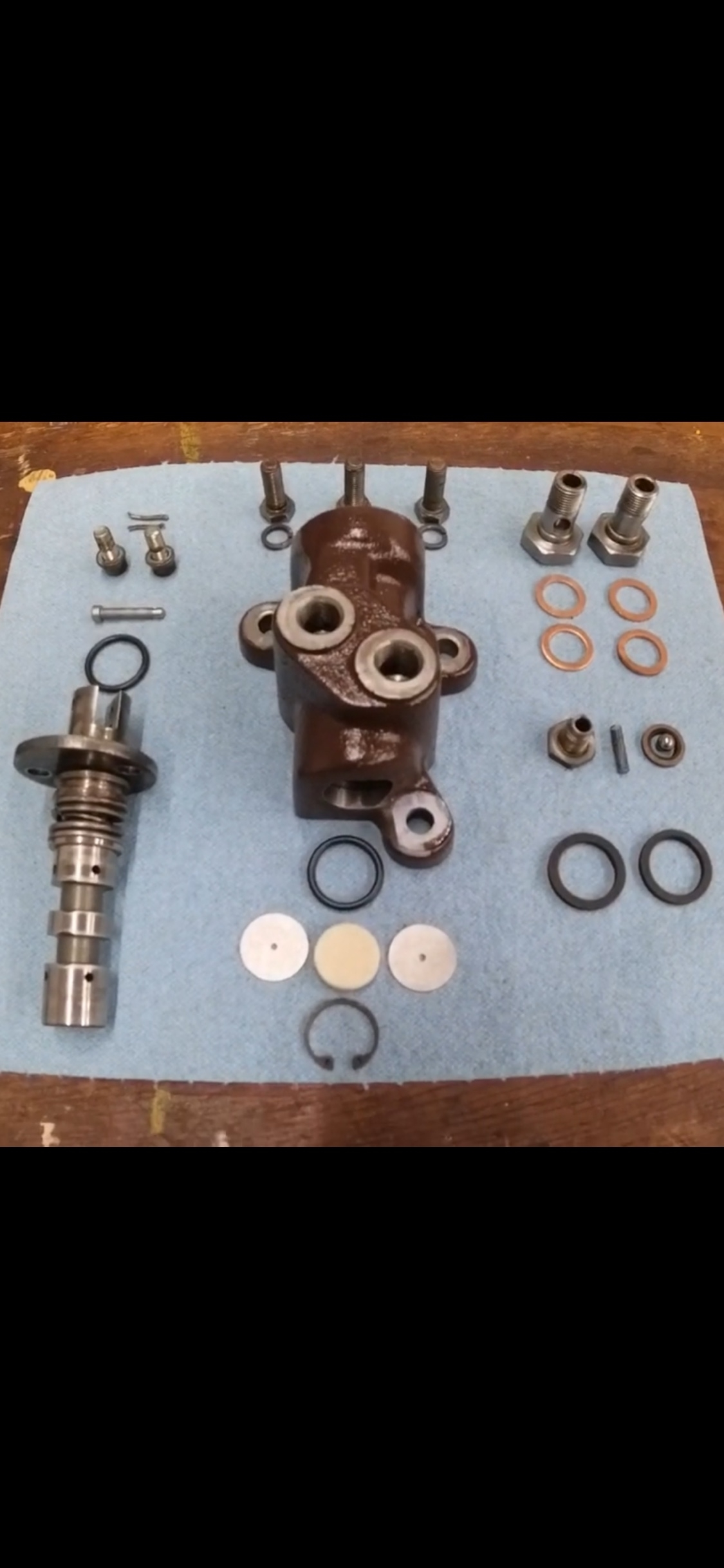

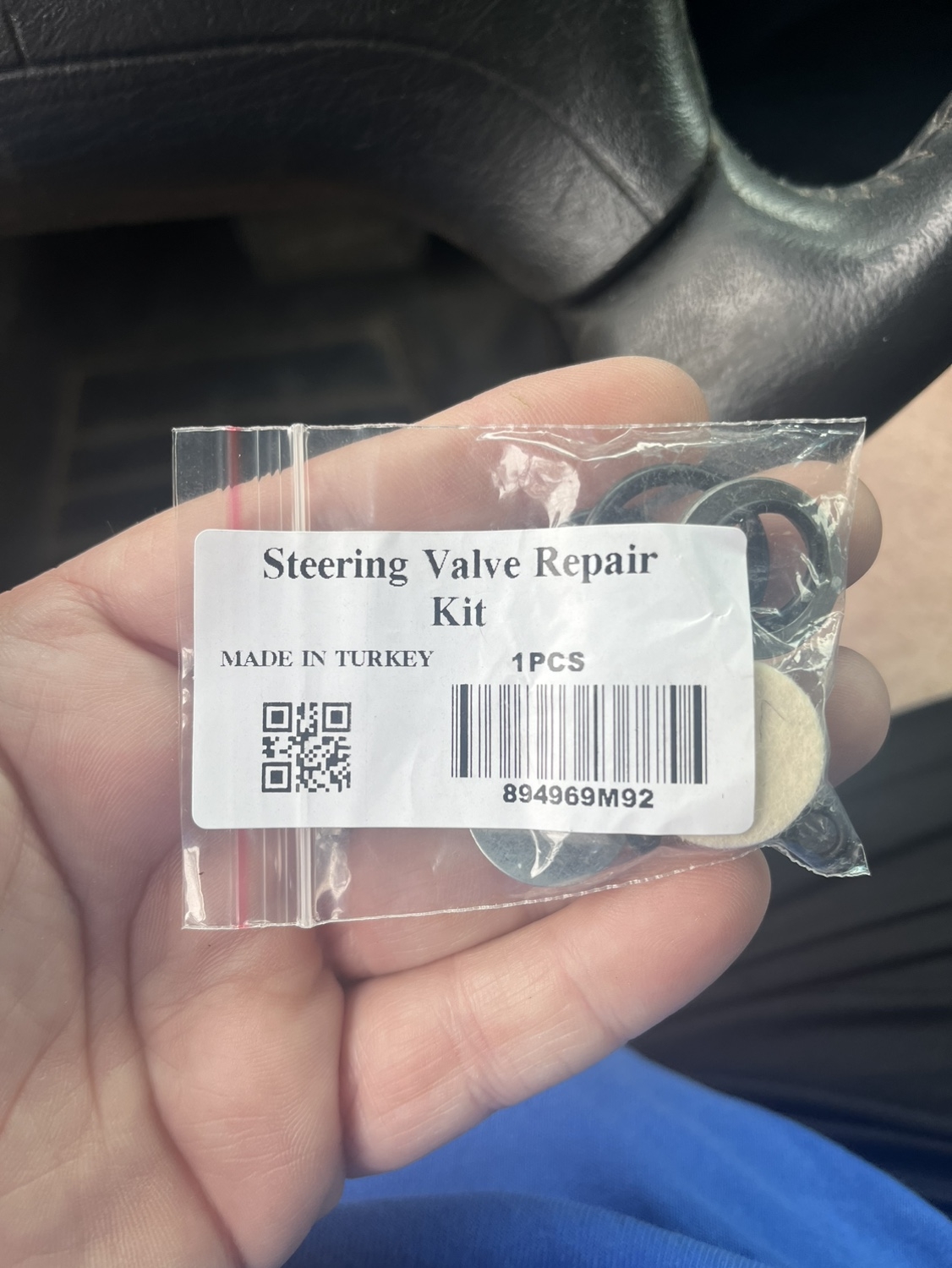

Here is the rebuild kit for the power steering control valve for a Massey Ferguson 231 tractor. It might fit all the year models, I’m not sure, but it fits my 1998 year model. The control valve is known to leak over time and this is a good, high quality solution. There is a good video on YouTube on how to do the repair.
It is Massey Ferguson part # 894969M92 or Sparex part # S.6380. I purchased this one off eBay. It will probably fit other Massey Ferguson tractors also.

Ah the old power assist control valve does it come with the quad rings also?

I’m not sure what you’re referring to as “quad rings.”

It's where it bolts to steering shaft you can use orings too but they were square did not come
In kit from Massey back in the day

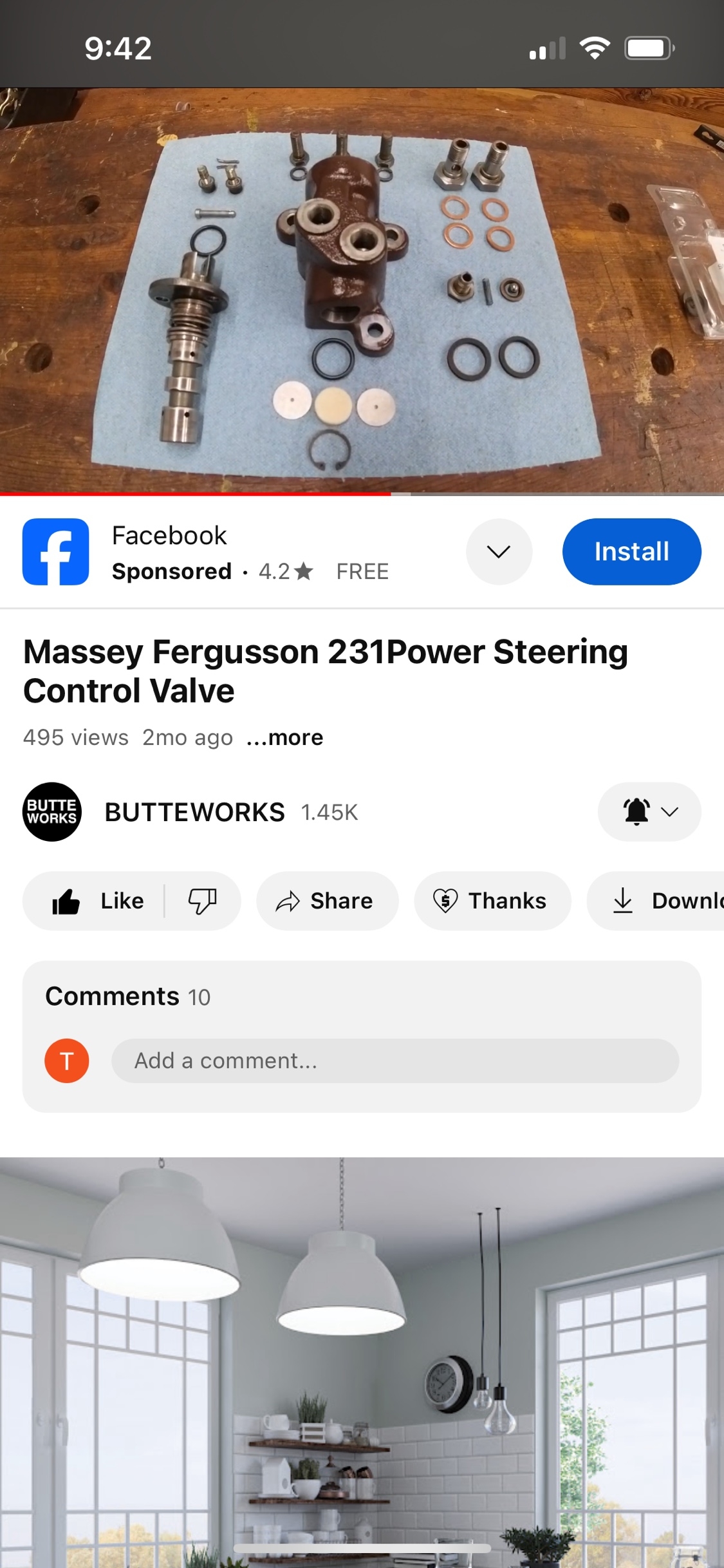

I will take a picture today of what came in the kit that I purchased. Here is a link for you to watch on YouTube of someone doing the rebuild.
