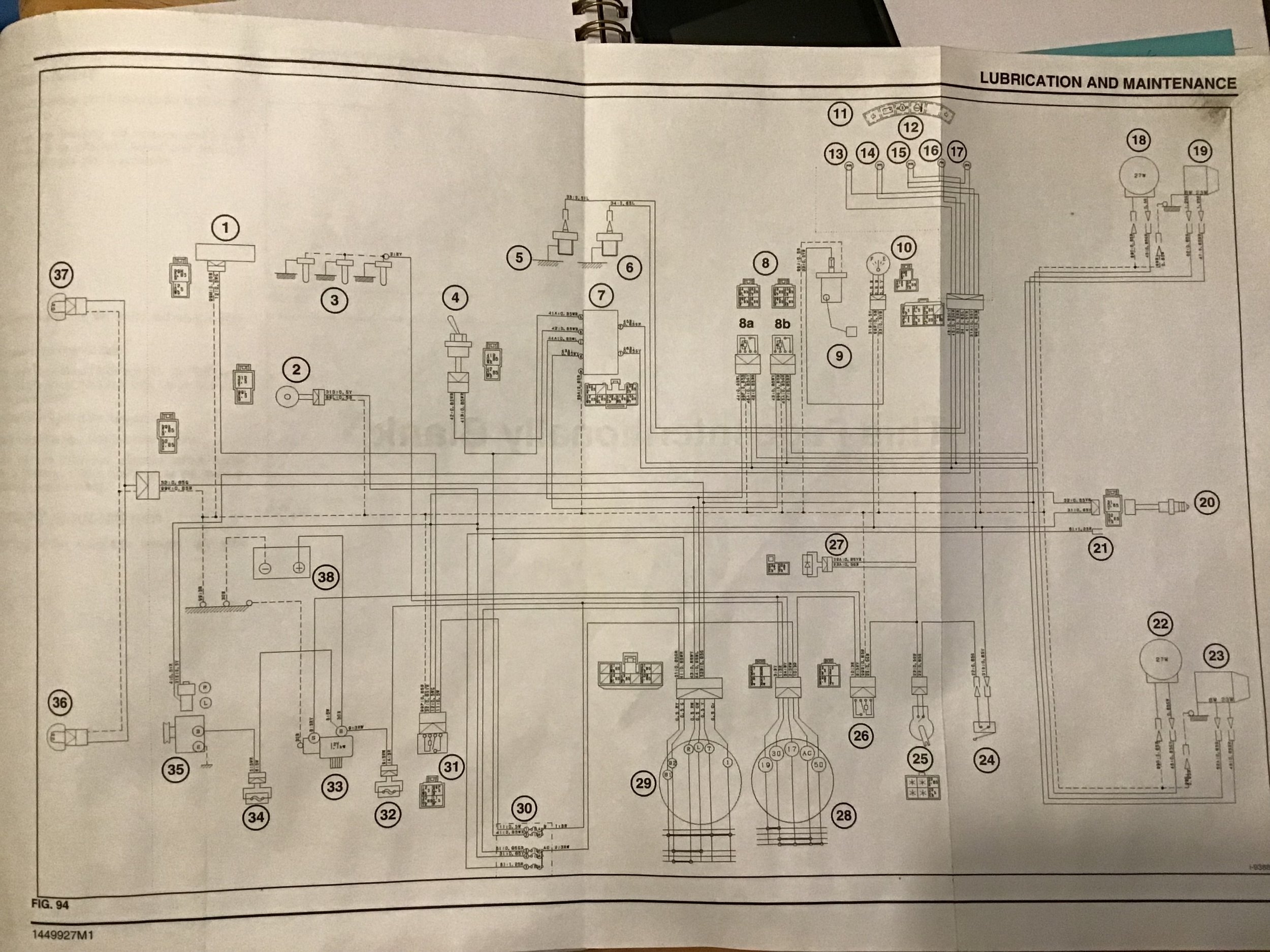

Looks like you found your schematics, unfortunately I am unable to clean the image enough to read yet. I will work on it more.
Lou
Lou, 2nd attempt at schematic upload.
JM

I removed and cleaned all of the connections to the starter. I only measured 10.5v to the glow plugs, the battery showed 12.3v. The tractor started, I took the tractor to Advance auto. They said that the starter and battery are good but the tractor would not shut off, I assumed that the fuse blew and i shut it off manually but then i was able to restart? I went home and the fuse blew when i tried to start. Of course the tractor is not stored where I live so as I was driving home i thought that if I can measure 12v going into the ignition and only 10.5v going out to the glow plug wire then the switch could be the problem?

Lou,
I do not have a DC current clamp. I was re-checking some voltages and testing the glow plugs when I noticed smoke coming from the bowels of the tractor. I started removing panels and parts and tracing the glow plug power wire under the motor until i found the short.
The short was at the metal spring steel that wraps around all of the wires holding them to the motor. The vibration had worn through the rubber coating on the spring steel and through the harness loom and then through the glow plug power wire which seemed to have a very tough teflon insulation. I made a repair to the glow plug wire.
I also replaced the ignition switch because at least once the tractor would not shut off while not having a blown fuse and the switch was very corroded.
That was a real head scratcher. The tractor seems to be back to normal.
Thanks for all of your help.
