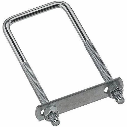

Hello everybody. So I noticed that my 1825E MF has a flat tow/draw bar below the PTO, so I went out a buy a 2 5/16 inch hitch ball so I could pull my flat/open trailer around the property, but what I found-out is that those holes on the tow bar are all smaller then the hitch ball shank which is 1.1/4 in. in diameter. does anyone knows if I can find a tow bar with different size holes?
P.S. I looked everywhere with no avail. Thank you all.
Lots of responses telling you to go get a 3 point hitch. If you want to pull from the drawbar like your question asked, just extend the drawbar a few inches. 3x3x1/2” steel angle bolted thru the drawbar 1 1/4” hole with another hole in the angle sized to fit the hitch ball. You may want to add a large square U bolt further up the drawbar to hold the front end of the angle.

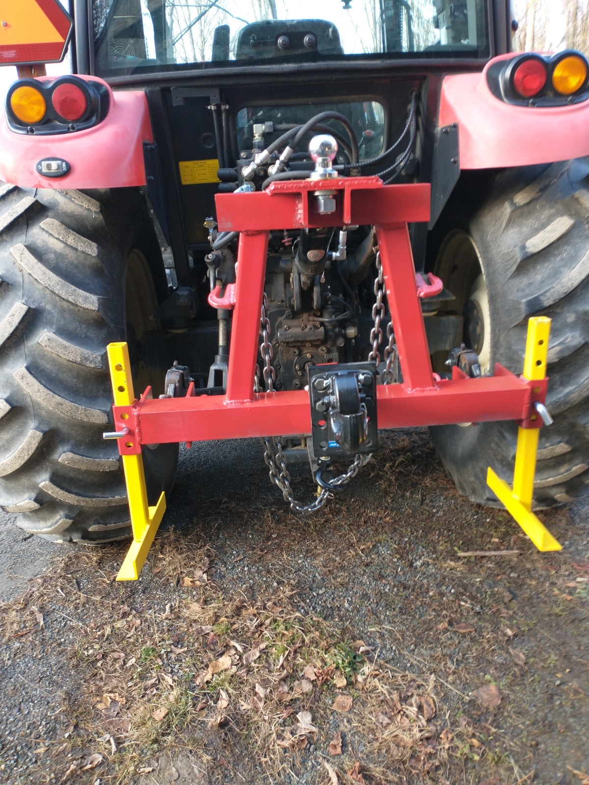

Many tractor drawbars are also to thick for most trailer balls. The 3 point hitchs are nice and handy but I would advise anyone using those to also use something to limit how high the lift arms can travel. On all tractors that I am aware of with 3 point hitchs the lift arms can be lifted much higher then the hydraulics will lift them.
In my second picture you can see the chain that goes down to a clevis in my drawbar that acts as a limiter to prevent the hitch from being lifted by a trailer and damaging the tractors.
View attachment 1736737View attachment 1736738
Why do you need the yellow pieces that limit how low the hitch will go?
   / MF 1825E drawbar/tow bar #29
Those are the parking stands for when I take it off the tractor so it stands up right.
They are just pined on and are easily removed or adjusted.
