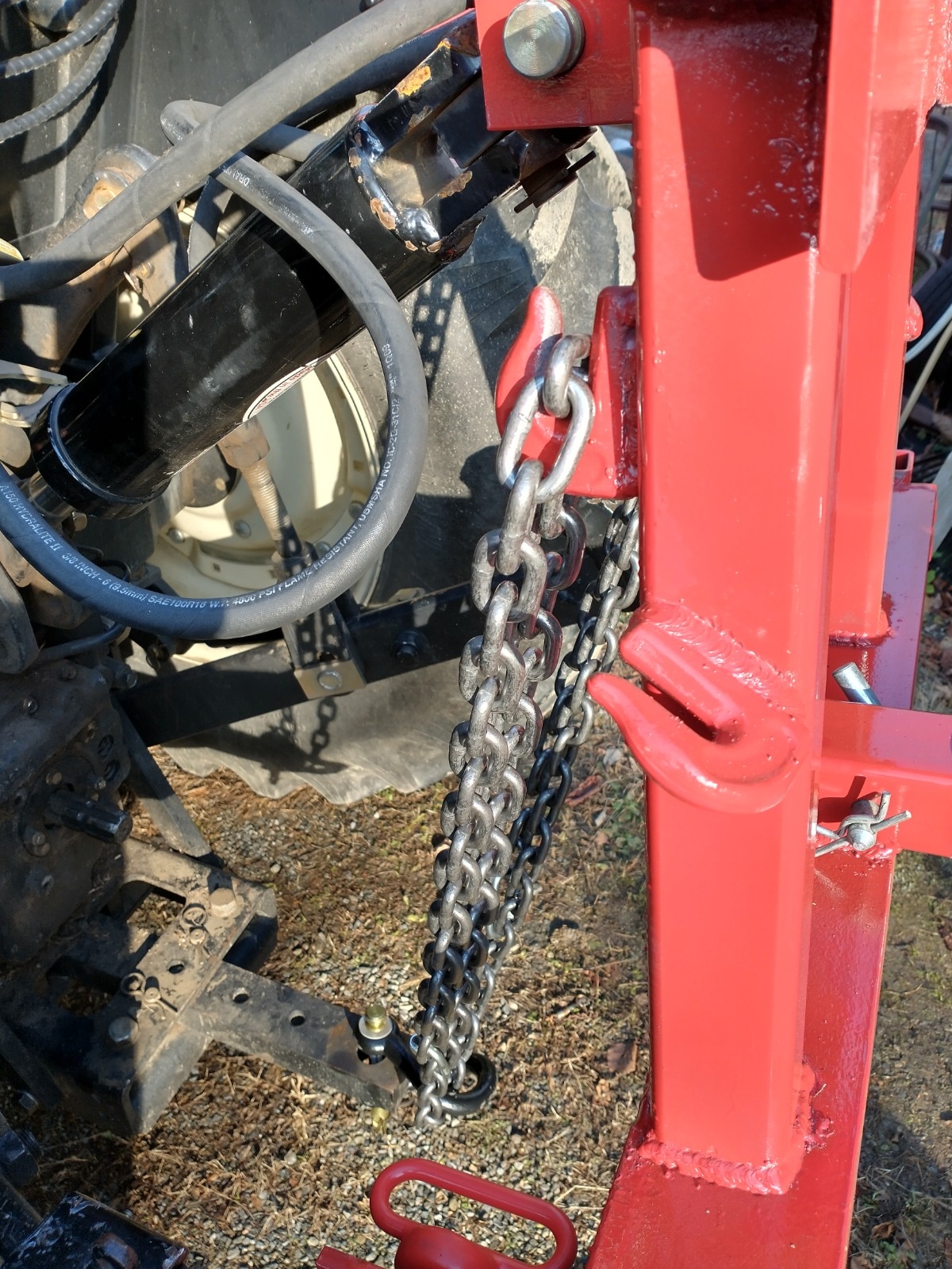

Many times loading or unloading the hitch will go light and try to lift in the air. When backing up often the trailer will try and push the tractor lift arms upward, the same going down hill with the trailer pushing it can push down on the lift arms when they are very low, but if the lift arms are level or up a bit from level they will push up with considerable force.
So the solution is binding the 3 point hitch with some kind of rope or chain, right?
   / MF 1825E drawbar/tow bar #16
I use a chain down to the tractor drawbar, set so the lift arms can be lifted up but not pushed past normal lift.

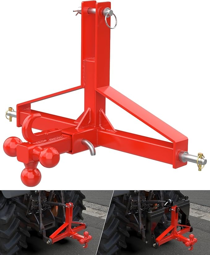

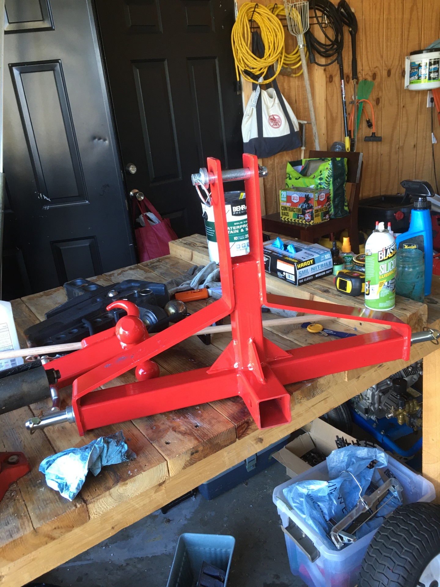

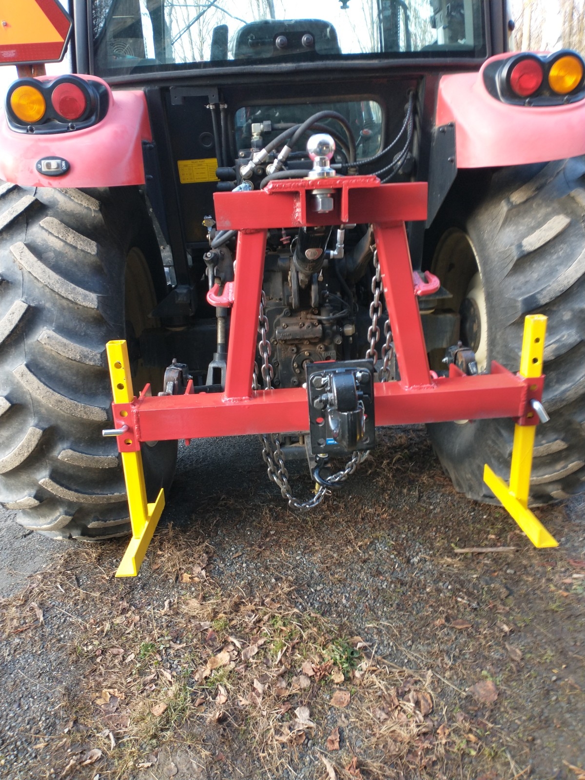

Hello everybody. So I noticed that my 1825E MF has a flat tow/draw bar below the PTO, so I went out a buy a 2 5/16 inch hitch ball so I could pull my flat/open trailer around the property, but what I found-out is that those holes on the tow bar are all smaller then the hitch ball shank which is 1.1/4 in. in diameter. does anyone knows if I can find a tow bar with different size holes?
P.S. I looked everywhere with no avail. Thank you all.
Years ago I discovered a trailer ball in the under-belly drawbar doesn't work so good. When making a turn the rear tires will hit the trailer tongue rather quickly.
I can mount a trailer ball on my 3-pt hitch drawbar and gain about 18" back from the under-belly drawbar. This allows much sharper turns.
To keep the 3-pt drawbar level, I made a 12" long section of angle iron with a bolt hole in one end and a muffler clamp on the other end to hole the angle iron to the lift arm.
#18
I just got me a brand-new 3 point trailer hitch from Amazon....that I'll mount on my tractor tomorrow. Here is the picture from Amazon...
   / MF 1825E drawbar/tow bar #19
That is the right stuff. You will be glad you went that way in the long run. Hope it fits your 1825 without mods.

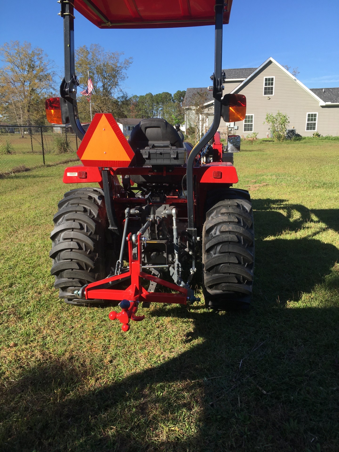

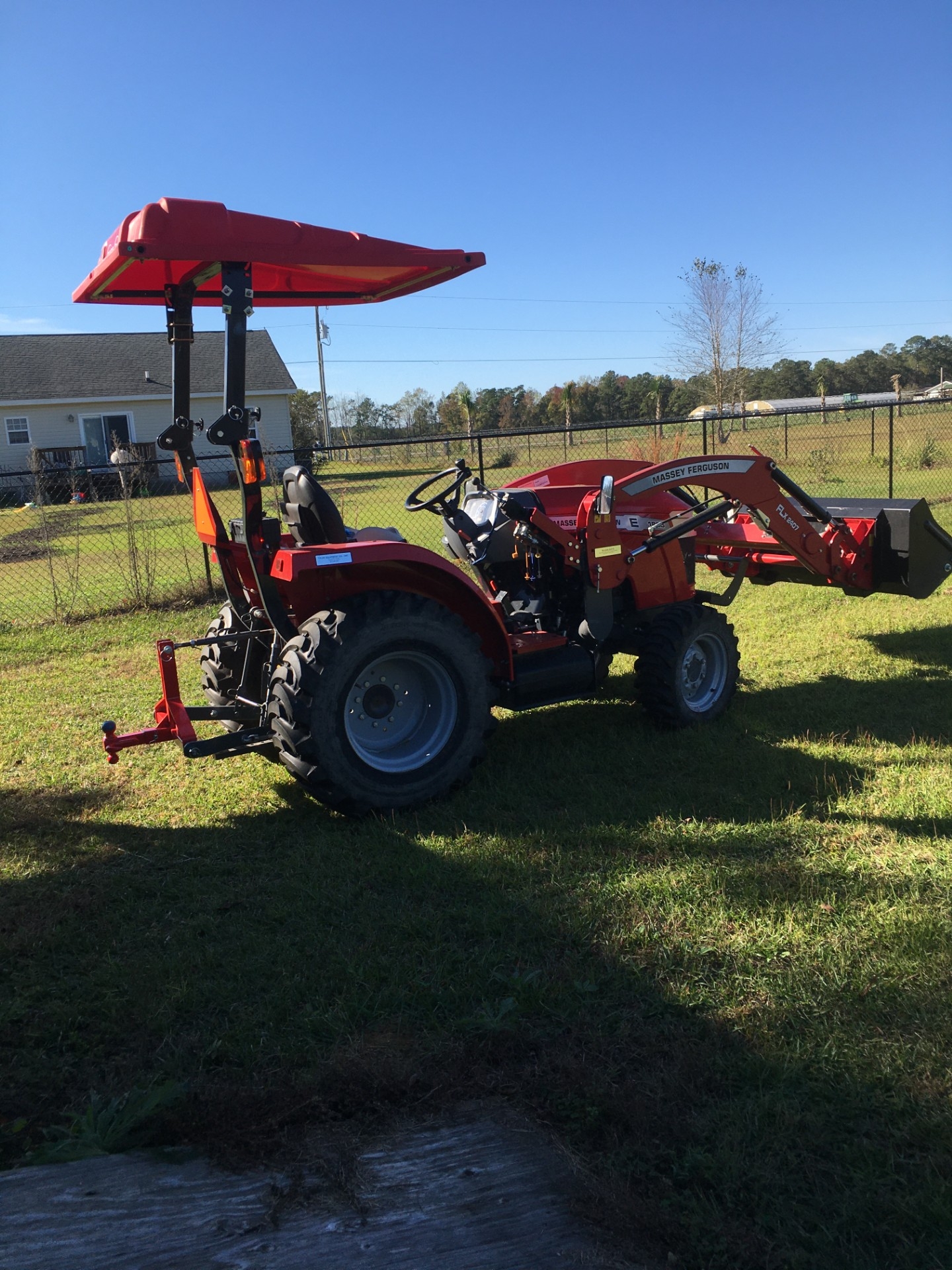

Thank you all for your help and advices......here I got some pictures, by the way it fits like a glove.
