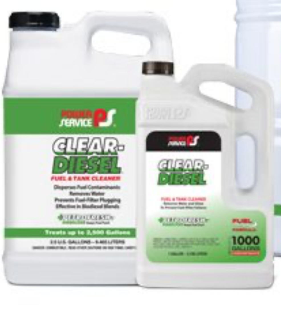

I had a similar problem with my 1540(95% same), after getting a delivery of bad fuel. Tried many unsuccessful fixes for months.
Getting the tank out of this model is a bi%ch.
Finally broke down and bought some fuel tank “cleaner” product, and within 2 tanks, it was completely back to normal. Haven’t had the problem again.
Not an endorsement for this product by any stretch, im usually pretty anti-snake oil additives. Just an fyi screenshot of what product I happened to pick up at the store.
I still have the remaining product in my garage
