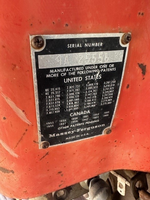

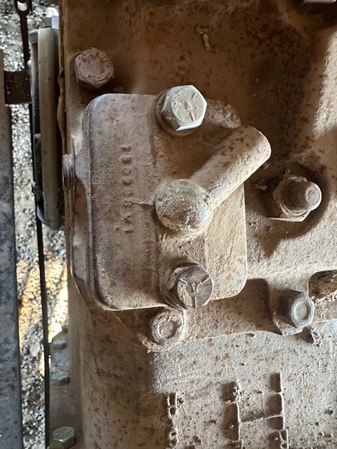

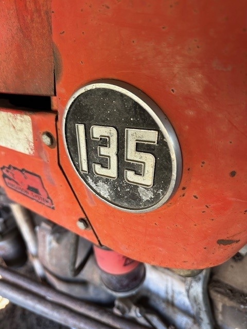

I have a diesel MF 135 with no remote hydraulics. I would like to be able to operate a cylinder on a hydraulic box blade. this seems like a light load for hydraulics vs. a front end loader.
my question is, will someone recommend a vendor for the conversion kit? the kits i have seen on the internet look like the replace the cover in the pictures I have attached.
thanks, Carr

It looks like Yesterdays Tractors sells a few kits, search the 135 hydraulics page for "remote"
No experience with it but I've been meaning to buy one as well for a log splitter so let us know how it goes.

I installed this kit from spare parts holland- an ebay vendor.
easy to install. only problem or concern is the pick up tube came out when I removed the original cap. I think i have it all back together now. However, I have not been able to test it since my new drag box blade has not arrived. thanks
