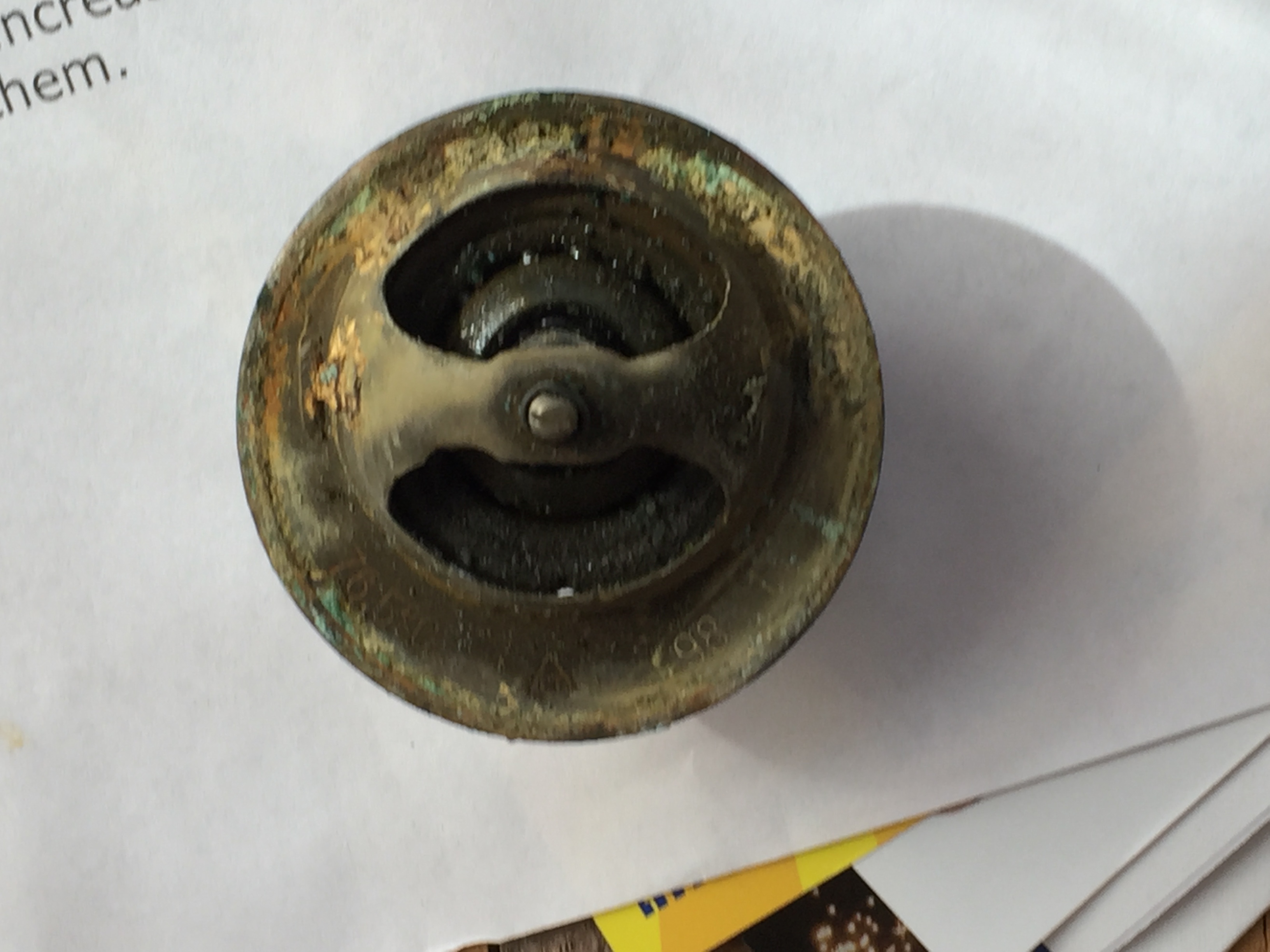

I am almost finished with my repair (well got the water pump back on) but ran into a problem with the thermostat. Besides the fact that the O Ring will not stay in its grove (its a very narrow in diameter O Ring), the themorstat is not circular. It will fit in almost anyway but there must be a right way.
As you can see it has a wide side and a narrow side. Most i have seen (in cars) are round. Any thought son how to put it in?
