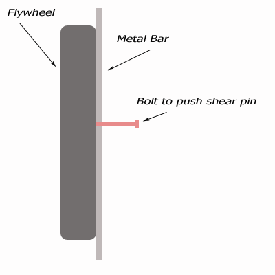

/ MF 12 shear bolt stuck in bushing
On the side where the bolt head is it doesn't matter which position the flywheel in located, access the the bolt head is at a steep angle. I might be able to grind off the head but I wouldn't be able to get a punch on it ant any type of decent angle. I am talking about an angle of like 30-40% at the moment.
I looked at again this morning and I think maybe I can rig up something like a heavy metal bar clamped to the flywheel with a hole tapped in the center that I could insert a small diameter bolt and push the shear bold out by tightening the bolt on the metal bar. I really don't want to remove the entire slip clutch to get good access from the bolt head side of the issue.
I decided to take the slip clutch assembly off and attack the problem from the front where I had direct access. Drilled out the old shear pin which seemed like it was rusted to the bushing. I think from now on I'll remove the shear pin after each season as a precaution. :)
