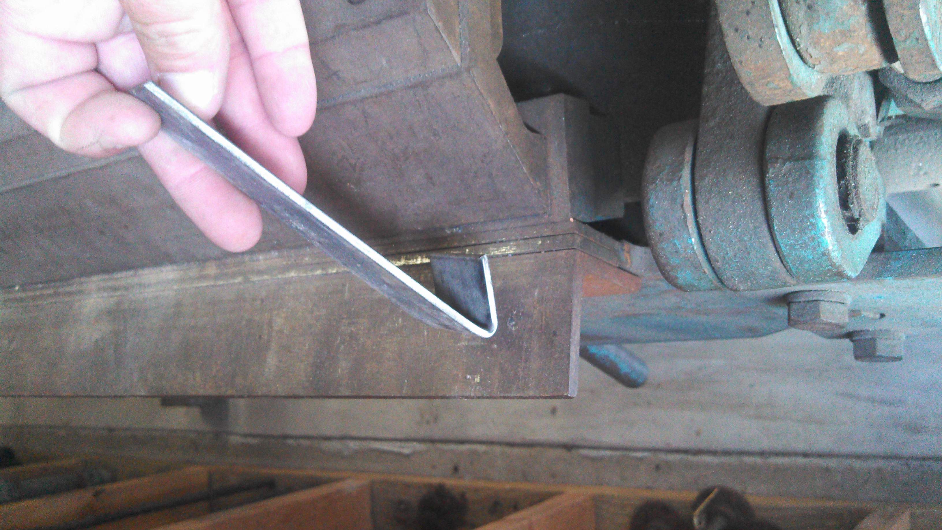

When I need things bent I use a local shop who has a press that can bend 1/2" plate. I recently need some smaller pieces bent to 180 deg for a project. 1/8 thickness, 2" wide and each leg is 5 inches long. Basically little triangles. I needed about 16 of them. When I approached my shop owner he said he didn't have any way to bend to the 180 deg but offered to shear the 5 inch legs recommending that I weld them together. While that is an option I prefer that the part be bent as I think it will work better with less grinding in this application.
Anyone have any recommendations for how to accomplish this? Thanks.

I read the OP's post as he was making triangles or needed to bend completely around something to make the part.
If all he's needs is a "V" any finger brake will work. As they can bend metal to 180.
   / Method for bending past 90 deg? #17
They say a photo is worth 1000 words, so I found a drop of 1/8" plate and made the first bend on my finger brake. Came out at 135 deg on the first bend, remove lower the fingers back down and drop the arm again and your at 180.
