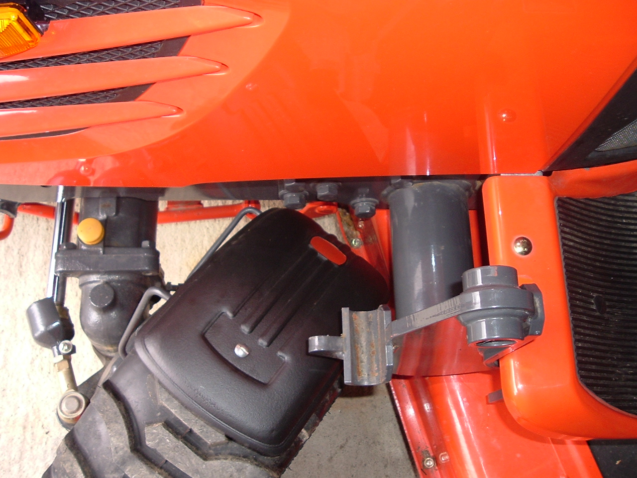

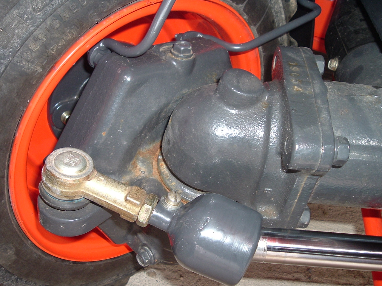

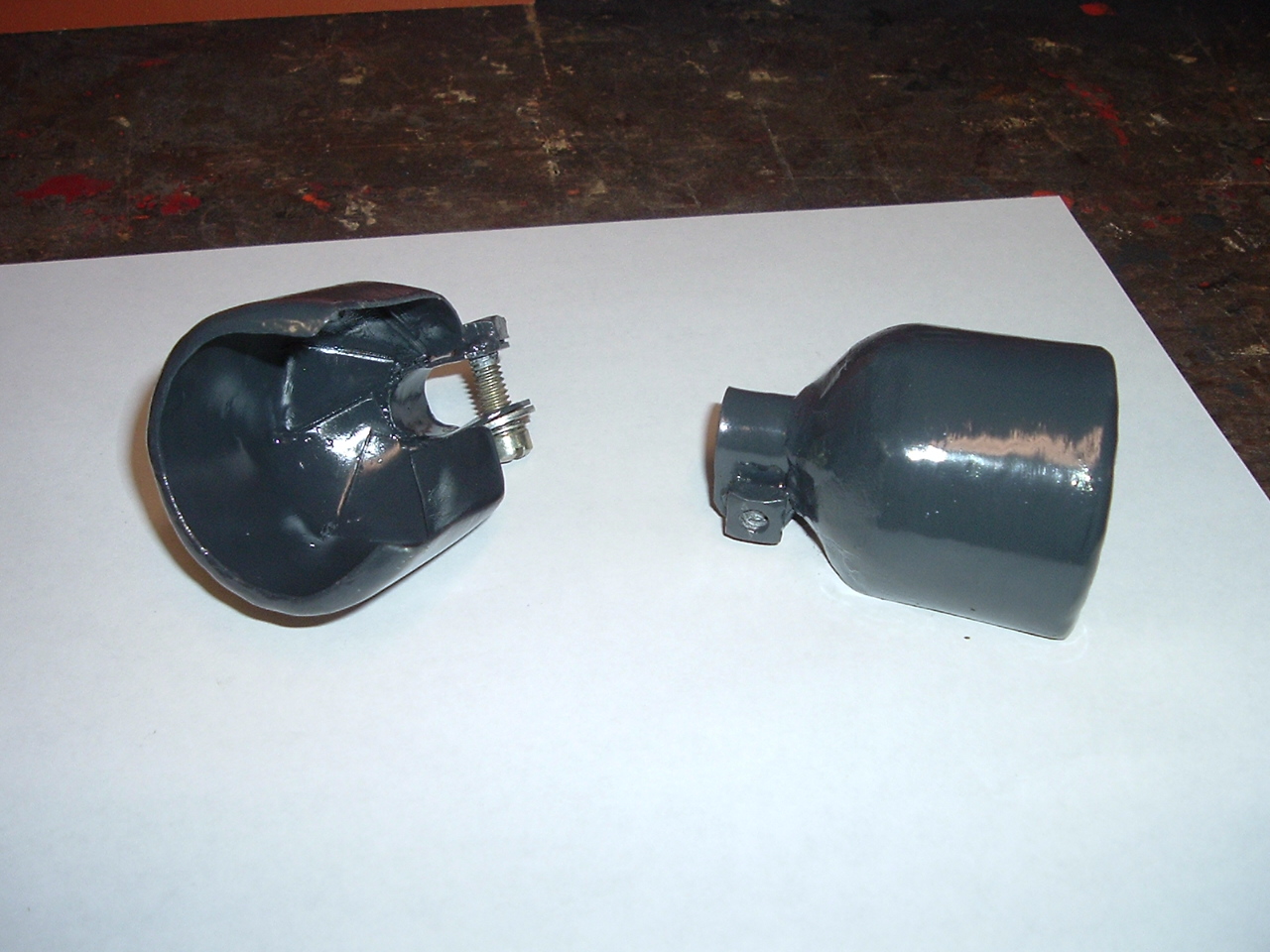

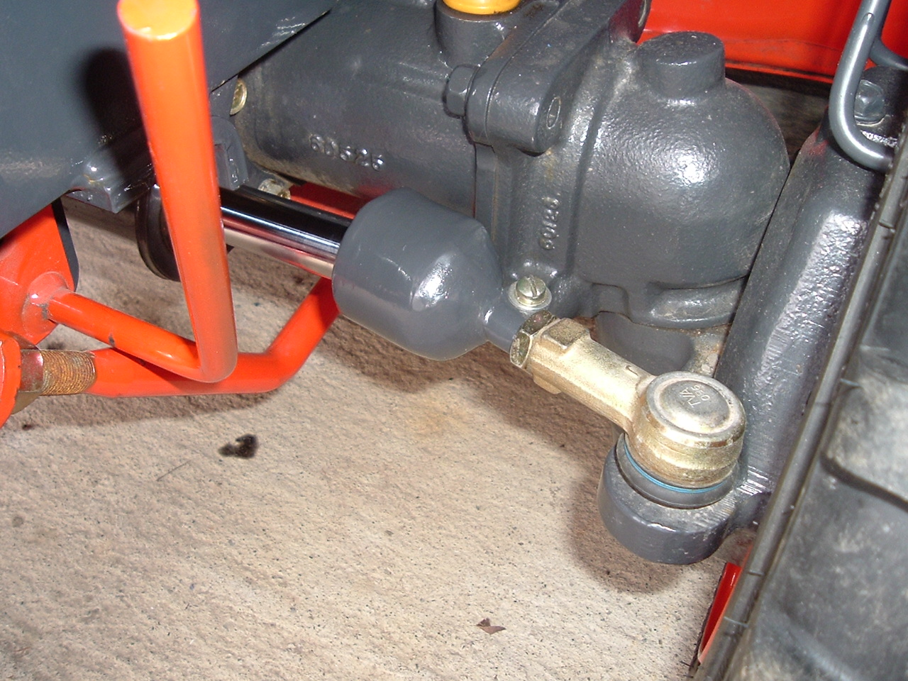

Here are some Pics of a front guard on the rubber boot to keep it from ripping when going through heavy brush with the BX it is made from 1 7/8 exhaust pipe.

Really nice work, lowboy. After having to patch my torn boot last week, I've been trying to figure out a way to get this kind of protection. Looks like a real solid way to mount it and with the cutout on the back side you've got the clearance for the turning.
The only drawback I can see is you must have sent a while cutting, bending, and welding. Care to go into the steering guard fabrication business?

LowBoy, my compliments to you for a very ingenius and beautiful piece of work. I would greatly enjoy seeing any photos that you might have taken during the multiple steps that you followed to achieve these fine results.

You can buy the rubber boot at any auto store ( Auto Zone Pep Boys Advange Auto ) it is a small tie rod end dust cover it is usually in the section were rplacement hard to find parts are ( door handles knobs plastic connector ) the cost is around 3.00 and it is a exact fit

I will make another one and take some pictures of the process but it will take me some time , I'm real busy at work right know I don't think I could make a living selling these I'm glad you like the design
