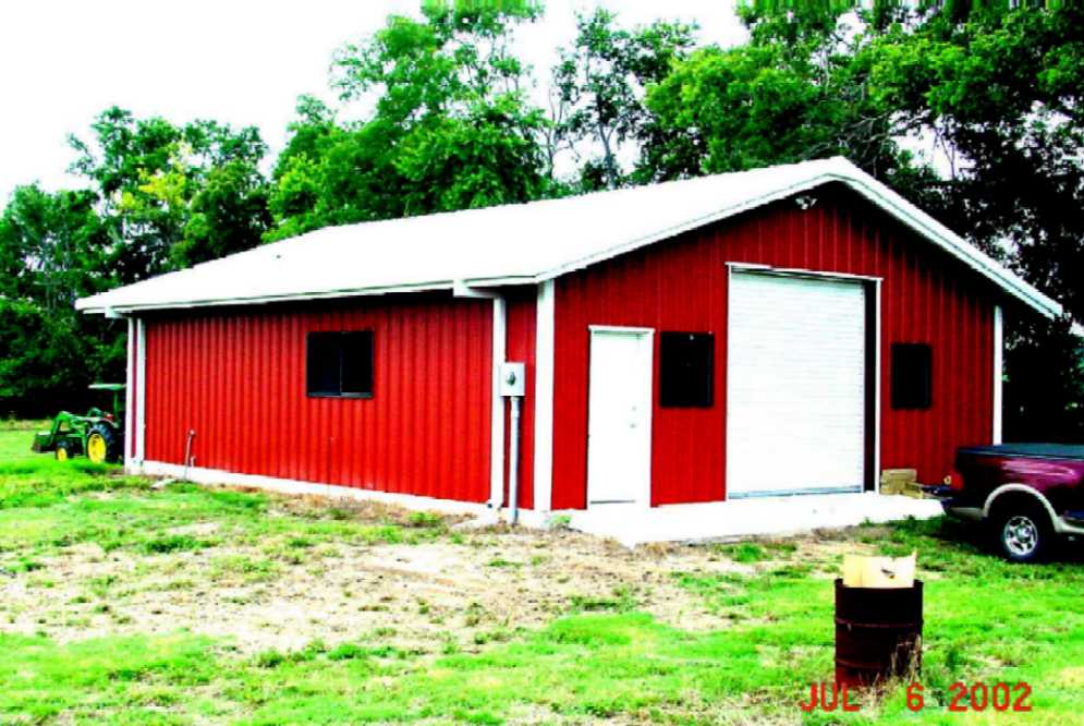

Hi Daryl-
I took the looong, but cheap route and built a 30x42 metal equipment storage building using home made metal trusses. It was a lot of work, but was a fun project to work on. I wrote up step-by-step instructions for a welding email group that I'm a member of: http://users.arn.net/~usnick/welding.html
Total cost was a little over $4,000.
