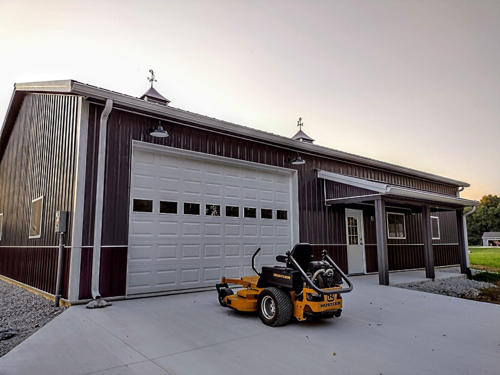

We had 6” gutters installed, and buried the downspouts about 150’ from the barn, into the field. High and dry!
