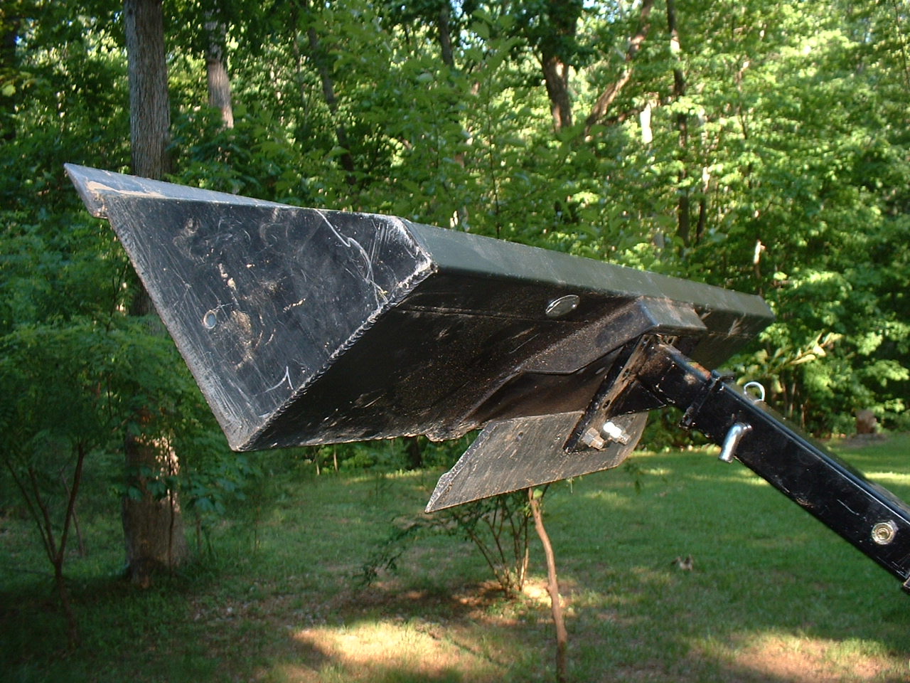

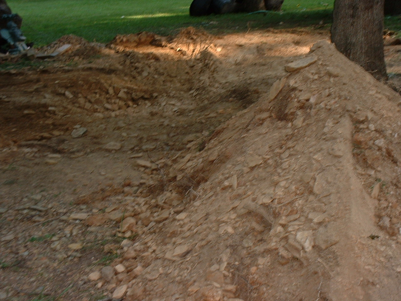

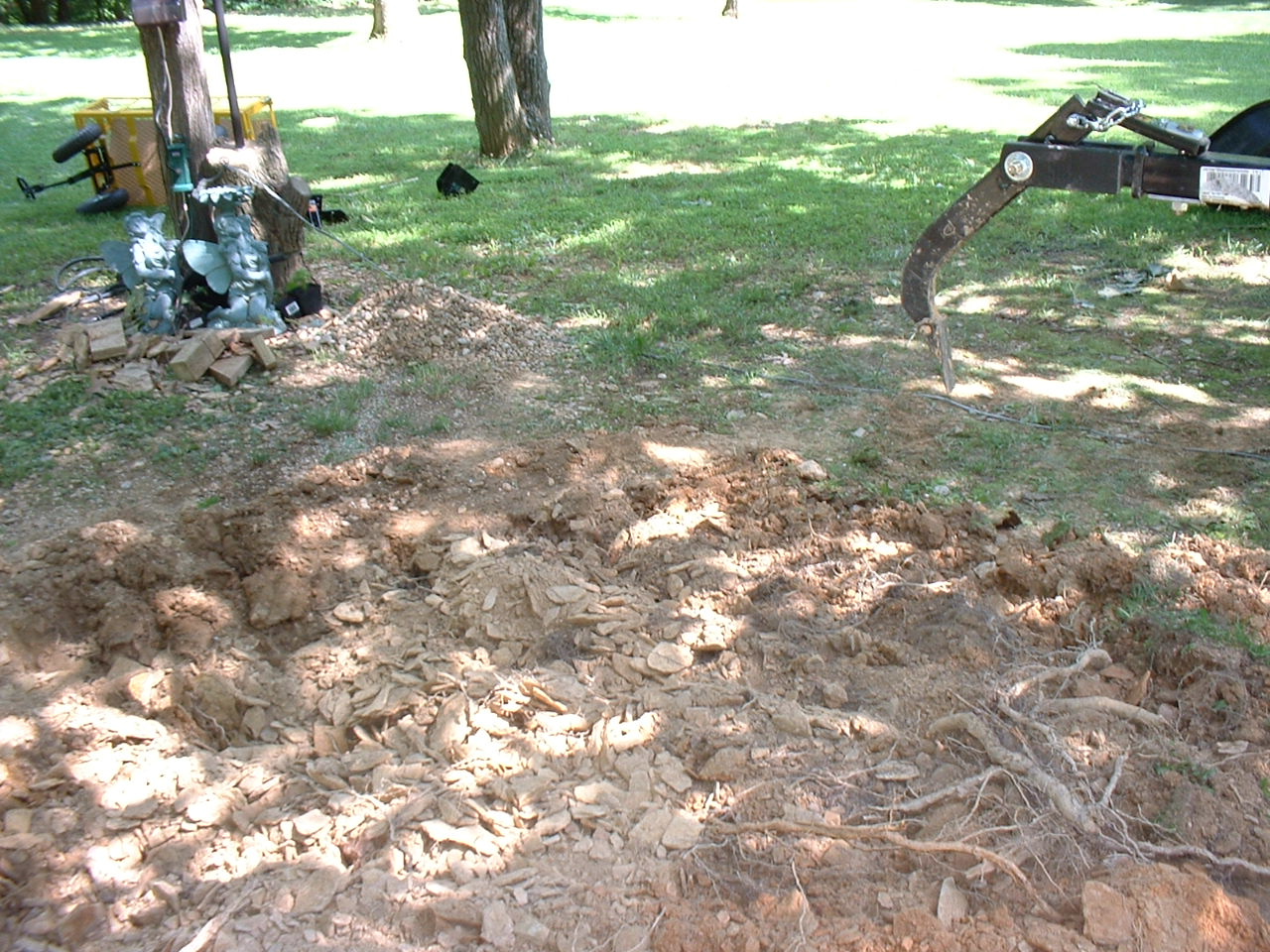

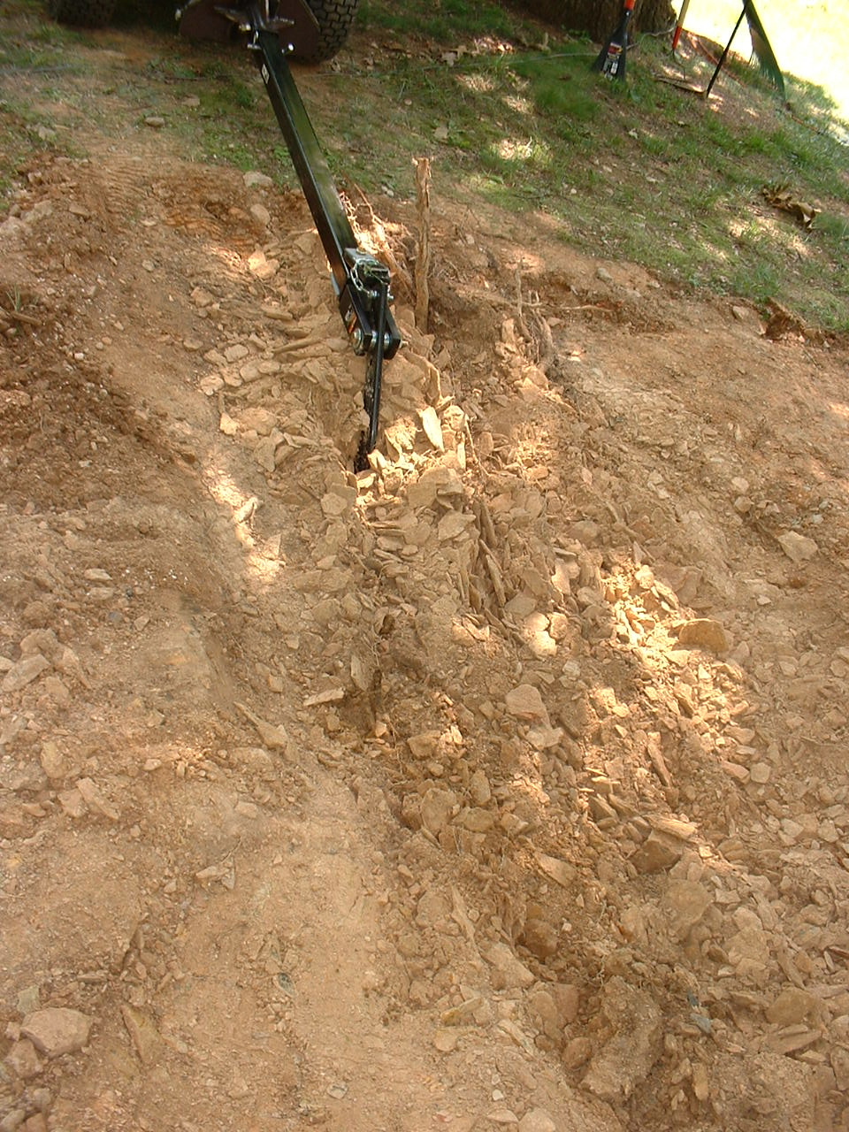

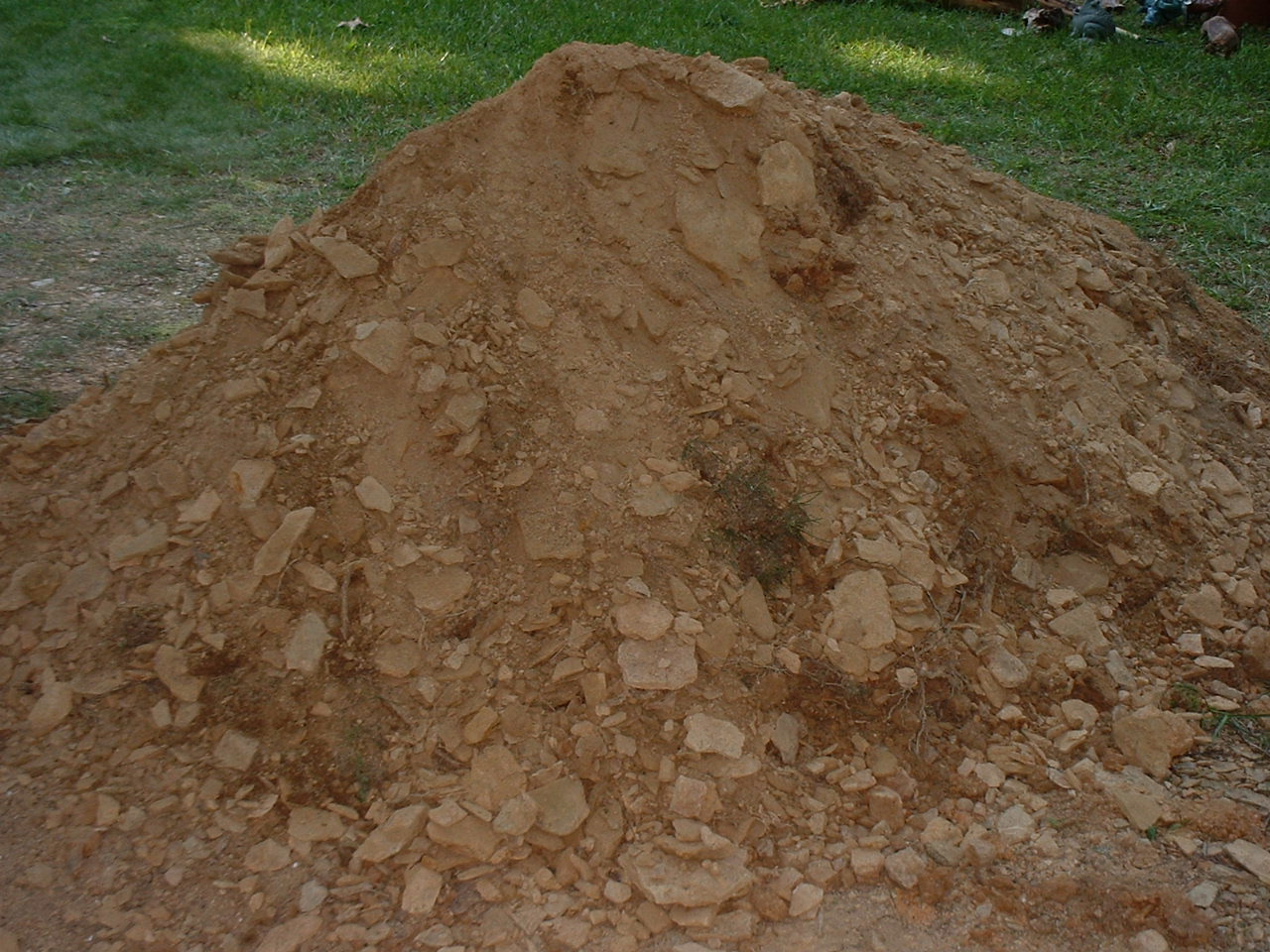

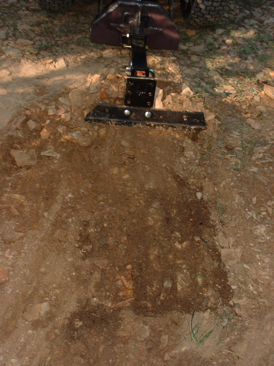

I still haven't gotten all of my attachments really done yet, but I had to move on my pond. So here are a few shots of the work I am doing, with what I have at hand. As you can see this is what I have to dig through around here. I know some of you have the same shale / rock.

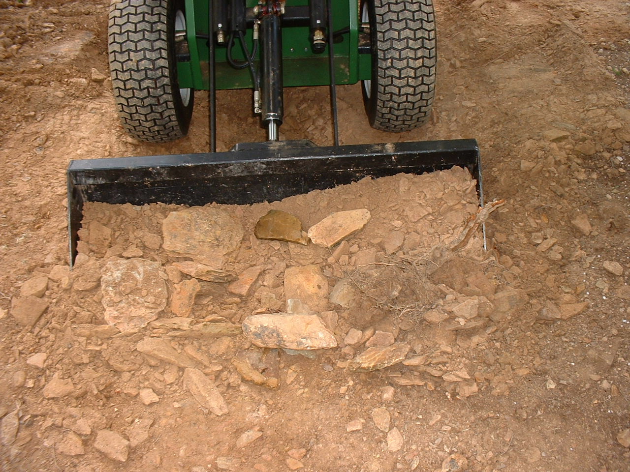

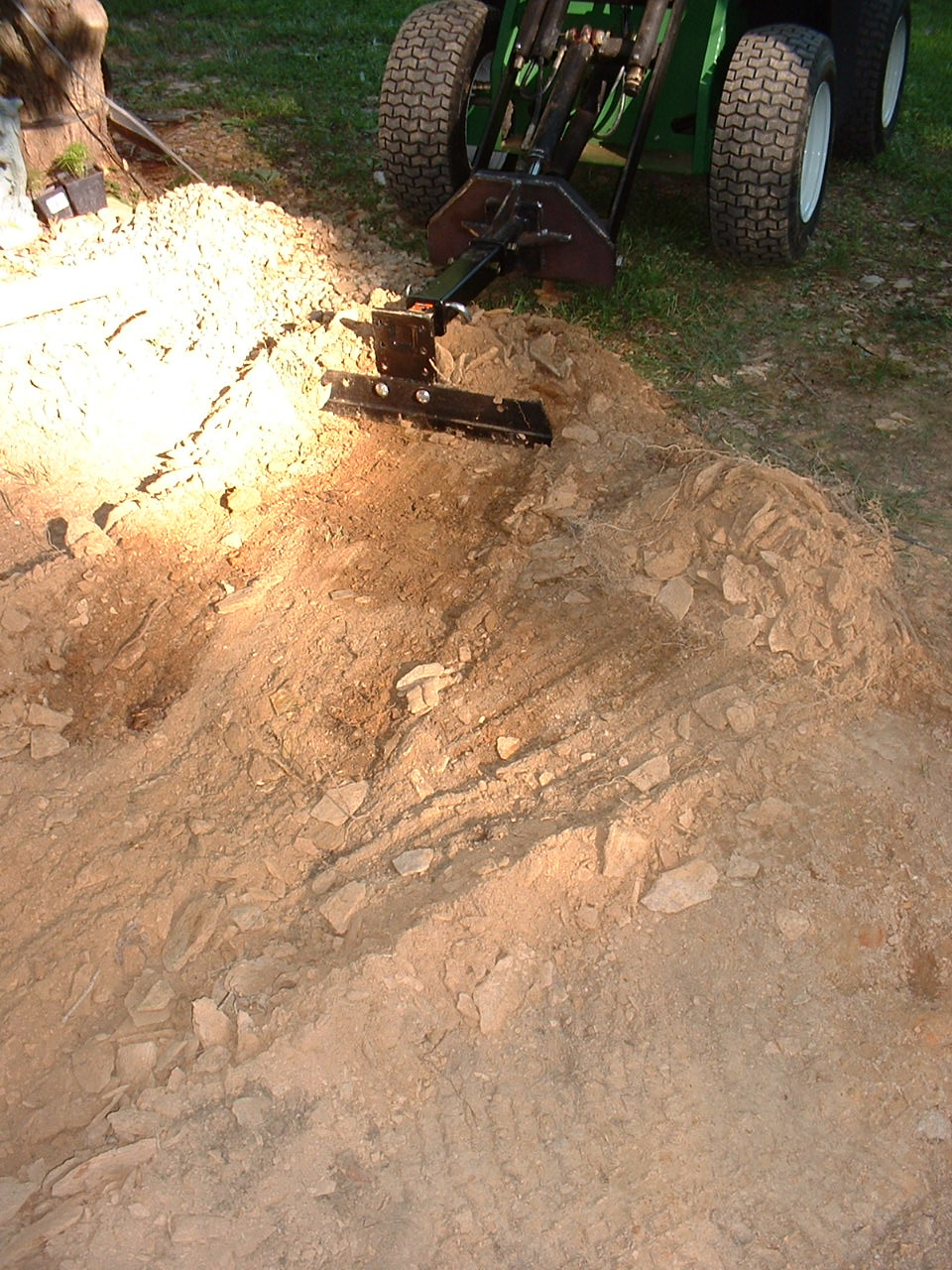

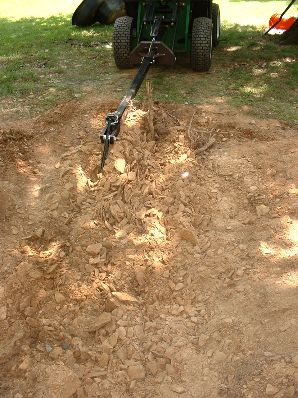

Seems I can't really dig by hand with out shoveling out pure rock, so thus the ripper to bust it up. Even though I still need to drill out and center my steel hoe/scrapper.. I'll call it. It really helped me pull the shale and dirt out of the hole so I didn't have to use a shovel.
I had a small pond, but after this winters frozen ice killing all my plants and almost my fish. I decided it needs to be much larger and a lot deeper. Also to keep the animals from scooping out and eating the fish. Anyway, I worked on it some today, and will take pictures as I go along.
Pictures in order, the shale I have to bust through and the ripper worked great for that, also for tearing out roots. The Hoe/Scrapper pulled the shale and dirt out of the hole and worked a little like a box blade, as in scraping the dirt out smooth, worked nice for either pulling the dirt/rocks or pushing them. I just bought some new drill bits, so I will be centering it on the hitch along with maybe even making it a little deeper before I am done with it.

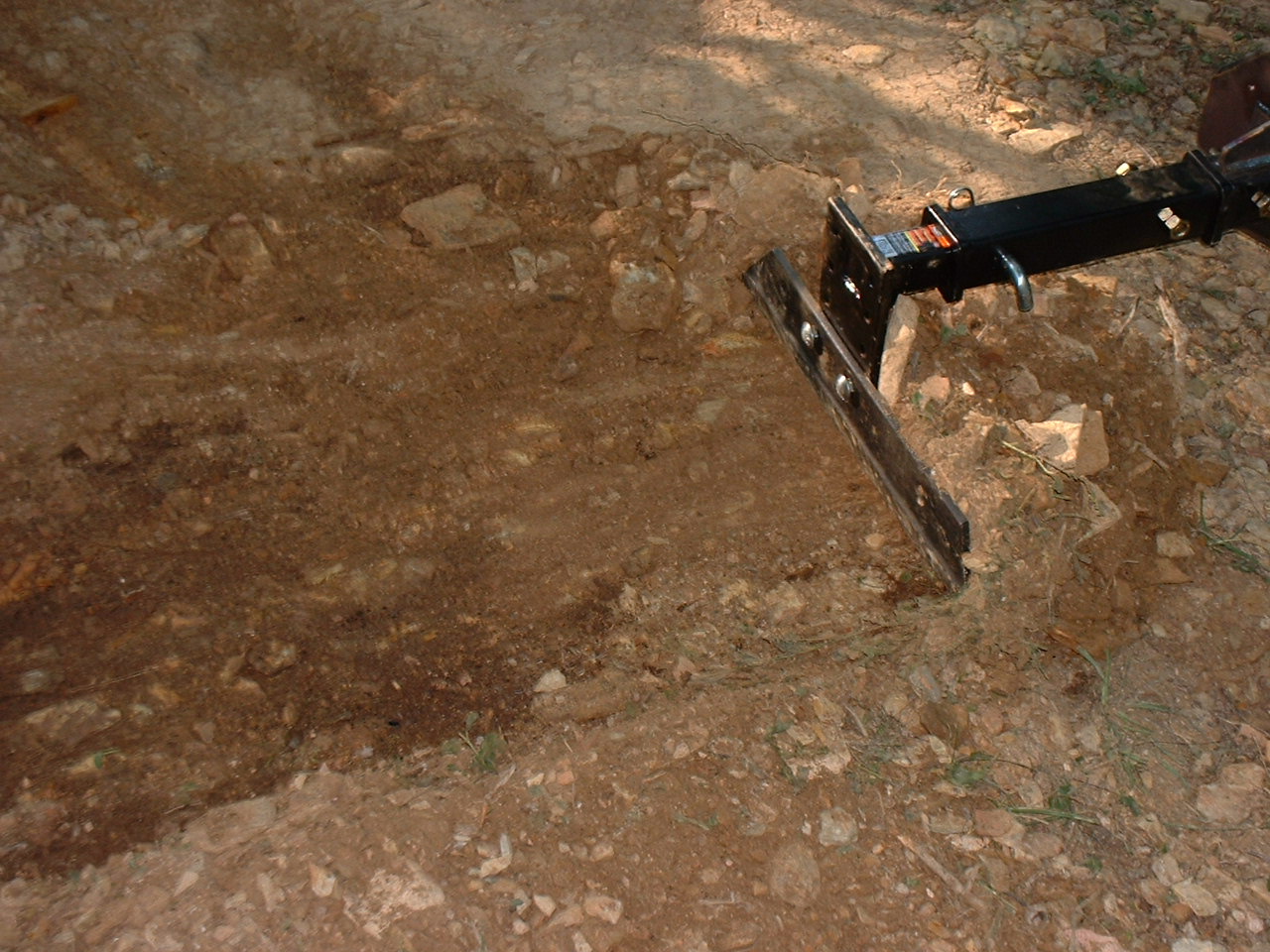

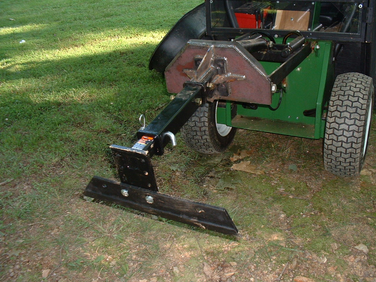

Here are a few of the Hoe/Scrapper moving dirt around. When it is attached as you can see. It makes it easy to use for picking up the rock bucket and moving it around the yard. :rolleyes:

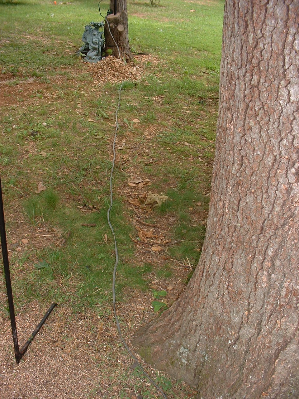

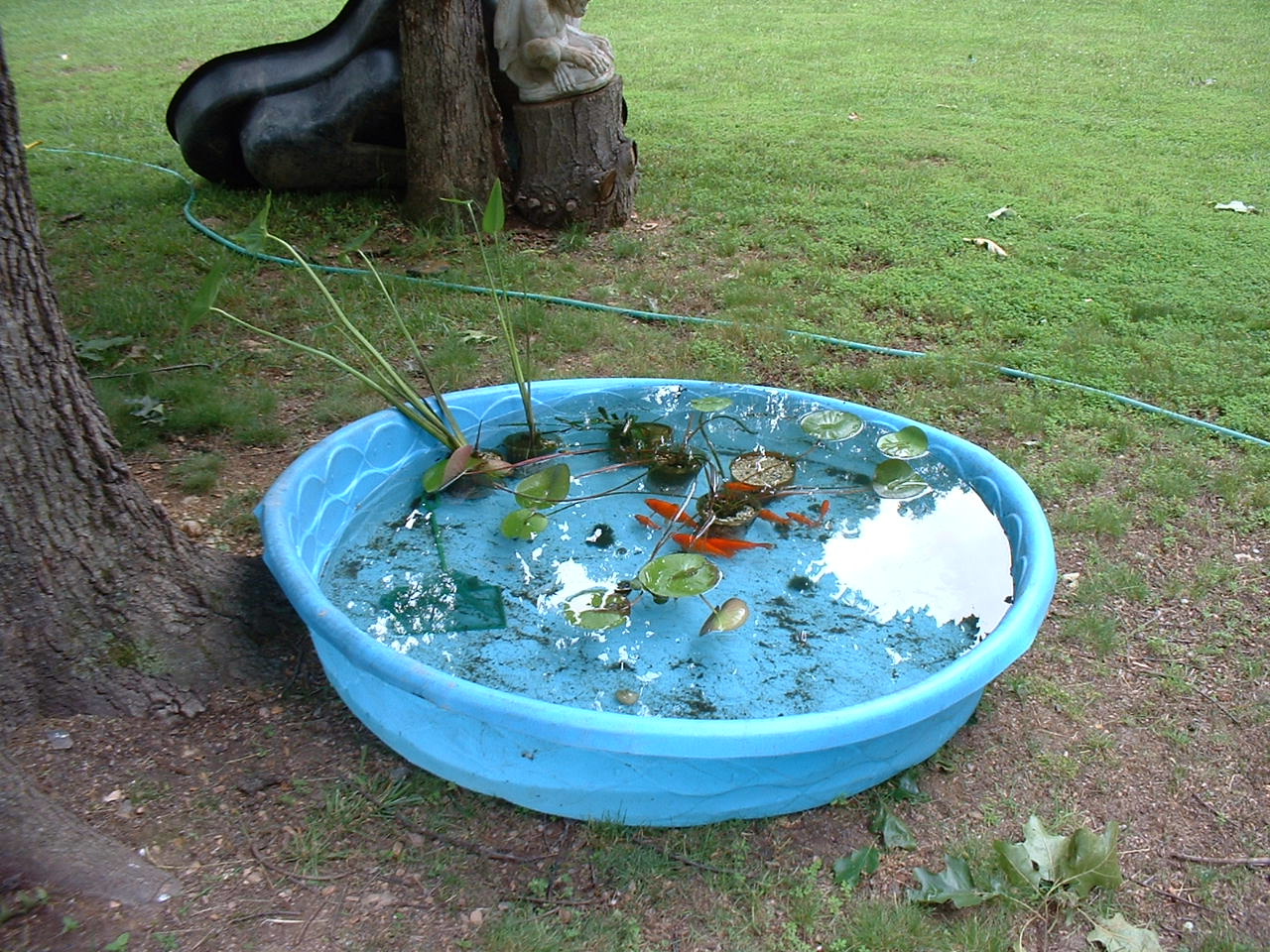

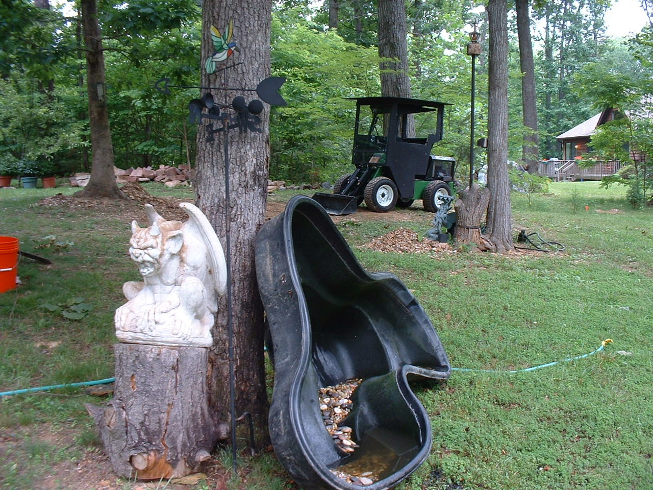

Here's my traumatized fish that survived the winter deep ice attack. The pond area that I'm working on, and the out door lamp wire that will have to be buried in the ground via the ripper. And the original pond liner.
