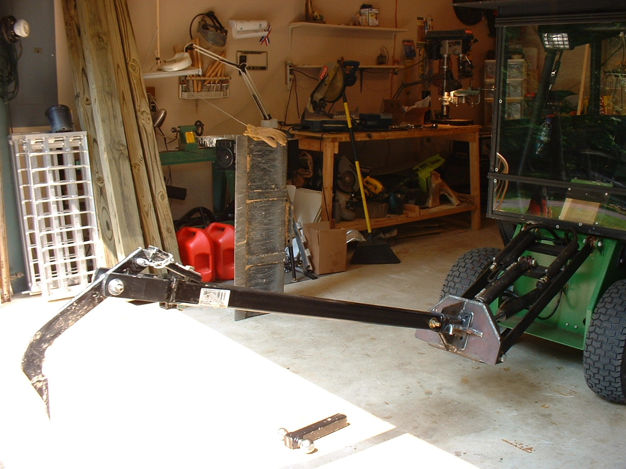

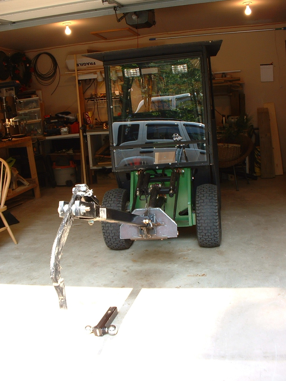

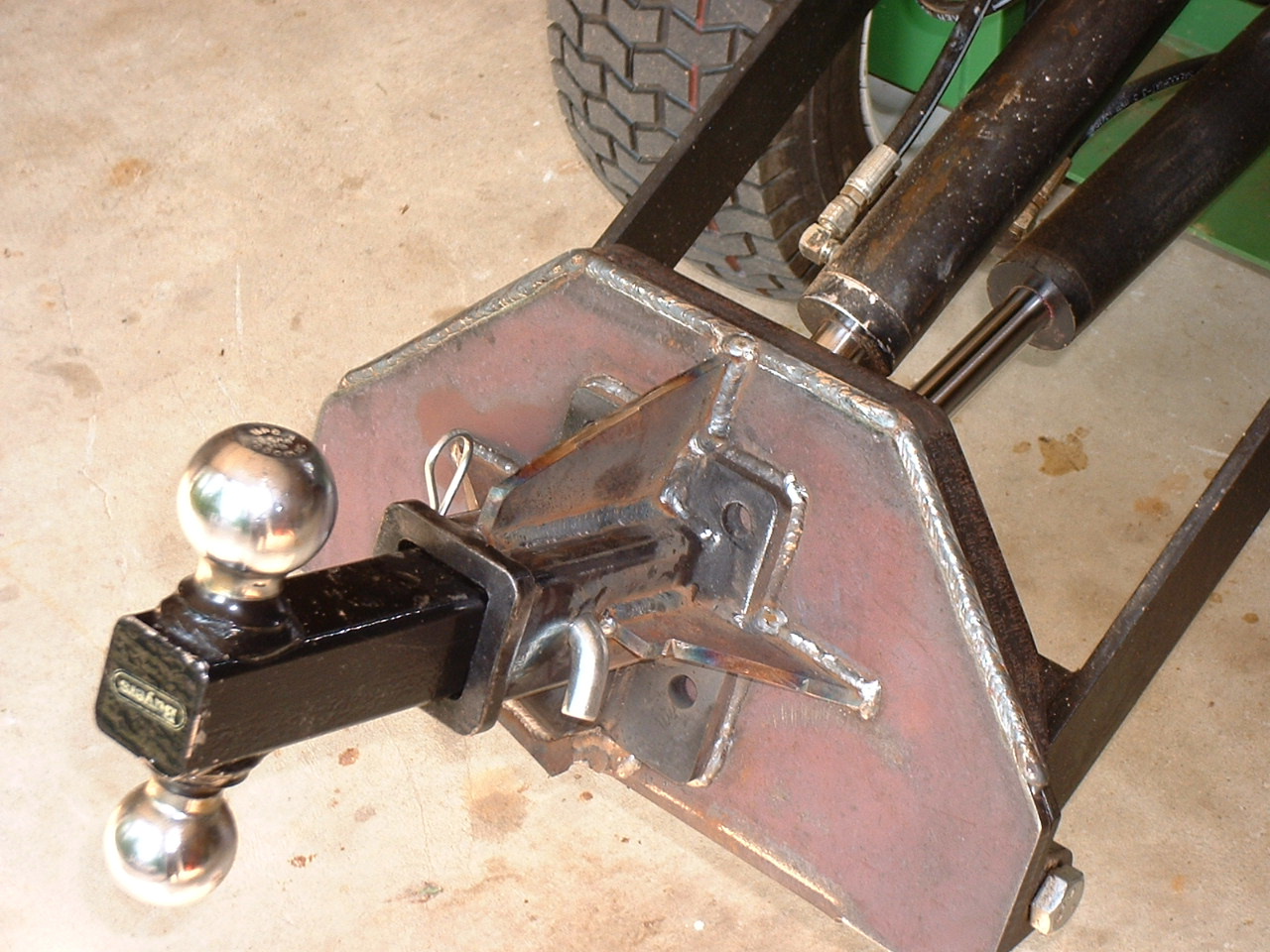

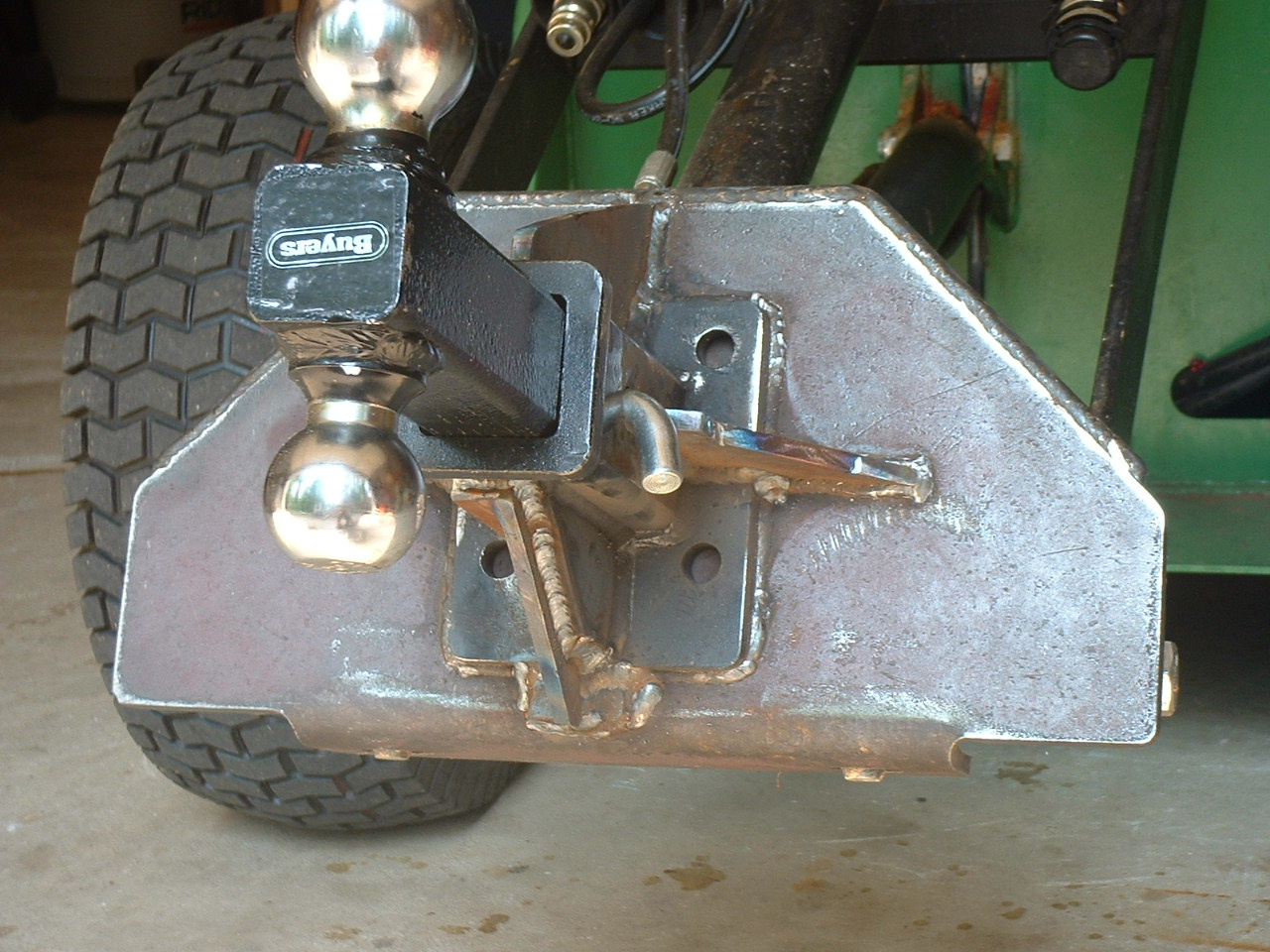

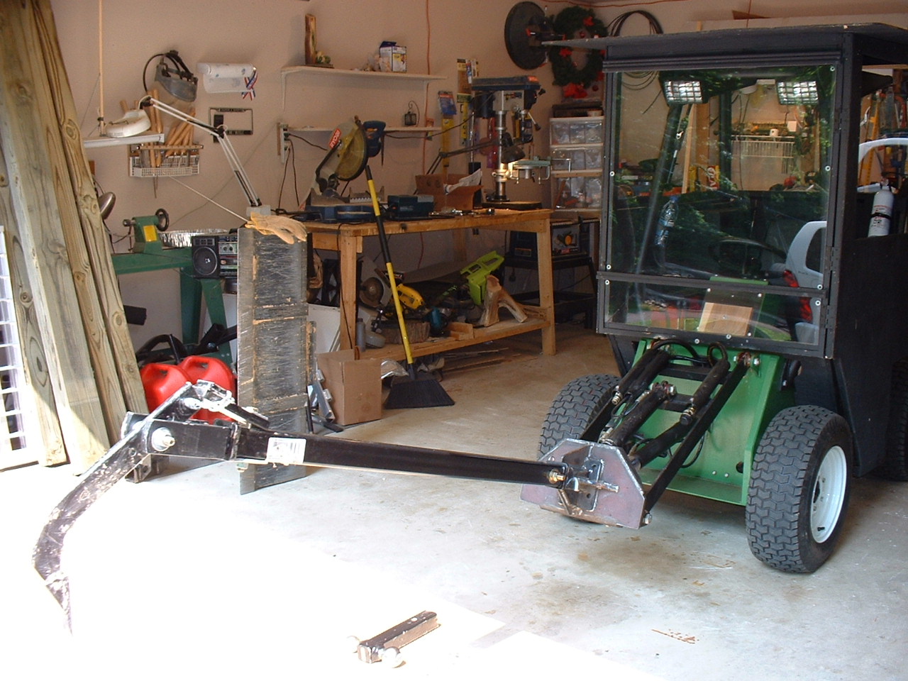

Ok got my welded receiver back today. Here is the start of my attachment collection. I’ve had this idea now for at least two years, and now just getting around to having the welding done. I think I have a few posts somewhere from last year, where I started trying these out. This is meant to help me around here not having a mini hoe. At least for now. The first as a ripper attachment for burying cable and making small trenches. The other is a hitch ,self explanatory I need this for maneuvering my 16 Foot 2400 lb trailer around the yard.
I had it welded and reinforced for extra strong hold. If I find I don’t pop any welds after using this with the extended shaft then in the end, I may try something crazy like welding on a cylinder and a small 8 inch bucket, which should help reduce the stress for starters using this 2- 1/2 x 2- 1/2 inch tubing. I may cut the shaft size down to around 3 1/2 foot I'll have to see how well it holds up.
If the stress / twist factors do not come into play then this will be my light duty mini hoe. I may even move up to a larger 12 inch bucket, if it works, and I find the for need one. I'll keep posting as I add to my little collection.:)

Nice tool!
Keep us posted on how well the hitch/ripper holds up.
