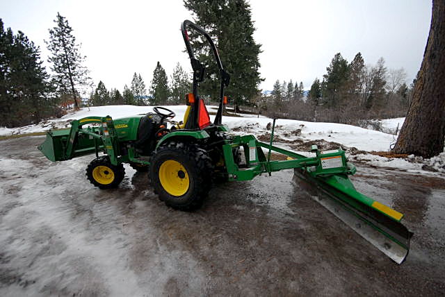

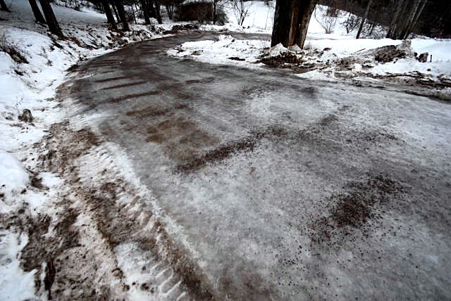

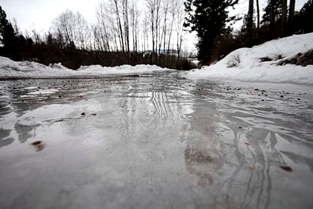

Well here it is this year. Seems we always get one or more events each year with icy conditions. I've tried it with regular chains and it made little difference. I then traded them and got some very heavy (expensive too) V-Bar chains that seem a little large too, but does the trick on this kind of ice. But, since I got them a couple years ago, I haven't used them since. Turns out that once I spread some gravel about, not only do I NOT need chains to get around, but neither do the vehicles that come up and down the drive! The 2520 with FEL and Rear blade works great for this...

That looks like central NY! You are right about the chains, unless the unit wearing them has enough weight to get the chains to go into the ice they are of no help. We have found turf tire to be better on ice then industrial or ag tires for traction!
On a grade like what you have when you start to slide the pucker factor can really get you!

Wow thats some serious ice conditions you have there ! Glad your able to handle it with your tractor setup that way ! I certainly cant argue with your success ! ;)

Looks relatively flat which may explain why you don't need chains so much! I found a massive difference on our Deere 4320 - can now use FEL uphill pushing snow whereas couldn't get up same hill without chains in greasy conditions. We do have R4's and no sand/gravel spread - of course if you spread enough grip material you don't need anything on the tires!
