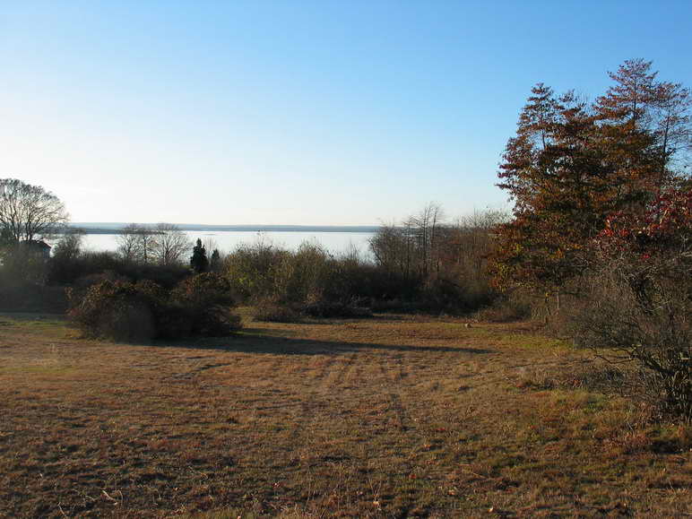

I am reclaiming an old meadow from years of benign neglect and lots of brush/briar/sapling overgrowth. I'd like to maintain the 4 acres or so as a low maintenance field and need advice on how best to go about it. I am close to being done with the clearing of brush etc and what is left is now patchy areas of sparce grass mixed with areas of weeds and new bramble shoots. I am saving some larger trees and blueberry bushes so this is not a true open field. The soil is rather sandy (result of poor farming practices by our colonial forefathers) and abutts a saltwater bay in Rhode Island. Photo attached of the land shows mowed area and now removed overgrowth in background.
How can I determine what the best land management practices would be? I don't want a lawn, just some healthy meadow grass that I can mow roughly twice a month during growing season to keep the tick population under control (Lyme disease issues here). The land is on an island so it is expensive to bring in manure or other organic fertilizers. What can I do to build up the soil gradually so the meadow grass is healthy enough to resist summer heat/dry conditions etc. What type of grass should I overseed with so I don't need to water etc like with a new lawn?

Nice view island tractor;
for land medo management have you tried the state DNR? I know mo has a pretty good one and I blive there is some good info availalbe on Ohio DNR and Virginai state DNR site too. I think Mich also has a fairly good one.
lots of prairy grasses like to be burnt off too. not sure about you're area but was a practice out in MO and KS when I was there. but are all controlled burns , we do them here some too. usually only once or twice in 10 yrs though and rough cut management 1~2 times a year. /forums/images/graemlins/wink.gif

Get some soil tests and add the appropriate ingredients. Then turn it under and work it till its all black and smooth. Then sow grass that is appropriate for your area and will fit in with your mowing plans. Do yearly soil tests and keep everything at the required levels.

The University of Rhode Island has a great turf management program. You should test the ph of your soil before you do anything.
Try this link http://www.uri.edu/ce/factsheets/sheets/soiltest.html
Samples go to UMASS as both colleges work together. You should try and find a grass that works well near salt water and slice and over seed once you have the correct ph. Salt over spray can kill grass real quickly. I spent 12 years working for a landscaper in Little Compton during high school and college.

Try your county extension office, too. They are very helpful here in Indiana.

Your state conservation department or department of natural resources should have informantion on how to return the area to its natural state. In MO the state will even reimburse part of the cost. I just planted 3 acres in prairie grass and wildflowers.

There will be many different opinions on seedbed preparation. Your DNR contacts may also be able to help on this.
I'm always on the cultivation side as there will be less competion for the new grass. It should also give you a smoother field which makes mowing more enjoyable.

If I were you I would wait a year or two before you do anything other than mow. You may be surprised at the results.
I reclaimed some old pasture land two years ago that had about 20-25 years of neglect - I sprayed some areas that have invasives with herbicide, but have found that the grass came back very nicely - haven't fertilized or limed either.
Mowing pature two times per motnh maybe too much in the hot season.
