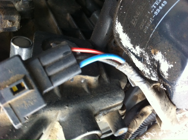

/ Mcormick starting issues
#28
Could you share the wiring diagram you got from the Winchester dealer. It might help me better understand what is going on.
If you have it in electronic form as a pdf file email it to me
david.petepiece@sympatico.ca
Most tractors have relays that are the same. Swapping those that are the same may suddenly show you which relay is not working properly.
Dave M7040
Hi Dave,
I only took a picture of the wiring diagram, but I will post it here, and\or email it to you.
